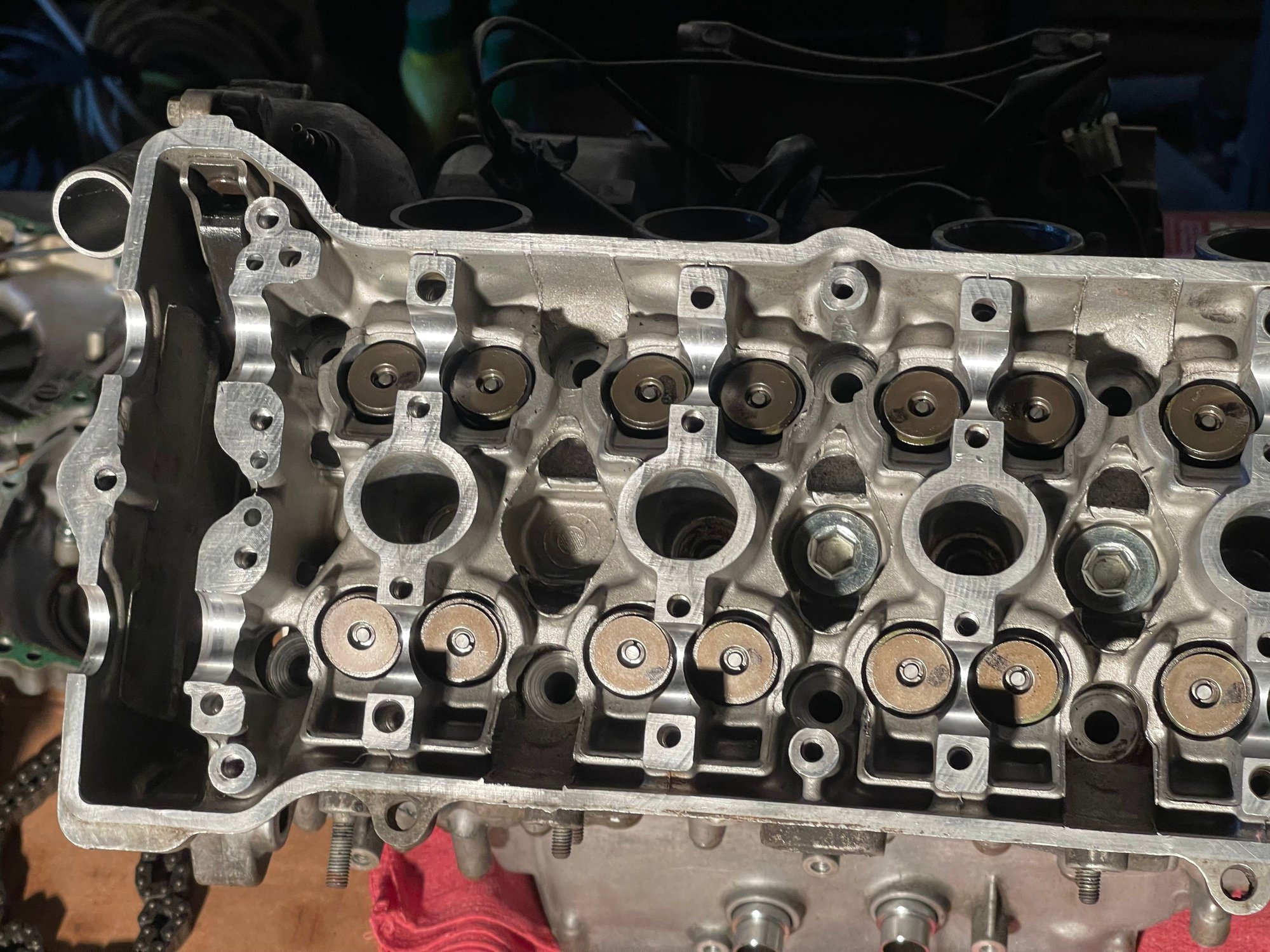

got the valves all put together and back in
Coming together nice

Didn’t mark which came from where so I got some work ahead of me. Time to buy a shim kit and feeler gauge.
Missing a shim
Missing a shim
Old Feb 7, 2025 | 06:04 PM
  #23
Posts: 7,177
They probably needed re-shim'd anyway. Nothing wrong with being proactive.

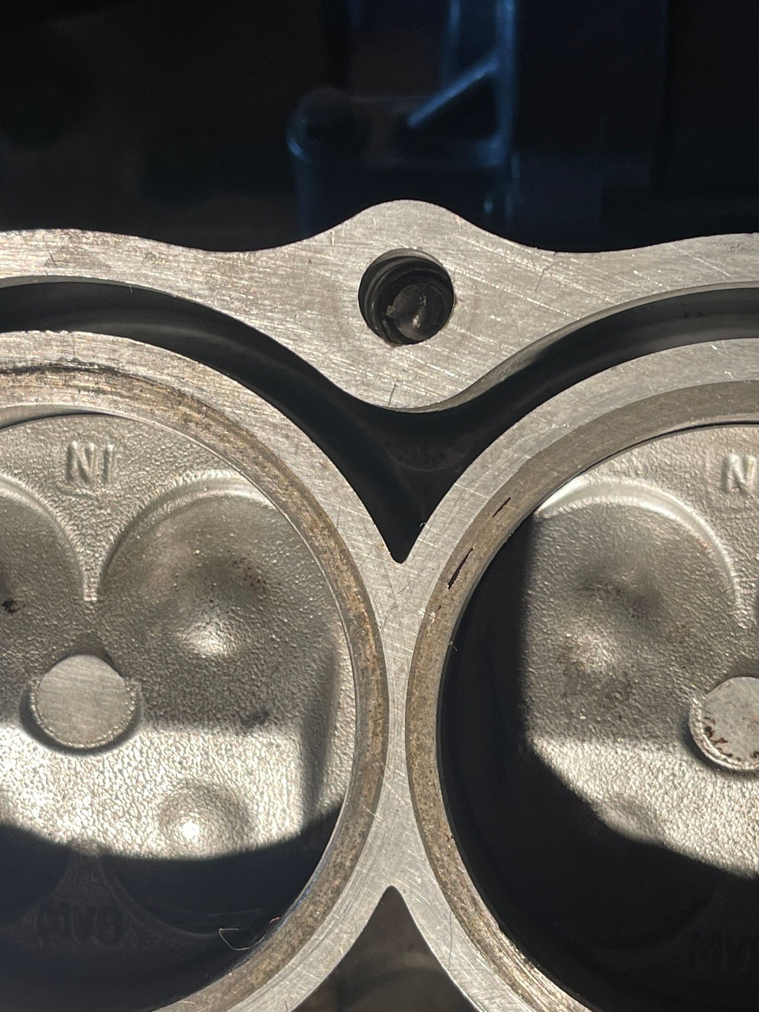

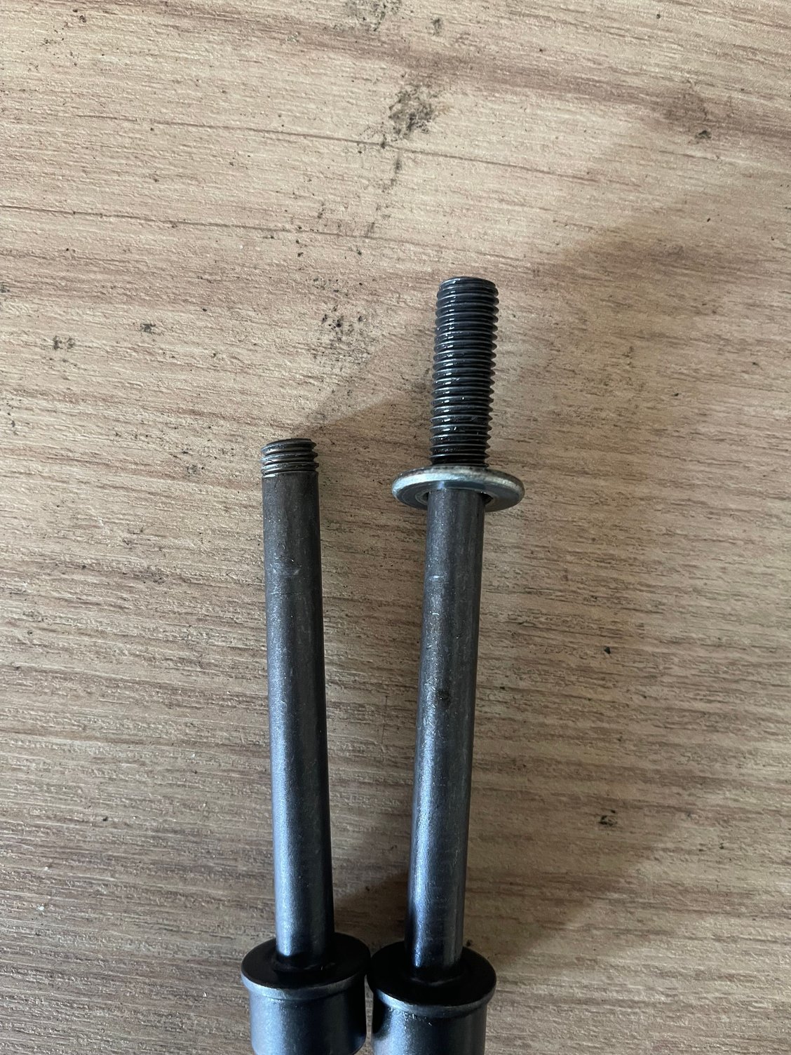

I over torqued down the head bolts and snapped two I
read the manual in a rush before work.
Why so deep
Why so deep
About an inch
About an inch

Got the broken bolts out and orders some different ones

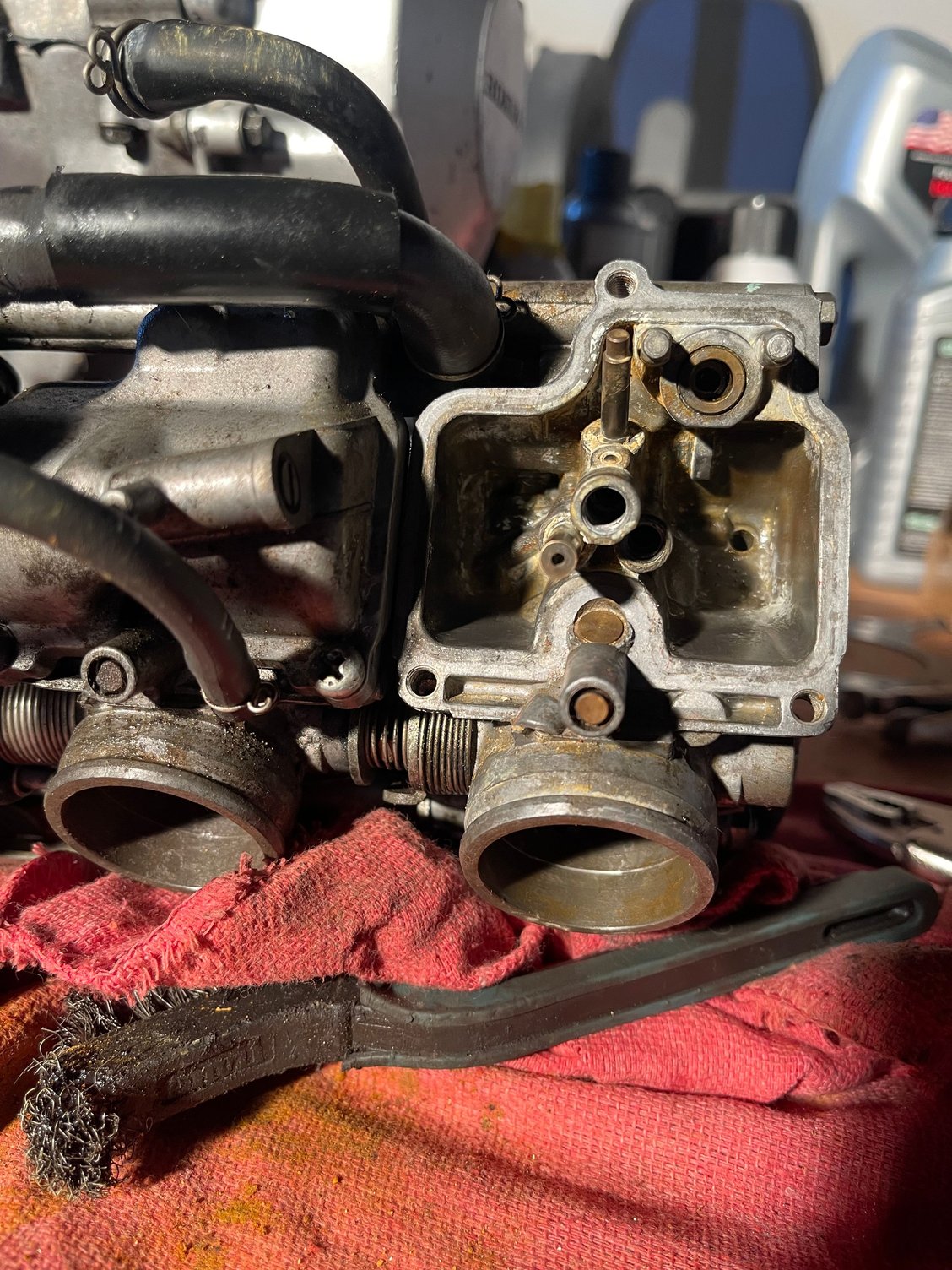

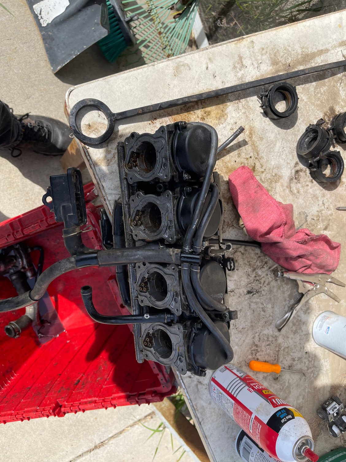

Since I’m waiting for the bolts to arrive I’ll see what I can do with this
Outside bad
Outside bad
Inside even worse
Inside even worse
Vomit
Vomit
Old Mar 13, 2025 | 04:55 PM
  #26
Posts: 2,568
Ohhh not good at all, well done getting the broken studs out.
The carbs will certainly take some TLC
Old Mar 16, 2025 | 08:55 AM
  #27
Posts: 7,177
Mmmm. That's some chunky stuff in those bowls. Makes a person want some chips and salsa.
They are bad, but not super terrible. Keep in mind that all the gunk that you can see, is also in places you can't. You have to be very mindful when cleaning them.

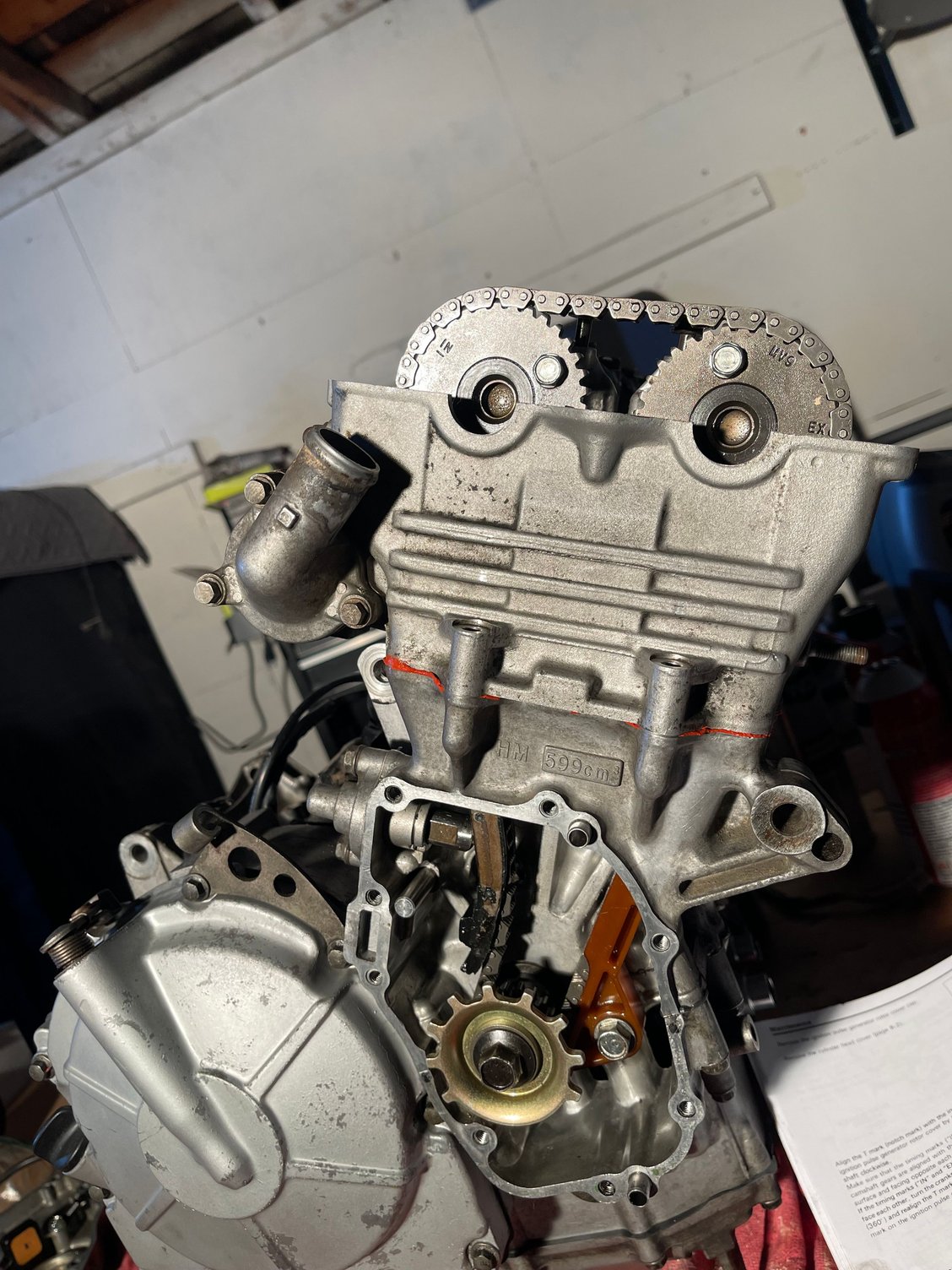

How do I time this? Doesn’t look like this in the manual

  #29
rockpool's Avatar
Joined: Apr 2015
Posts: 708
Likes: 187
From: Connecticut / Florida
https://cbrforum.com/forum/general-t...stment-154245/
