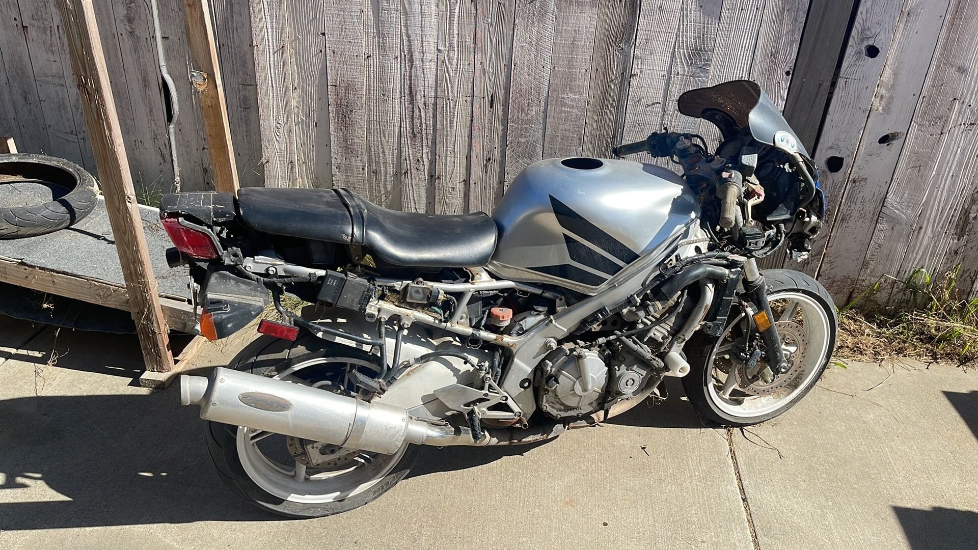

a little backstory
How I got the bike 2016
New fairings and windscreen after small slide
Added sliders
Added sliders
She was perfect

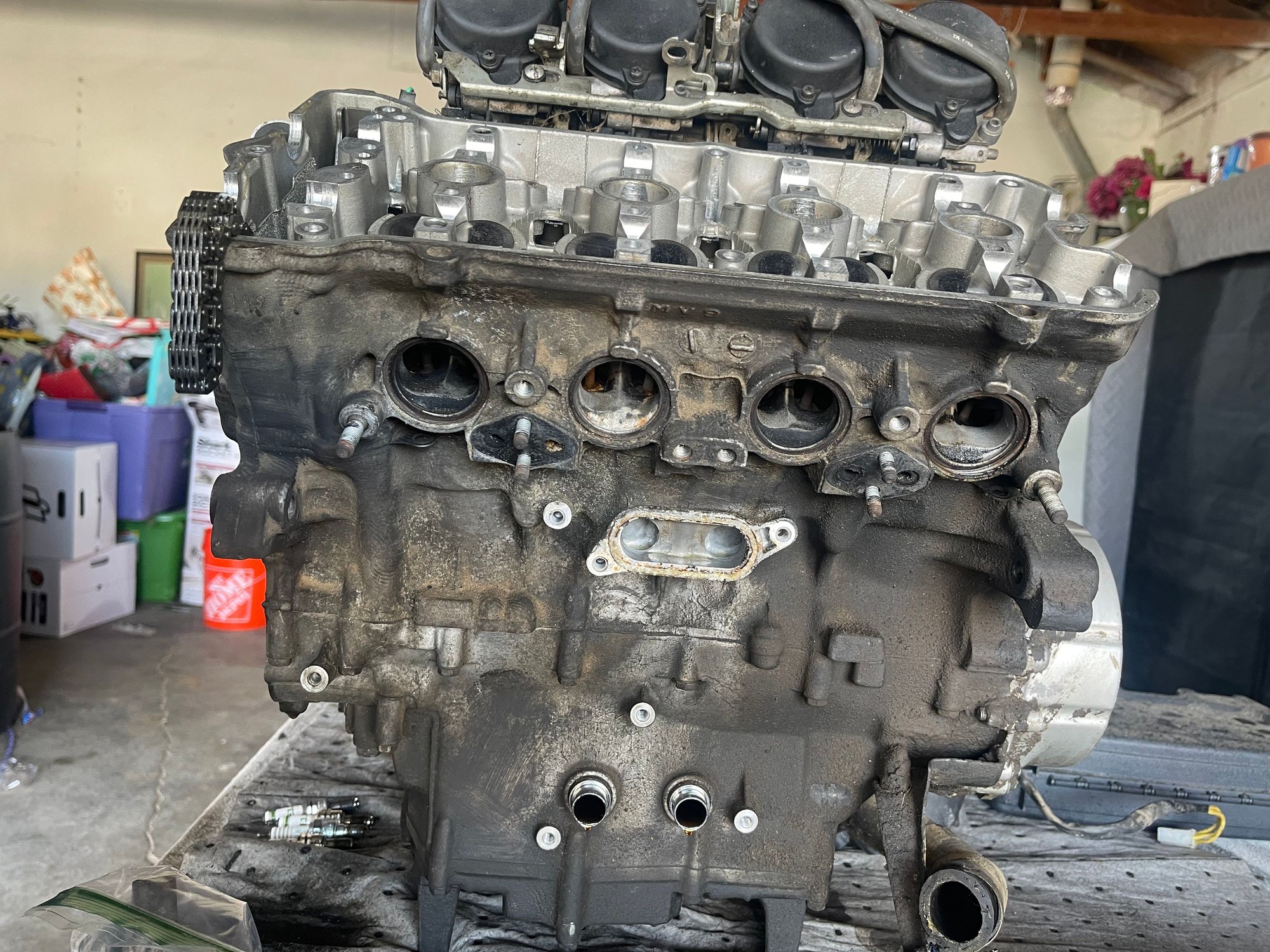

Dropped the engine.
Dropped the engine.

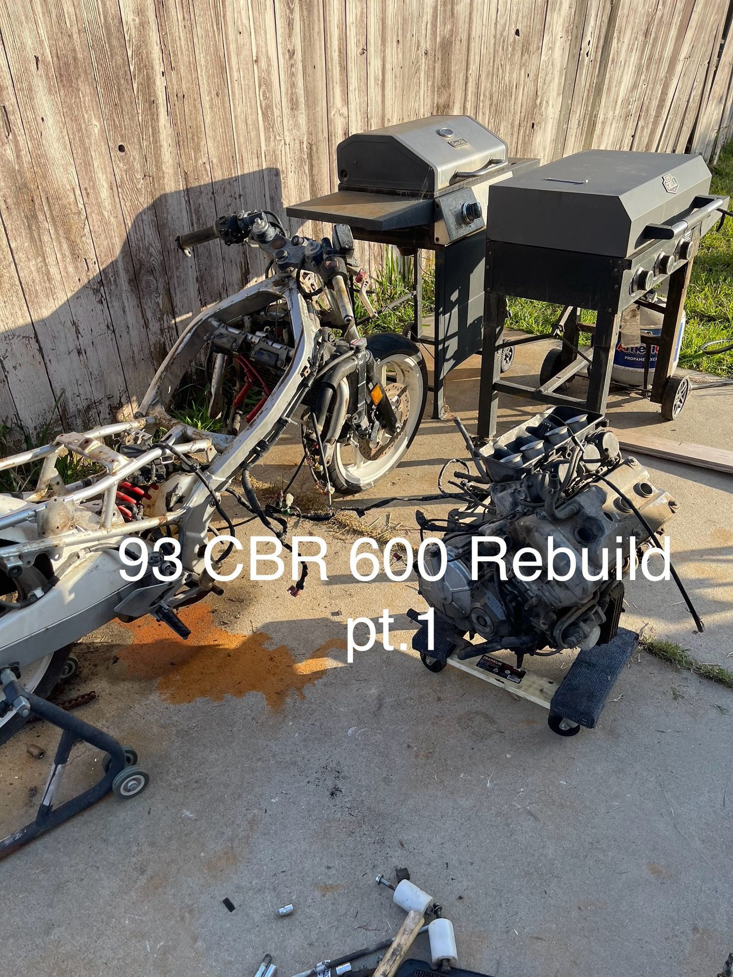

Quick peak under
Quick peak under
Time to disassemble.

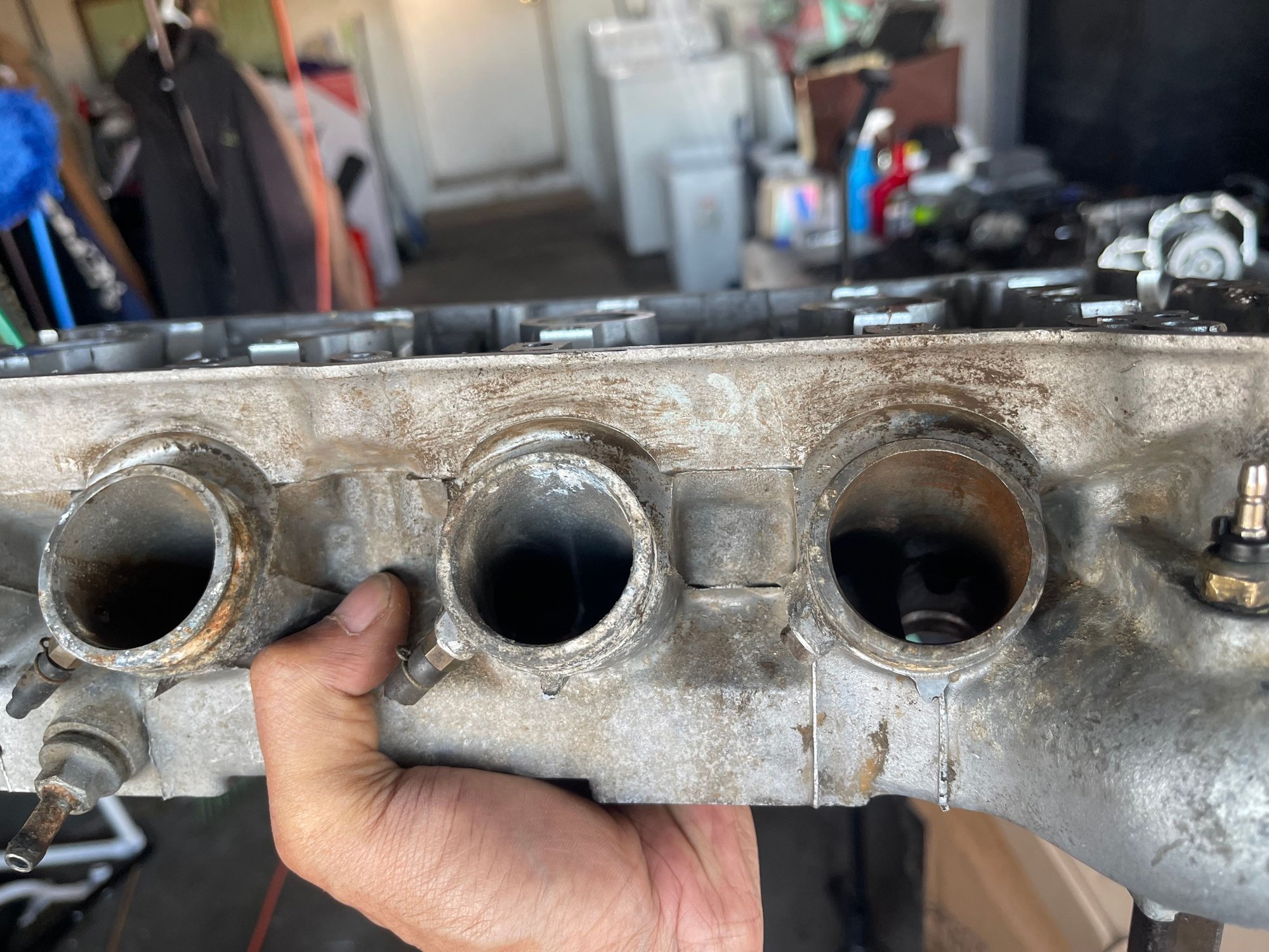

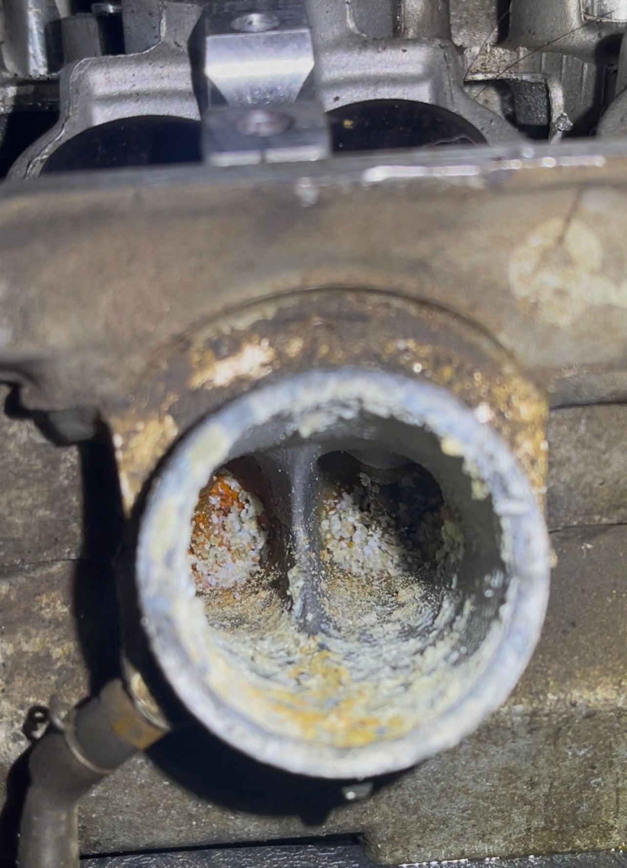

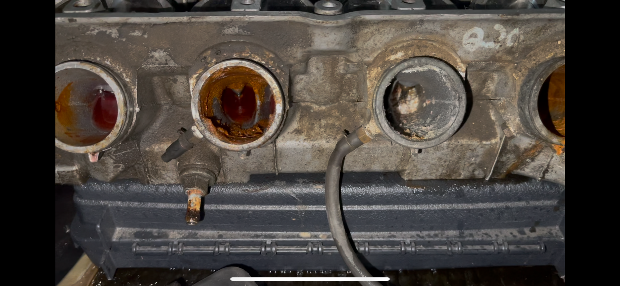

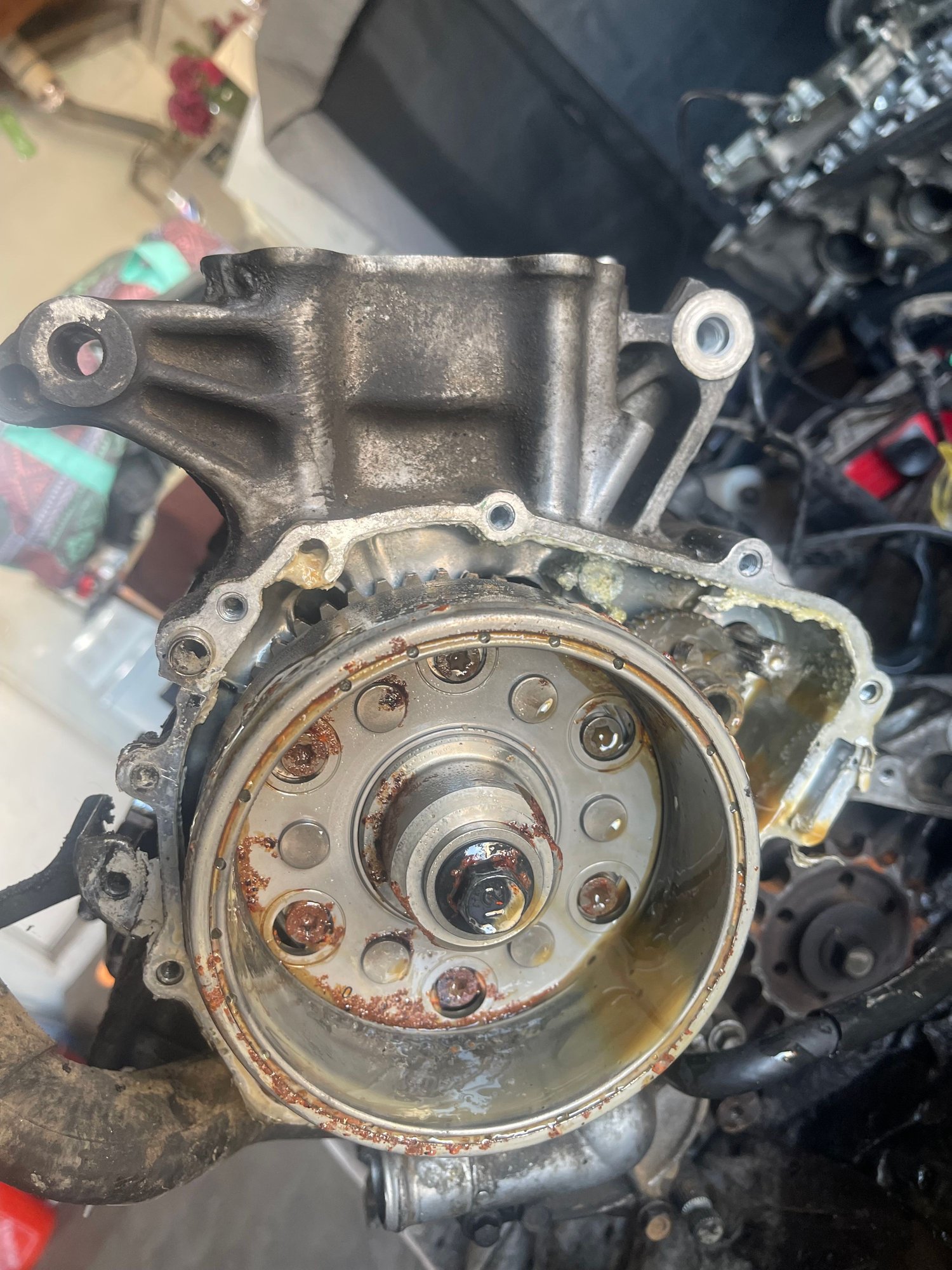

Rust!
Rust!
After some wire brush
Marvels mystery and some brushing.
It’s everywhere.
It’s everywhere.

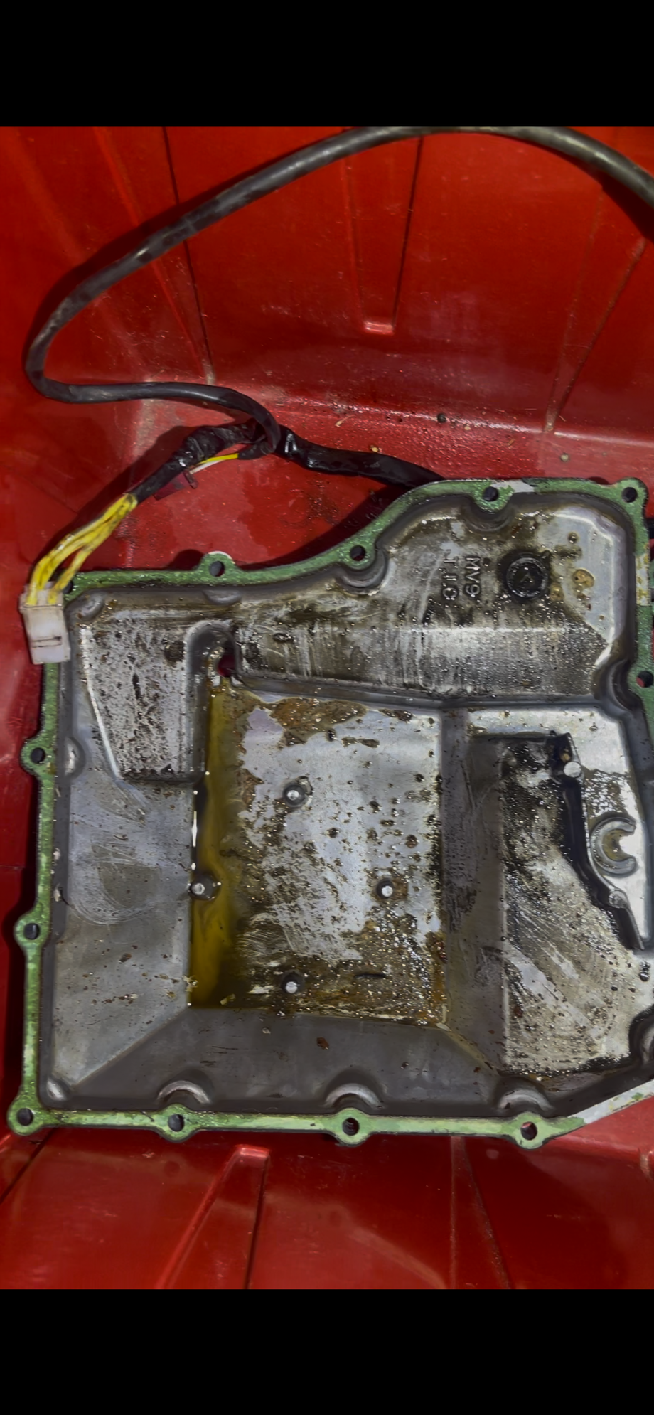

Oil pan
Oil pan

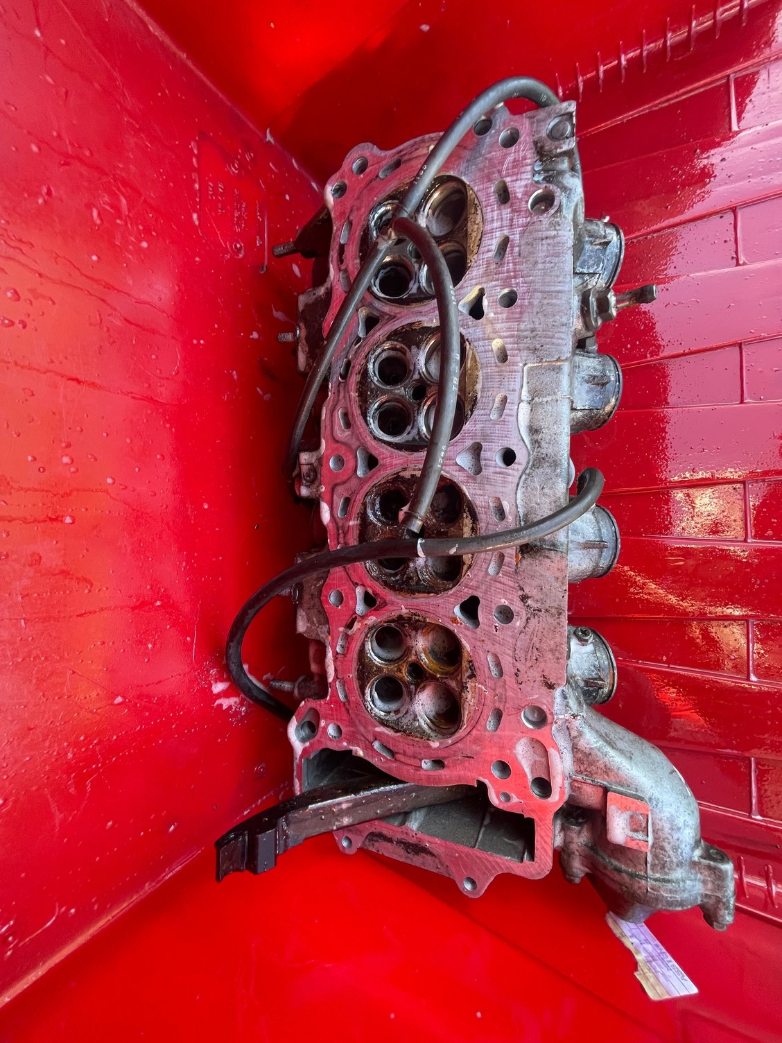

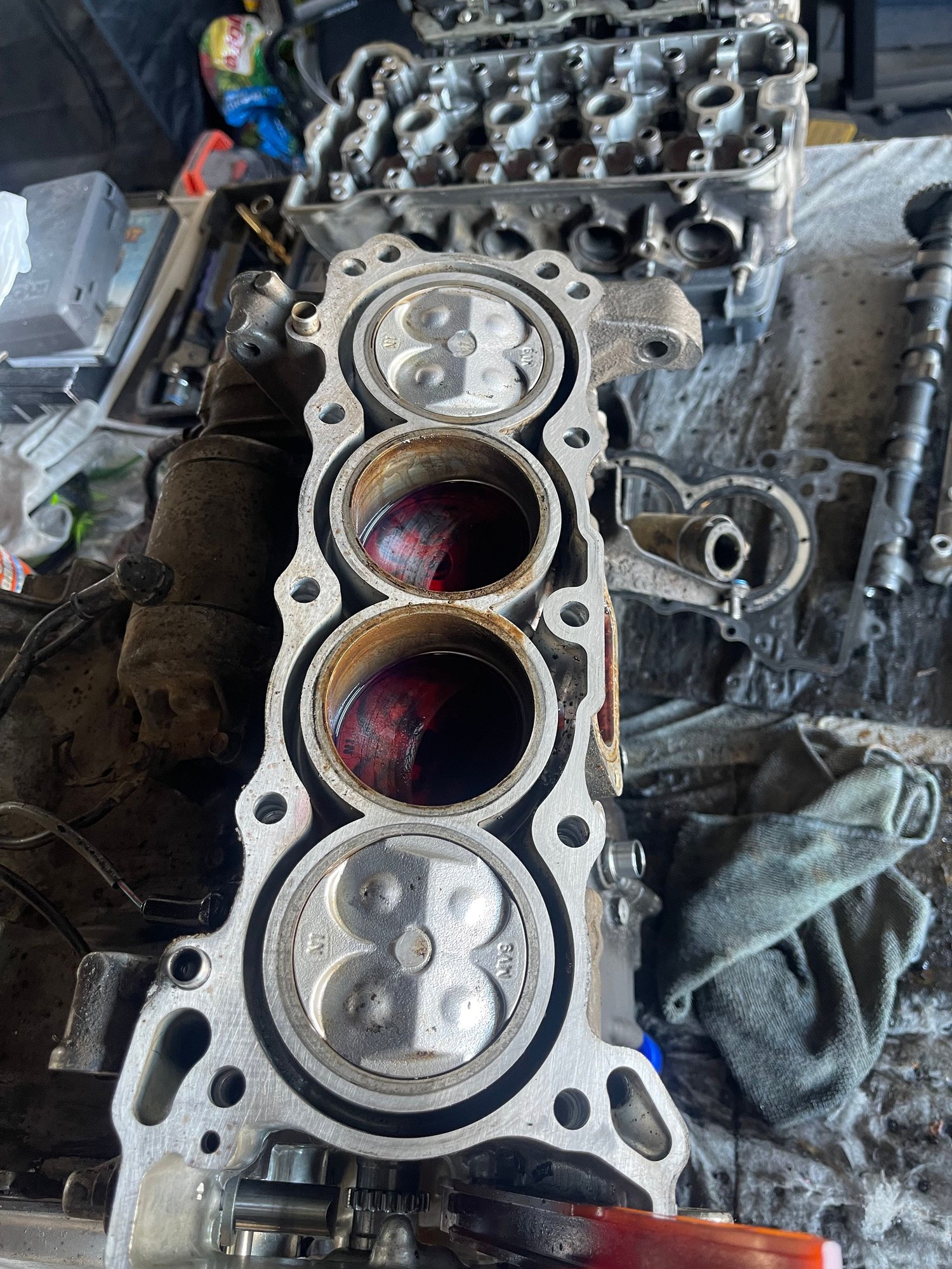

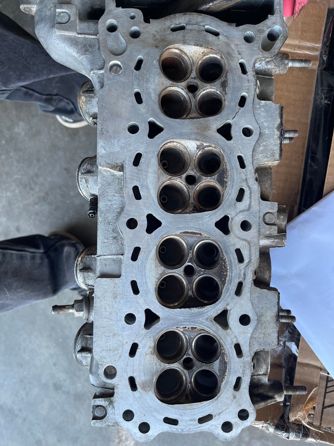

Almost all apart
Almost all apart

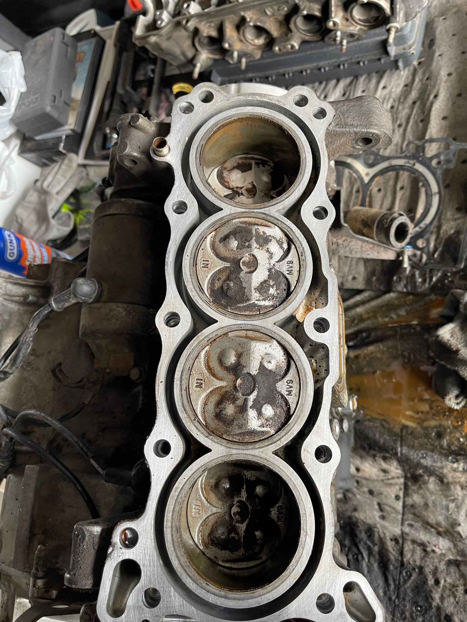

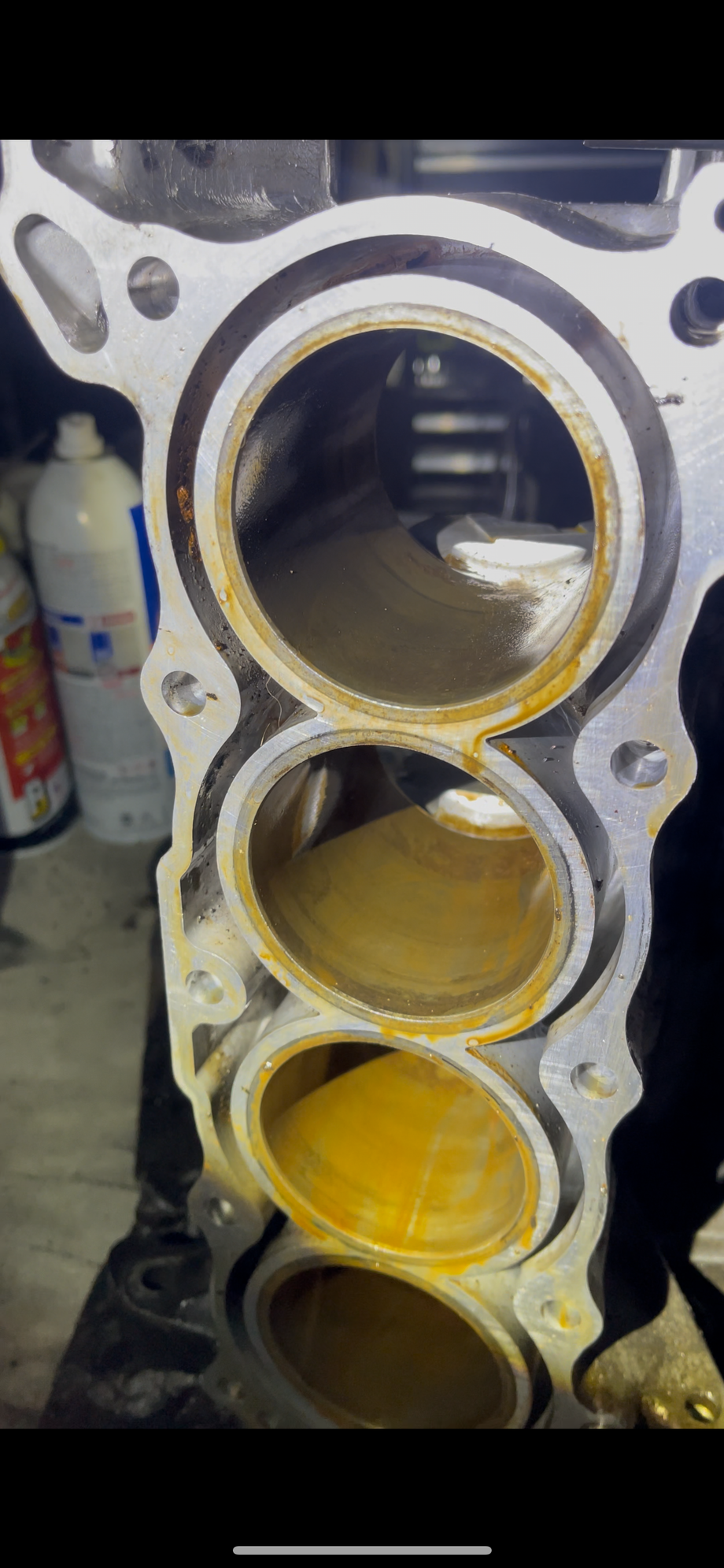

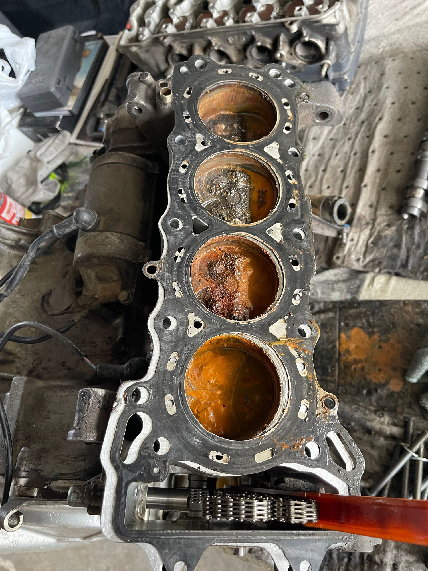

Cylinder
Cylinders

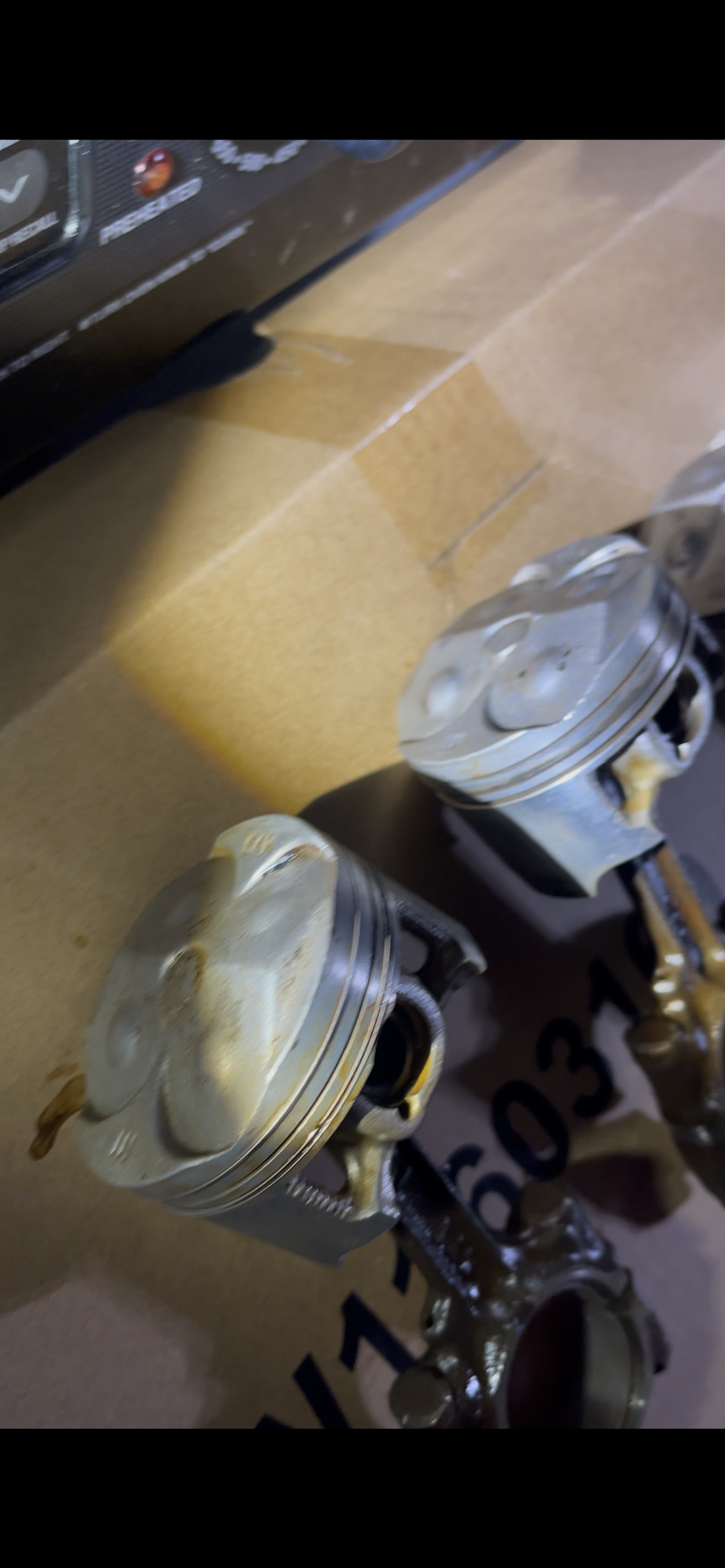

Pistons clean up a bit
Still see rust
Still see rust

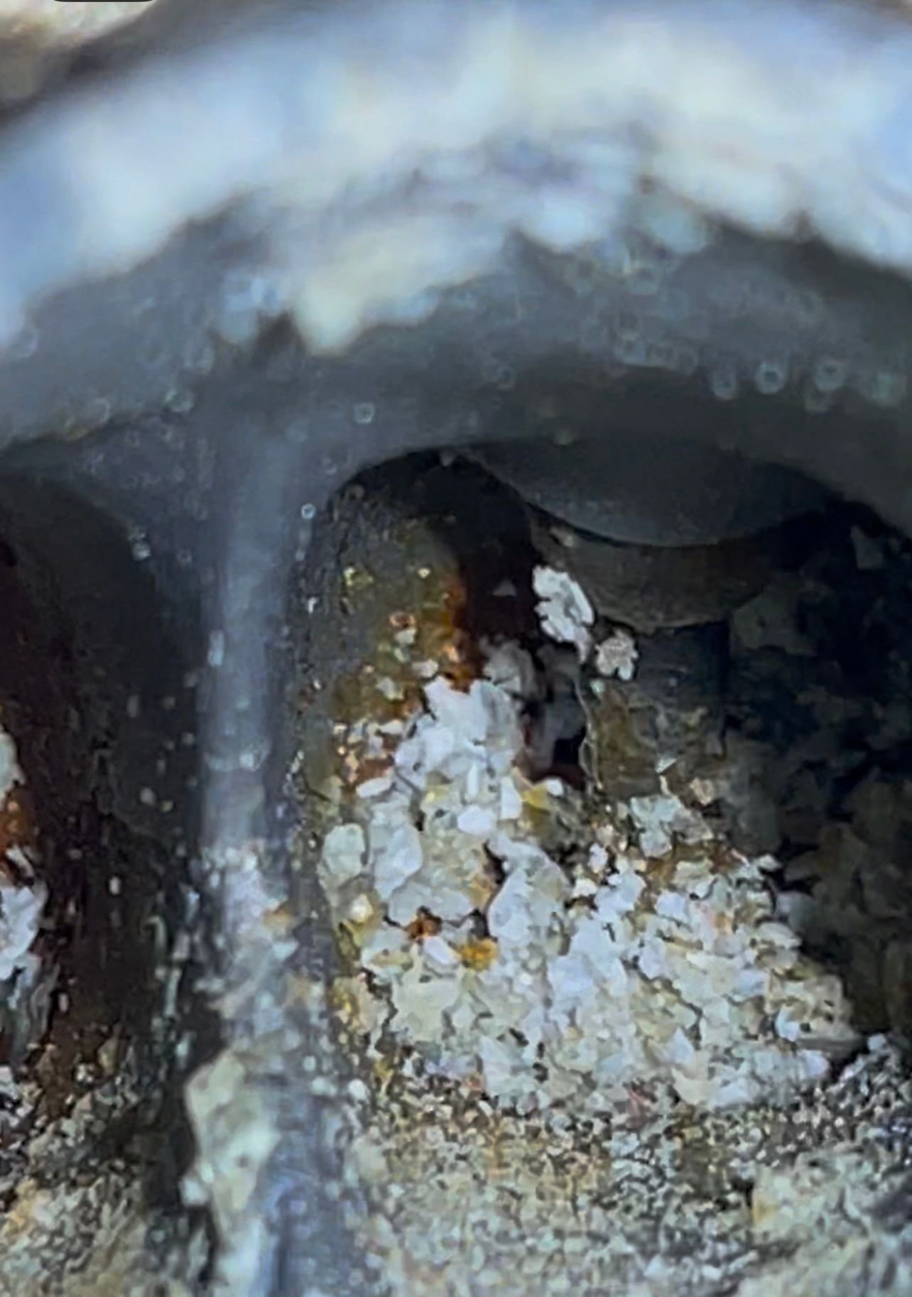

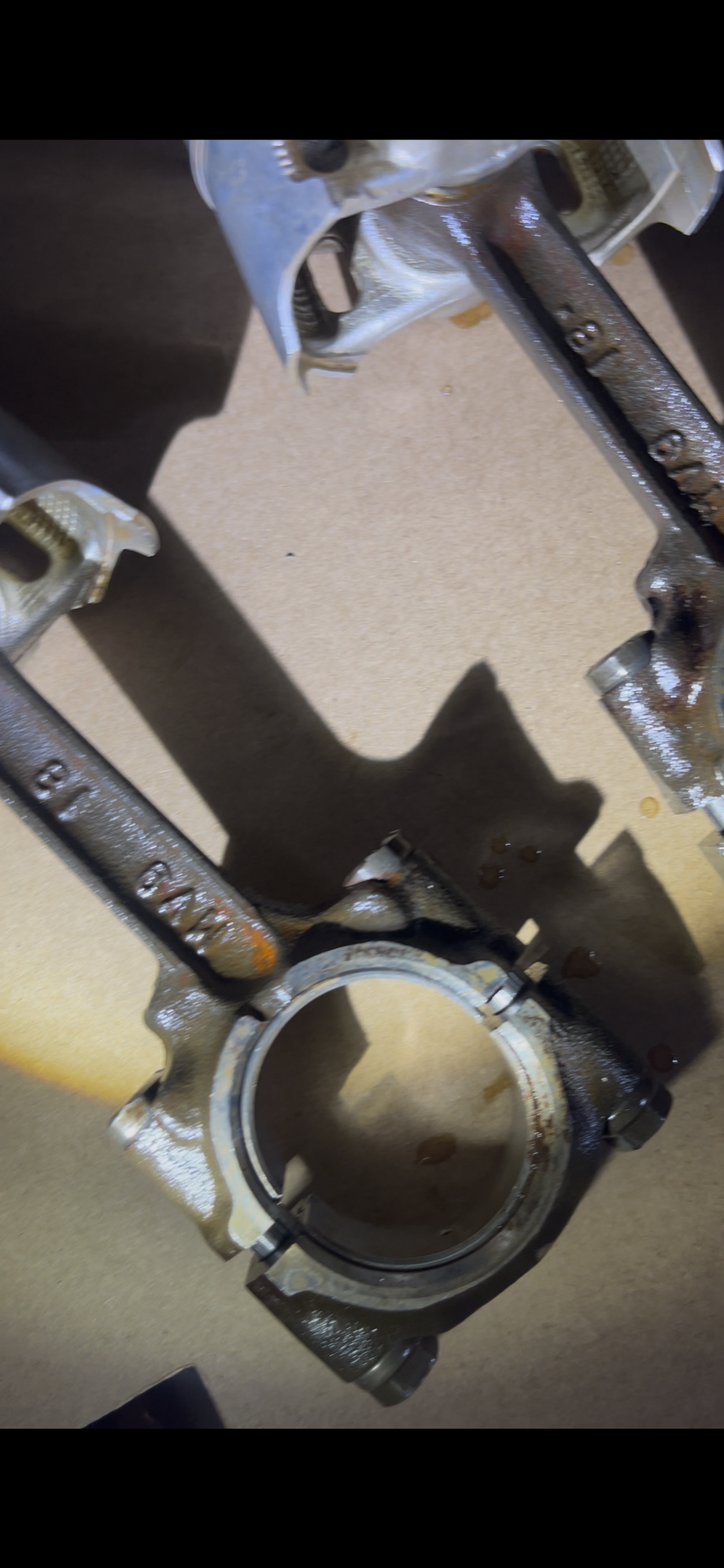

This is where my nightmares begin.
What even is that
What even is that
I need a chisel.
I need a chisel.

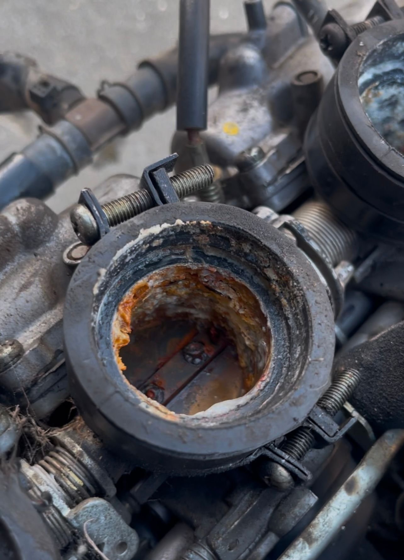

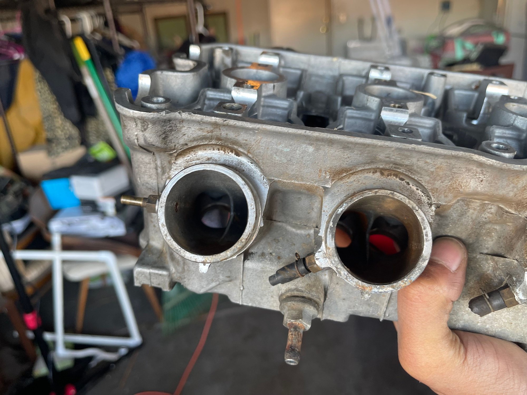

Carbs are even worse

You’re a braver man than I am, that looks to be a huge amount of work.
What caused the engine to blow up ticking over?
I was warming it up after work, left the idle a little too high but then went back inside to grab something I forgot, got stuck in a conversation a bit too long and when I came out the coolant tank was cracked and leaking everywhere. It was a sad day.
Ouch, I guess that the fan failed?

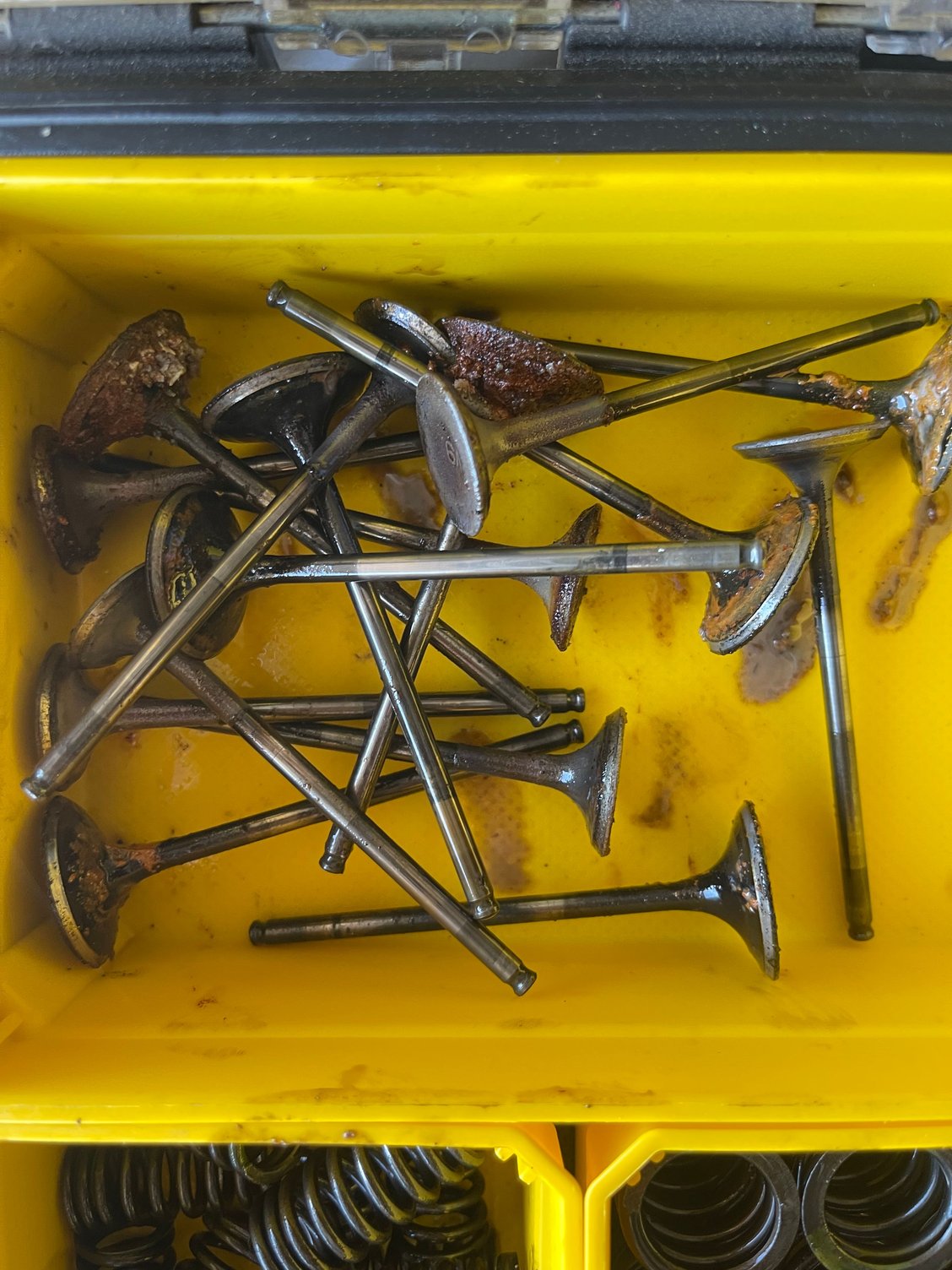

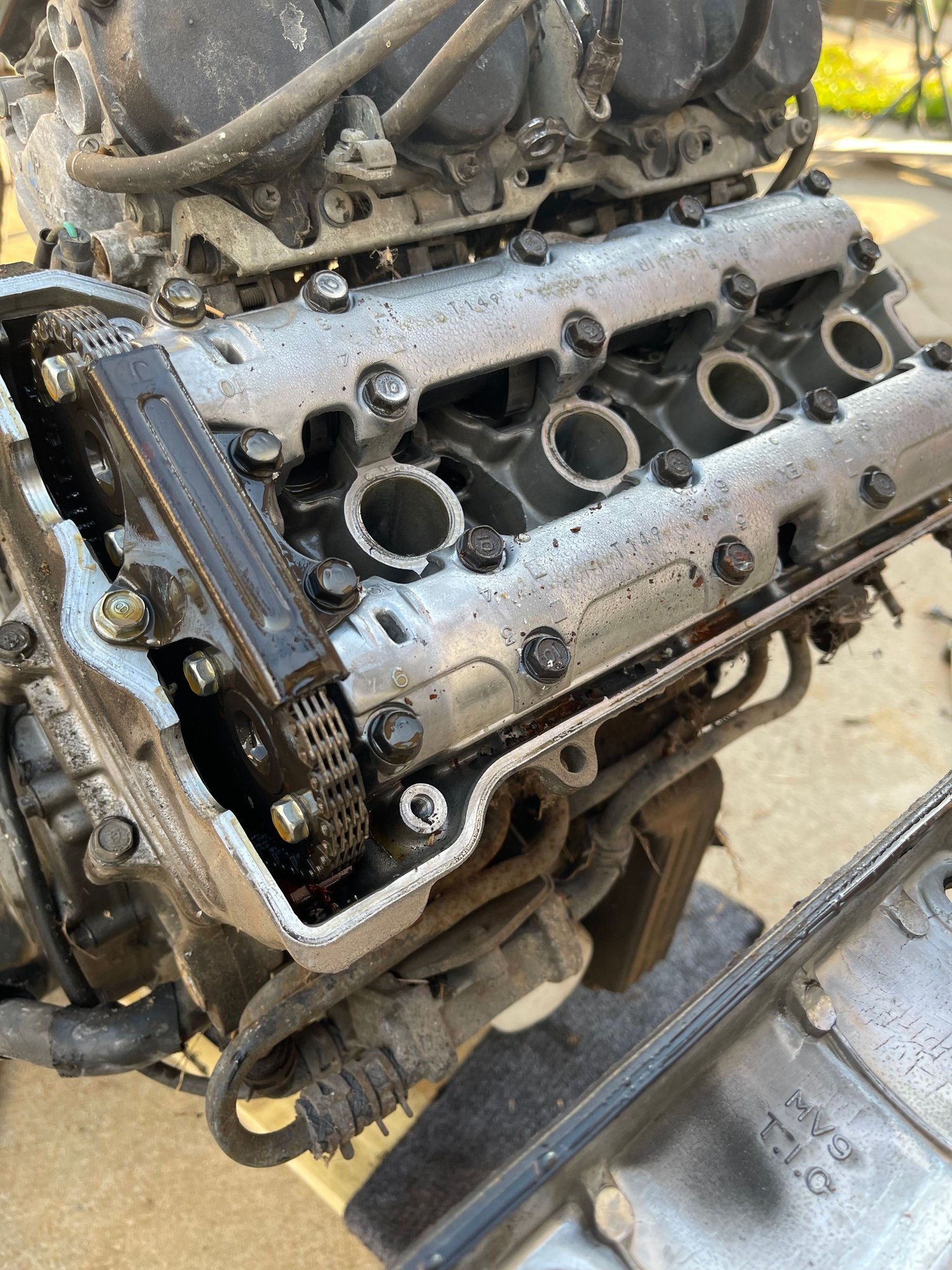

Valves are removed
Valves are removed
Gotta clean these valves
Old Dec 19, 2024 | 08:19 PM
MrEmale's Avatar
Joined: Jul 2017
Posts: 15
Likes: 9
CRc parts cleaner and wire brush
Not terrible
Not terrible
Needs more work
I need to soak this I think
