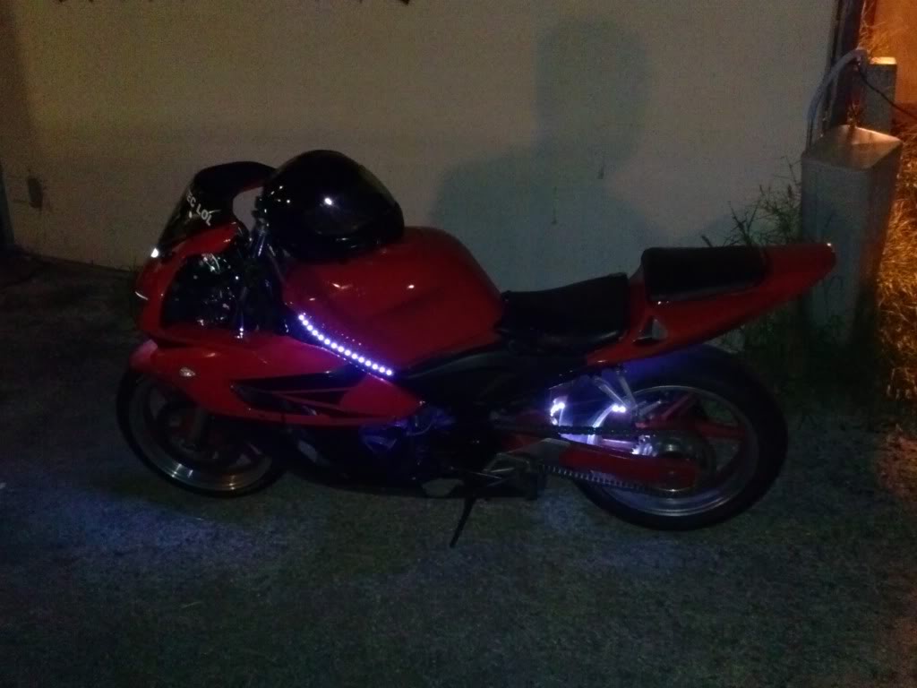

Not necessarily going wider tire because of the nose popping up, more of a 190 or 200 tire rather than a 170, also because of the cost of the extensions for the f2 are at the same price of a rr swing arm with extensions and wheel. Though I kind of like this simple swingarm design the f2 has, not the wide on one side and open on the other like the rr.
Nightshot of my bike, red tail and tank, will snap a better picture soon.

Old Oct 8, 2013 | 08:01 AM
  #140
JNSRacing's Avatar
Welcome Crew and ROTY 2014
Joined: Dec 2010
Posts: 2,059
From: Kansas
Nice... anxious to see the new red pieces in the daylight!
