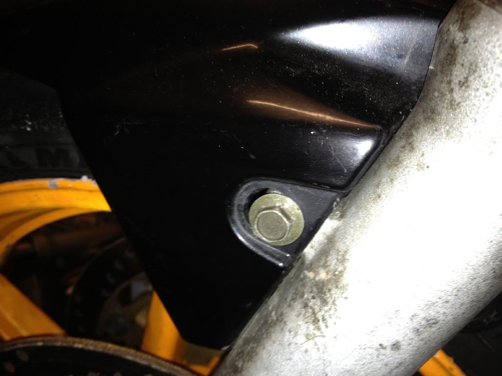

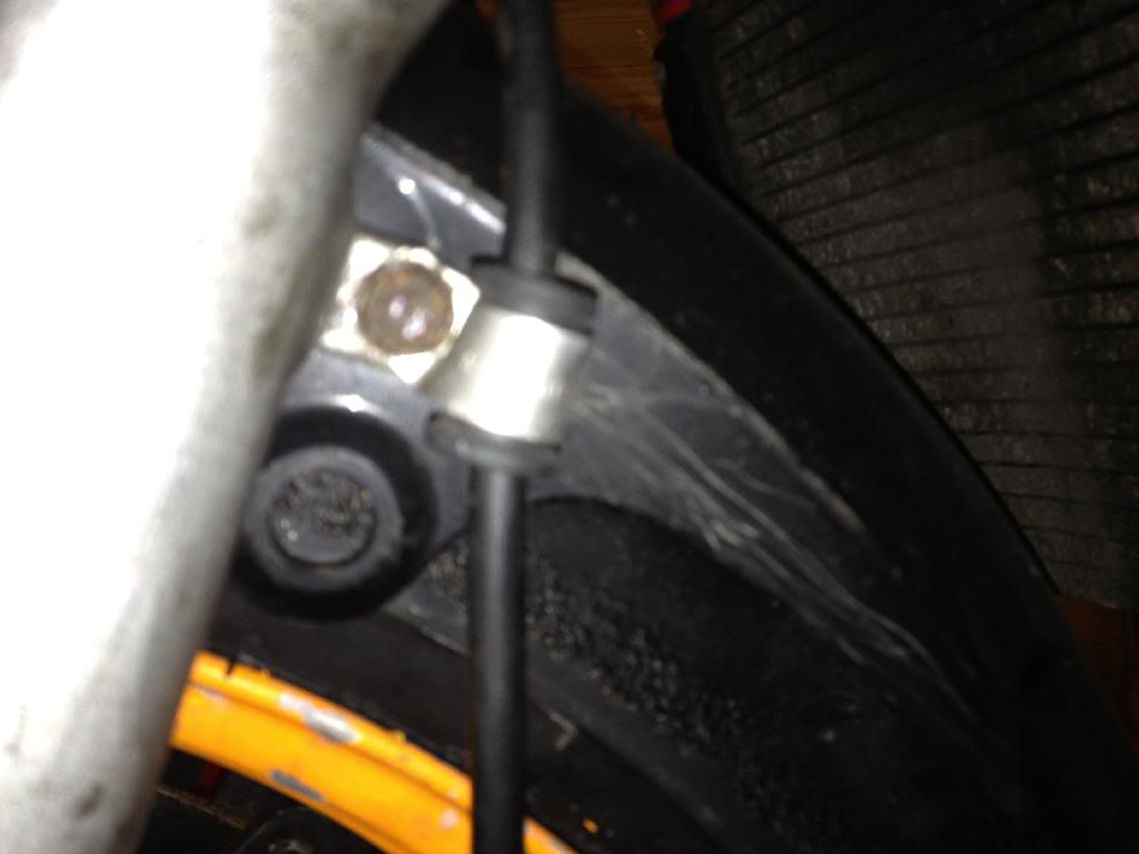

looks like the old man didnt like cable ties and has drilled new holes dont know what he did for the back nut but i personally would use an epoxy resin to hold a nut onto the back after all it cant be seen
front-

back- very close up picture also remember race bike it is stripped and rebuilt quickly so things get scratched if you took the time and care it wouldn't get scratched.
Yeah, that's exactly what I would do, and it's what I did with both of the latest fenders I installed, on each of the bikes.
I would probably, no, definitely, patch the Yam fender's rear mounting holes with fiberlass, and of course, sand and paint, and then glass in a couple of the square nuts Honda uses on the inside of the rear mounts for the fenders... like what I did on the F3 fender on the race bike:
