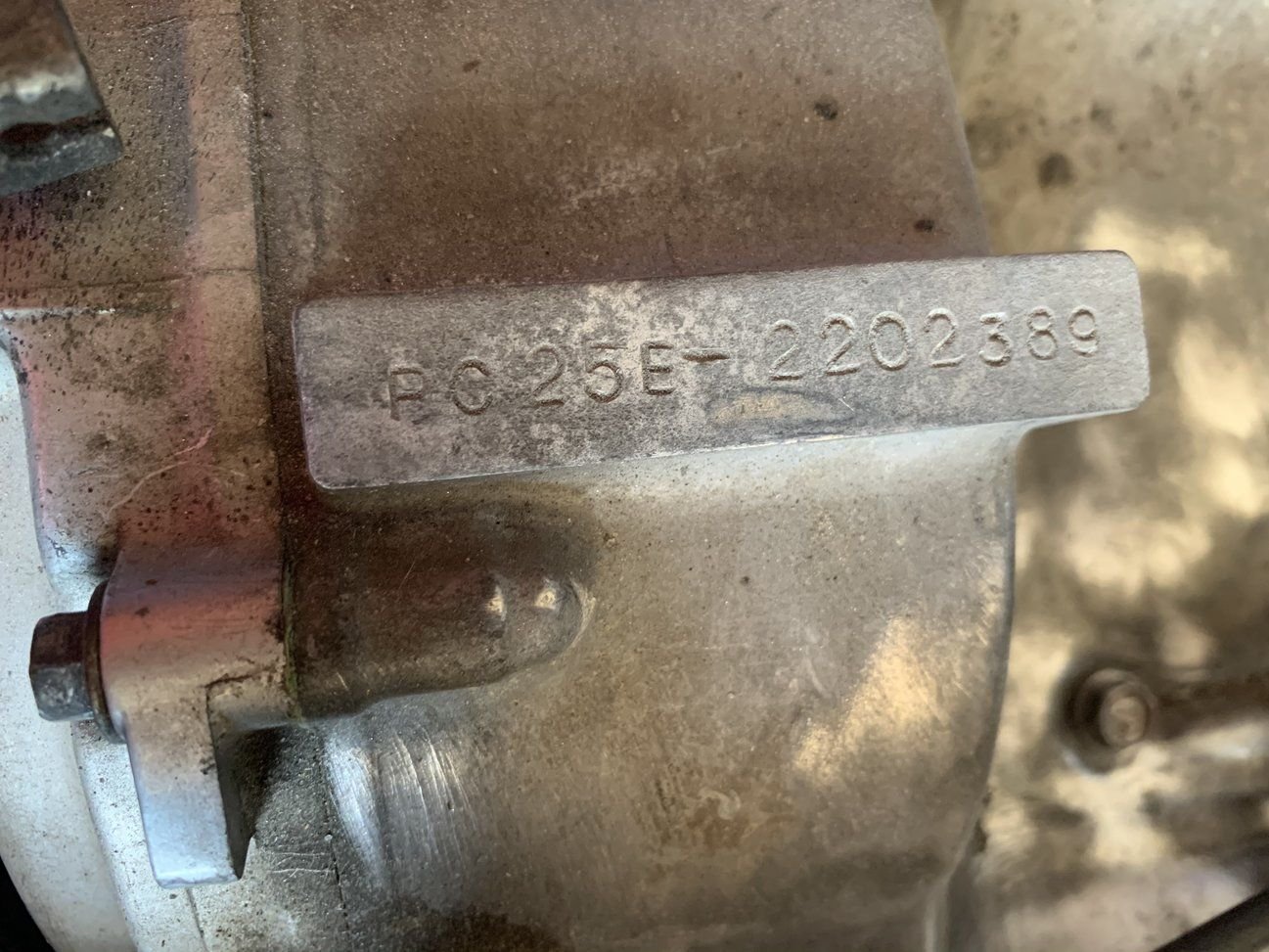

Originally Posted by phil314
my 95 frame is stamped jh2pc2504sm******
my 94 is stamped jh2pc2500rm******
and yours is stamped jh2pc250*pm******?
jh2pc2521pm******
Old Feb 18, 2021 | 10:50 PM
  #32
I'm in agreement with Phil314 here. I think that engine with the funky serial number is an F3 motor. I would not have believed it if I hadn't kept looking at it. I've taken the liberty of putting your photo's next to one I stole (barrowed) from an online auction service. It's a motor from a 94 F2. But the design, font, and layout of the serial is the same from year to year. This is Honda we're talking about. There is no way an engine came out of their factory with that serial number looking like that.
Now, as for the F2 head on the F3, I have no idea. I think I'd look for an F3 head myself.
Clear font, E is precise, zero's have breaks at top and bottom
The #5 has a large bottom circle, the top right of the 3 is pointed, the zero is O (uppercase oh) shaped and no splits.
The tops of the 3's are curved, the bottom of the 5 is small relative to the top, and the zero has the breaks at the top and bottom
