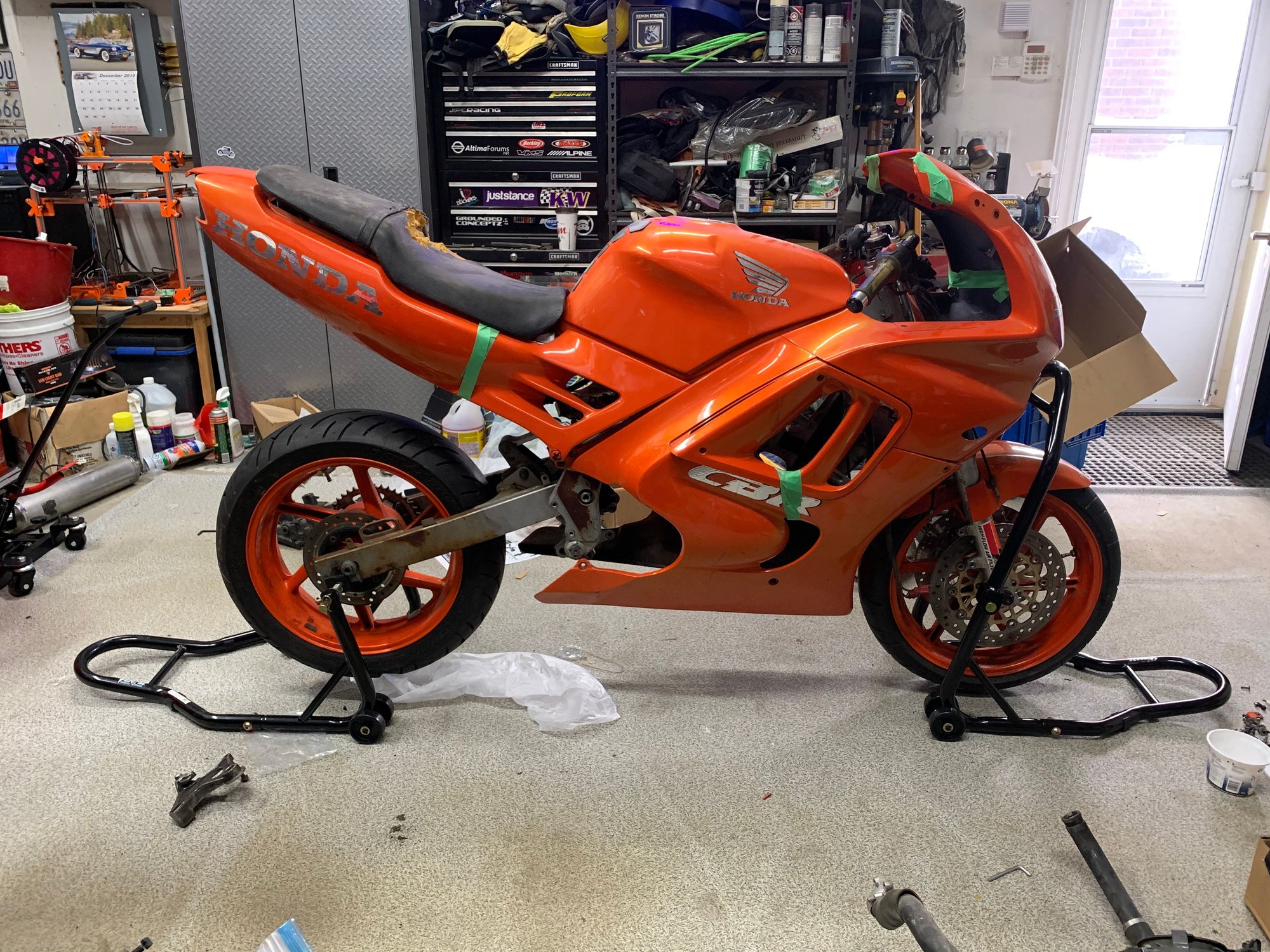

Threw more parts on to see what it really is. I say F3 bodywork on the F2 bike. Plastics need work, so now I have to figure out if I go back F2 or replace with F3 again. Cluster will need to be replaced with an F2.
I like the way the all orange looks. Bodywork looks in pretty good shape, shouldn't be too hard to fix those cracks.
Judging by the seat, you may have a mouse problem, lol.
And you'll have to replace the front rim too.
