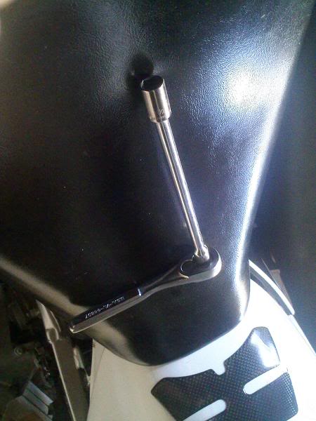

1. you will need a 10mm socket wrench with an extension arm.

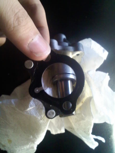

3. remove both of the bolts from the oem cct and remove the old cct, make sure to keep the bolts in a safe place. both will have brass washers on them, after pulling off the oem cct make sure to take care of the gasket. as we will be re-using it again.

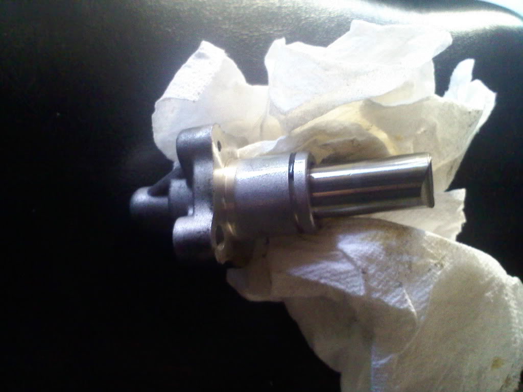

4. the oem cct

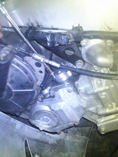

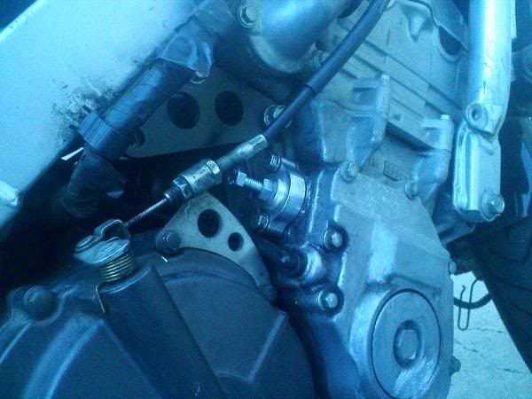

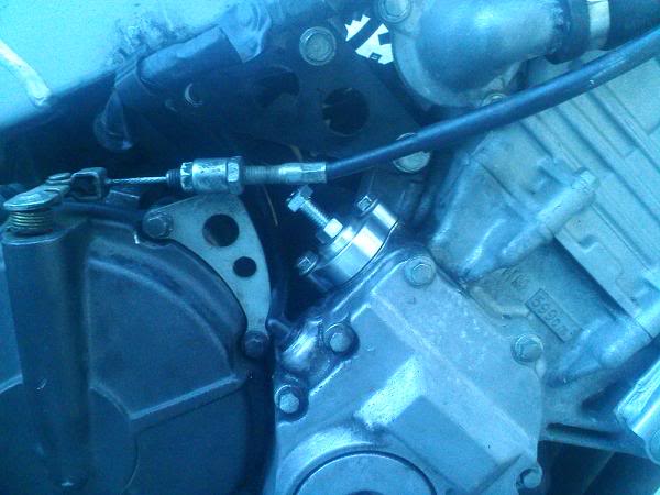

5. put berga's manual cct in place of the old oem cct, make sure to have the adjustment bolt screwed in so you have room to mount the new cct in place. if you don't the engine mount (black triangle object) will be in the way and you won't be able to bolt the new cct into place. make sure the gaskets and bolts are well placed and torqued correctly.
6. use your fingers and turn the adjustment bolt clockwise till your not able to turn it any further. turn the engine on and adjust accordingly till sound disappears, make sure not to turn it clockwise to much or to little.
