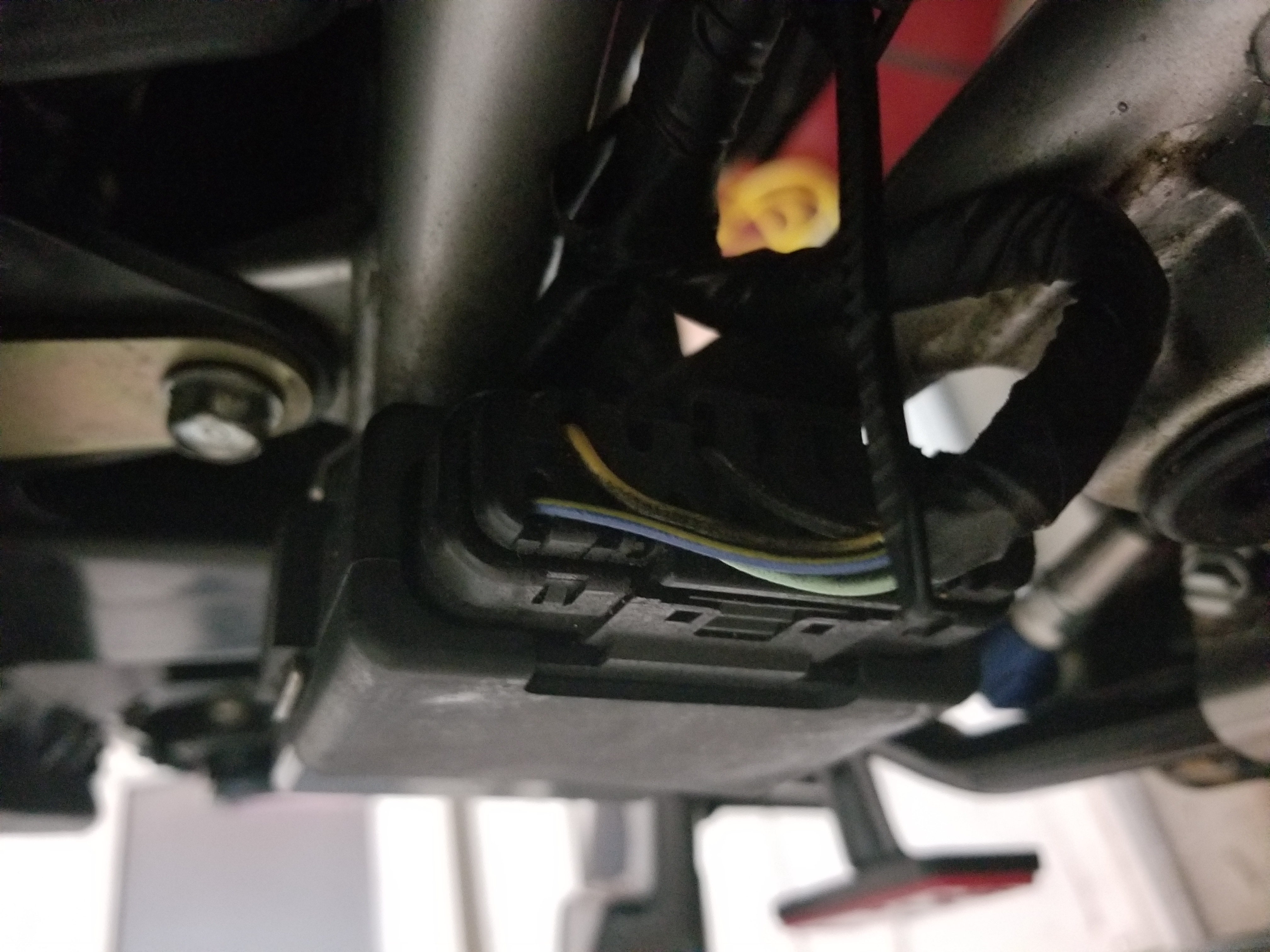

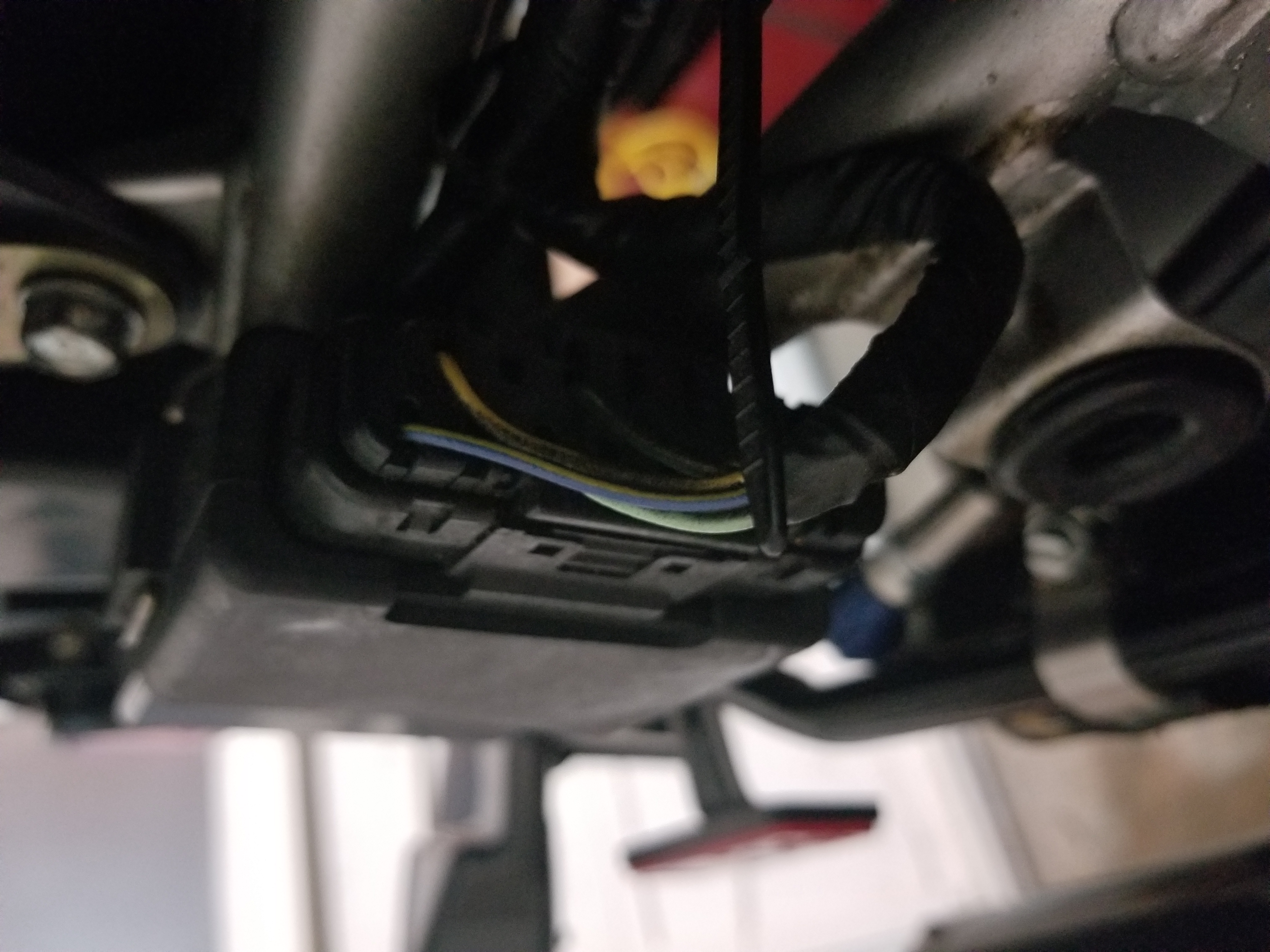

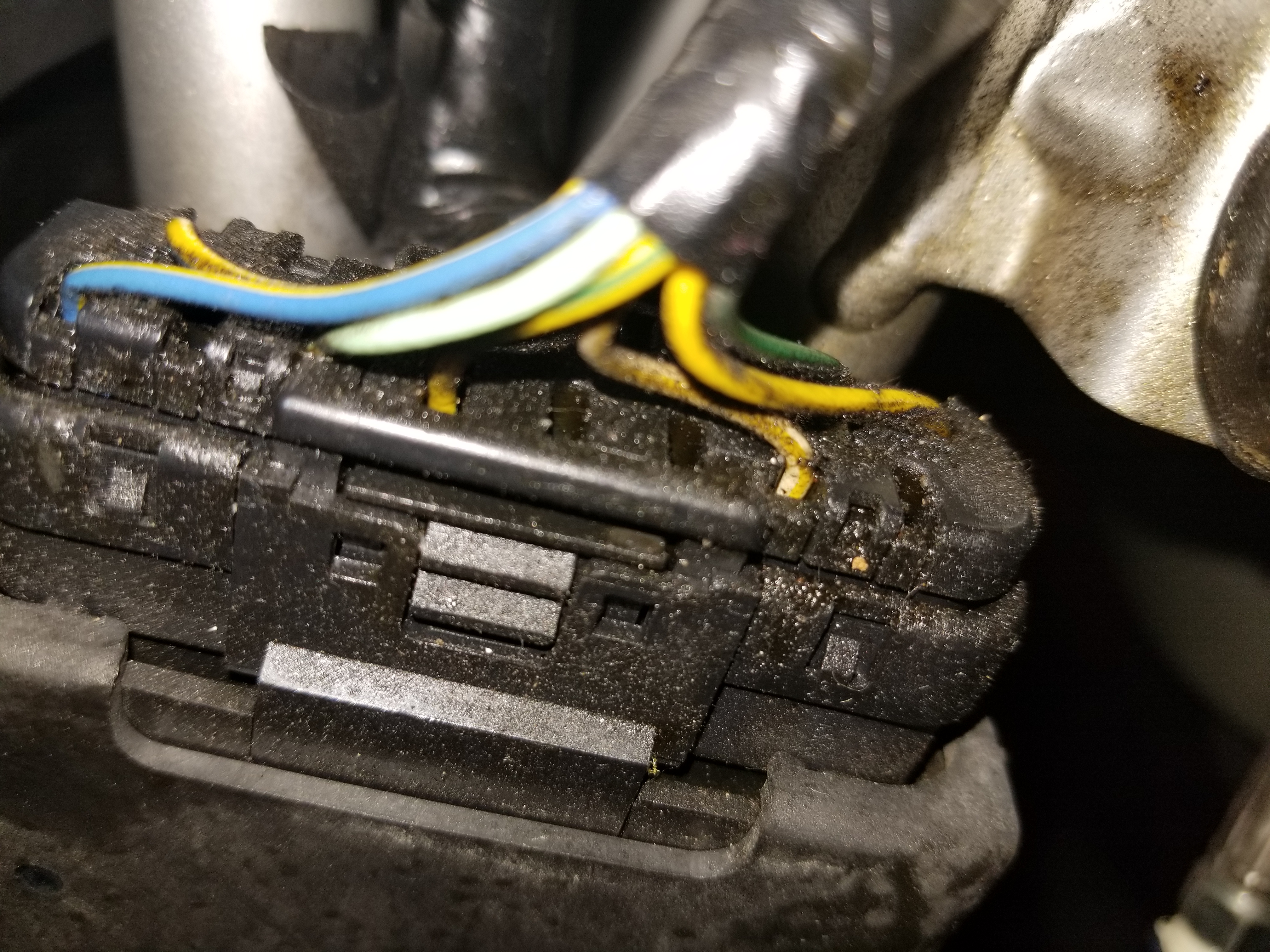

Any chance you can take a picture of your icm plug? I need to see where the wires go. I took my time I was very careful but maybe i messed up while wiring the icm
The tach gets it signal strait from the icm so if it's jumping around while I'm trying to start the bike maybe I wired it wrong better safe than sorry

[QUOTE=tampa_git;1306245]Any chance you can take a picture of your icm plug? I need to see where the wires go. I took my time I was very careful but maybe i messed up while wiring the icm
The tach gets it signal strait from the icm so if it's jumping around while I'm trying to start the bike maybe I wired it wrong better safe than sorry[/QUOTE
a few more
a few more
Perfect thank you so much,
Where is your black/white wire? I'll try to upload a picture of mine but I have everything the same but I have my black/white for the ignition coils next to the green/white behind the yellow/green that goes to the tach (our tach wire is in the same location i don't know why I'm seeing the tach signals when I'm trying to start the bike)
