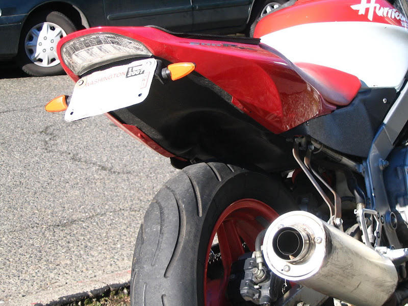

I wanted to make mine as streamlined as possible. To do this, I started by cutting off the subframe just aft of where the two bars come together so the subframe wouldn't stick out below the tail section. After that, I made an undertail out of ABS plastic covers the whole bottom of the tail section. My wires just run between the undertail and the seat. Here's a picture. I also relocated the rear brake fluid reservoir to clean up the look a little bit more.
If I didn't have an undertail, I would probably wrap the bundle of wires really well with electrical tape or shrinkwrap to protect and camoflauge them, and then zip tie the bundle along the length of the subframe.
