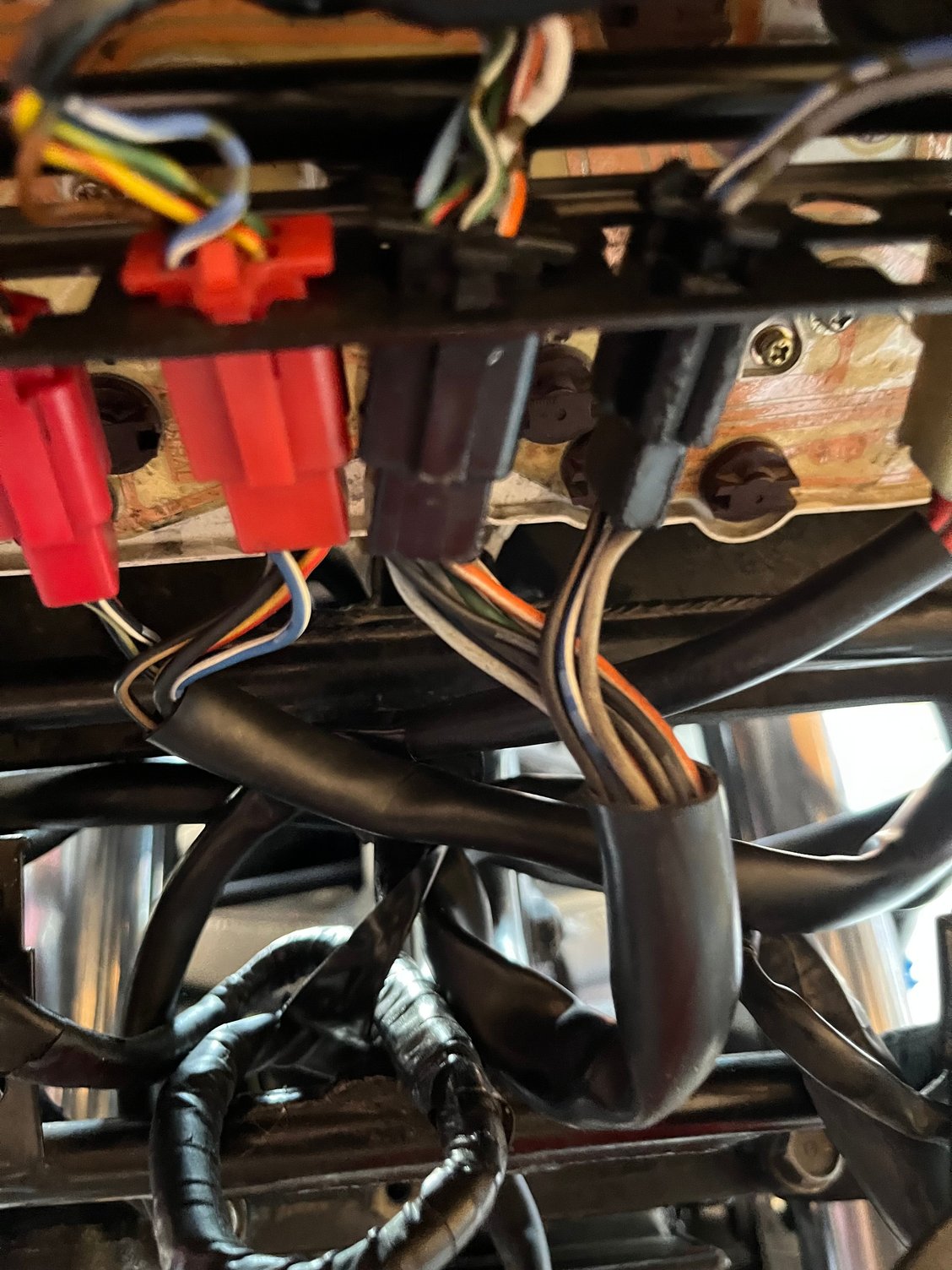

Did
I mention the previous owner broke the headlight mounting tabs and a new headlight was required to get the front fairing to align. This is the condition of the harness and the left switch connected the left black was just a tad loose. Have a horn and turn signals. I don’t know why i don’t record this. That was so much help without removing the relay and checking I would’ve been lost.
