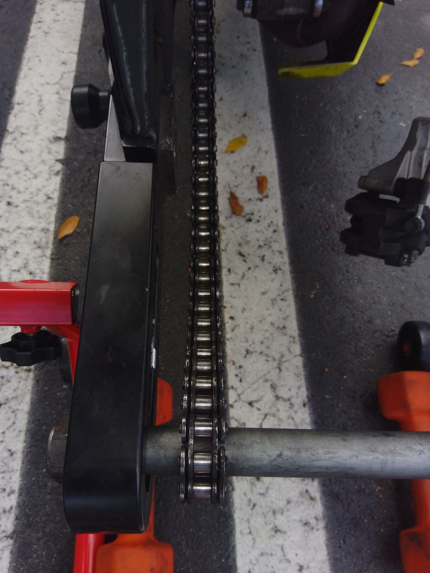

Hello friends while I'm changing my rear tire id like to remove this swing arm extension, but I do not want to buy a new chain and sprockets yet . Since they look in good condition
My question is can I cut it and make it the right length?
Any tips and tools I need to get this done if it's possible?

Does the chain have a "master link" - one with split pin on it already? If not then sure - grind the heads off the pins, push them out, shorten the chain and use a master link to rejoin it.
If it's a rivited chain, then you need to either buy the correct size master link, or have it pinned - might be easier to take (the bike) to your local shop to do that than buy the pinning tool - often the chain has to be threaded before it is pinned.
That chain looks like it needs a good soak in diesel or mineral spirits to clean it up while you have it off the bike.
