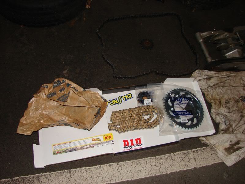

Itsquite easy toloosen the swingarm, to get the chain past it.
I removed mine completly at the time to re.paint it too.
Just remove the main pivotbolt, and let it hang in the suspension. You can move it around pretty freely, to get the chain past the frame.

I've replaced my chain without even removing the wheel...
Just grind the rivets out from the master link, pop the pins out, temporarily join the new chain to the old chain with the master link and pull it through.
Then remove the old chain, cut new chain to length (move wheel forward first) and put it all together

I trust the chain manufacturer better, than my own riviting skills, when it has to be put together again :-)
Just one thing less to think about.
I was replacing the bearings, and tires anyway, so the wheel had to be taken off .....took abot 5 minutes to get off :-)
Loosen, and remove the swingarm bolt, takes abot 2 minuts......slide off the old chain...slide on new chain.....
I bet it can be done almost as quick as finding all the tools to cut, join, and rivit the chain :-)
