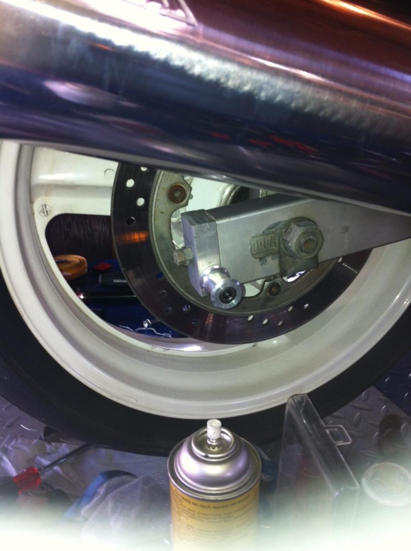

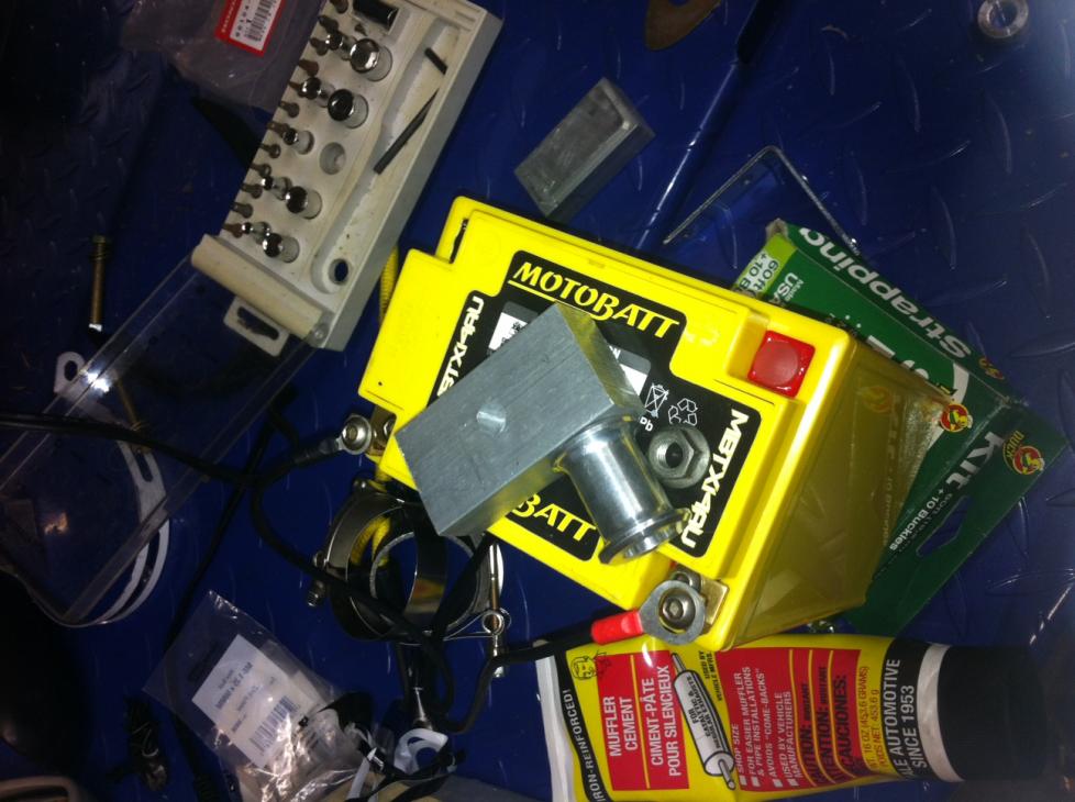

where I'm @ with this / custom rear chain adjuster plate for mounting spools
Old Mar 18, 2012 | 07:02 PM
  #22
Sprock's Avatar
Posts: 11,003
From: Republic of Boon Island

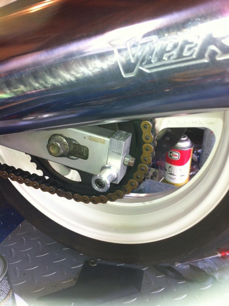

done nothing left to only polish them up a bit
Attached Thumbnails Spools : on 1000F swingarm-a1.jpg   Spools : on 1000F swingarm-a2.jpg

... so what did you need to cut the L groove into? i thought it had to do with this, or is there something not visible from this angle?

Looks nice, but I wouldn't trust holding up the back end of the bike with the chain adjuster bolt.
Old Mar 19, 2012 | 05:10 AM
  #25
MadHattr059's Avatar
Joined: Feb 2011
Posts: 2,299
From: Tulsa,OK
It should be strong enough, the load is distributed by the shoulder of the block
inserted into the end of the swing-arm. So it is all sheer. The adjuster bolt
just ensures it stays in place so the shoulder can do it's job.
Nicely done, big guy!

Well Malbo - as Ern knows two - there's a block of alum inside the swingarm to take all the weight and it's doweled into the rear outer block - the adjuster bolt does nothing only tension the adjuster as it's supposed to........... it'll never move or break
And indeed Ern , mark 2 version - I will use a table saw with carbide tipped blade to cut an L ! - hopefully I keep all fingers

My question is WHY. You can't do chain work or remove the rear wheel w/o removing the adjusters.
You have the lift where you can strap the bike down. In the shops the guys strap the bikes down. You can turn the lift upside down and the bike doesn't move.
It sounds like a classic case of cabin fever.
Old Mar 21, 2012 | 11:19 PM
  #29
Sprock's Avatar
Posts: 11,003
really lol - well the PitBill stand I have for the rear is this one so you could say
taking the rear wheel off is no problem flipping the adapters around and using the
pads - only reason as I said in putting spools on was less chance of the bike slipping
off the pads doing other more aggressive wrenching tasks .... know what I'm torquing
about TBT
