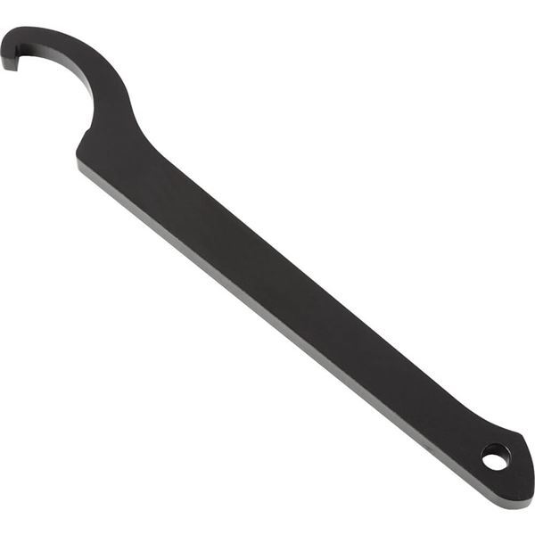

Yeah, need to remove top fork-clamp to get to adjustment cup and locknut underneath.
Need tool like this: https://www.ebay.com/itm/325896647637

No wait, I can’t even get the top fork bridge off. Isn’t it just pulling the silver top part off the stem and then having the other nuts, washers and bearing cap underneath it?
the shown picture is from earlier models I think.
