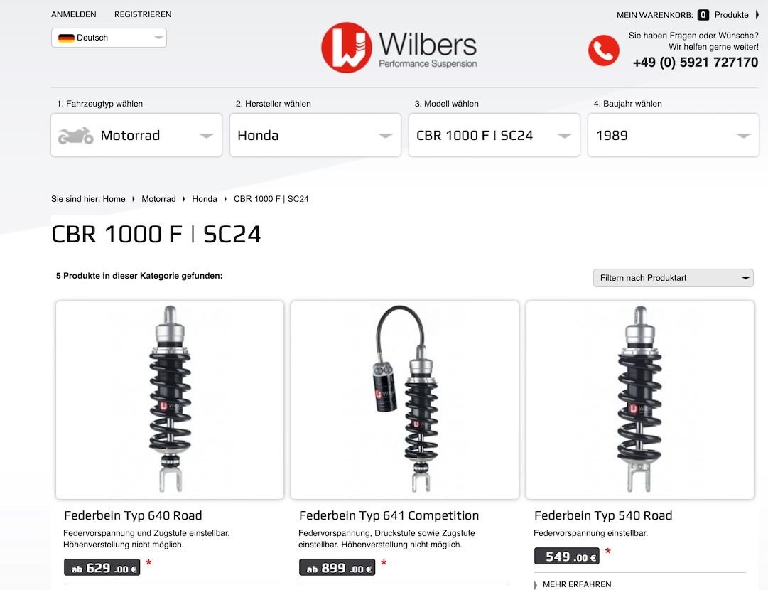

Make sure you budget for a Wilbers:
I have Typ 540. It's a huge improvement over the stock unit.
Good luck with your rebuild.
