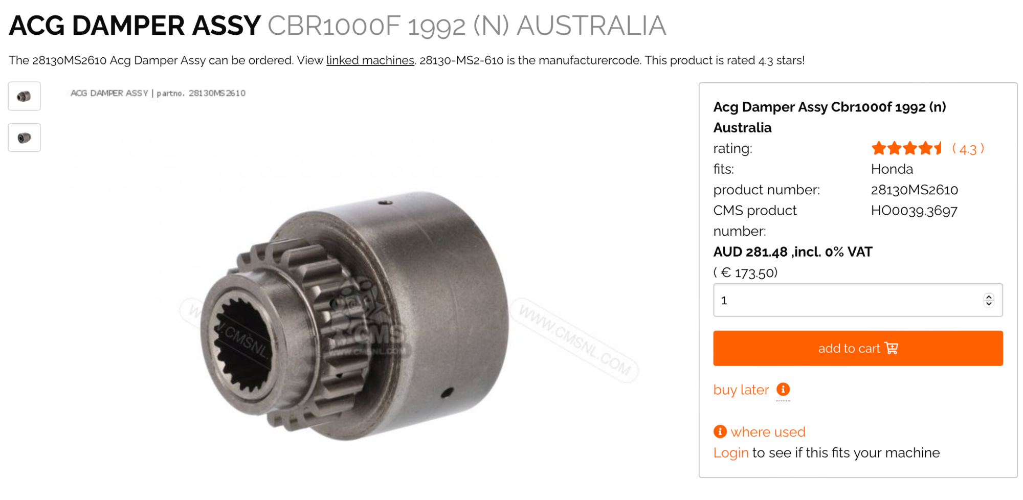

Ok thank you. I had to mess with the insides, though. I now put it all back together but let the engine out of the frame. Wanted to check whether or not the starter motor is moving the crank shaft.
Well, it does not! As far as I know, the culprit can be that freaking clutch on the generator shaft. I think they call it starter cluth and I am not speakting of the "one way turning thing" that is driven by the starter motor more or less directly.
So I am talkin bout the clutch like thingy that got little friction plates in it. I got the feeling it "runs through" (no grip). But what brings the pressure to it? I mean, there are strong springs on a normal clutch and by pulling the clutch lever you relase that pressure. Easy to get.
But where is the pressure in that little beast? I know there are 2 (two) smaller spring like rings (like bended washers) right next to the "one way turning thing". Do you know in which direction these springs have to be put on the generator shaft? I really think that the starter works fine and that it drives the generator shaft, but that little cluth thing will not carry on the forces over the chain to the crankshaft.

You can get a replacement part. They are still available:
Others have managed to rebuild them. Search the forum. These units eventually fail, but if you get a new one now, you'll never have to touch it again!

Ok, so this little thing is nothing but a clutch-like damper, right? I suppose its purpose is to reduce the stress in the generators peeks, right? Again I completely dissambled my engine last night (from midnight to 3am). I opened that damper and checkts everything. the friction plates and metal plates looked great. Thick enough, I guess. I cleaned it and put the washer-springs in the right order. I had them installed the wrong way before. Now the rod has more grip. Could not test the starter motor though.
