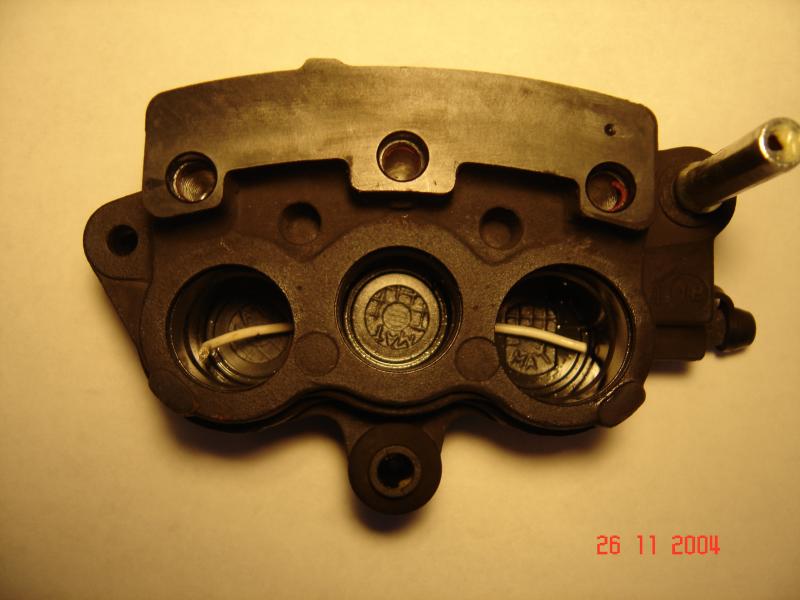

My garage is finished and I'm ready to start my de-linking project on a spare set of calipers I bought. But, now I can't find the original How-to thread on the forum. It looks like the CBR forum was revamped/changed and links on other threads don't work any more. Can anyone point me to the original post? Thanks.
Here are the calipers I'll be working on. My plan is to takes photos as I go along.

Depends which way you are going to the de-link.
Method 1 - Buy a de-link braided hose kit from Goodrige or HEL
Method 2 - Drill the calipers to get all three pistons working from one inlet.
In both cases you are going to need a change of master cylinder to correct the lever/piston ratio.
I found a CB1300 master cylinder gave a nice feel ( 14mm bore )
I also left the rear caliper operating on the outer two pistons - three pistons gave way too much pedal and a snachy rear brake.

Here are pics of blackbird calipers internally drilled to join all three pistons
All you do on the outside is blank off the old feed to the centre piston
Attached Thumbnails Brake de-link thread-cbs-caliper-inside-1.jpg   Brake de-link thread-cbs-caliper-inside-2.jpg
