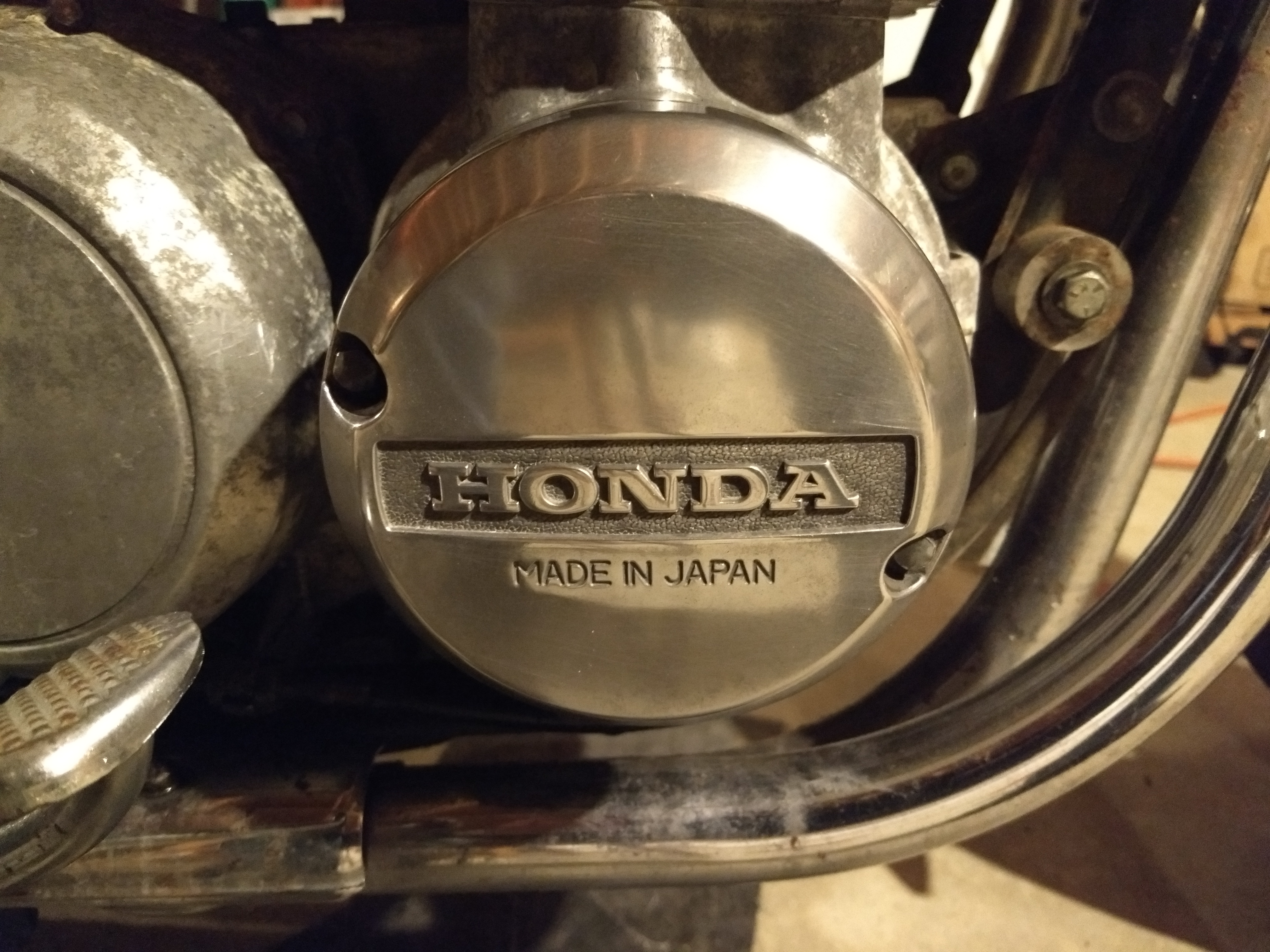

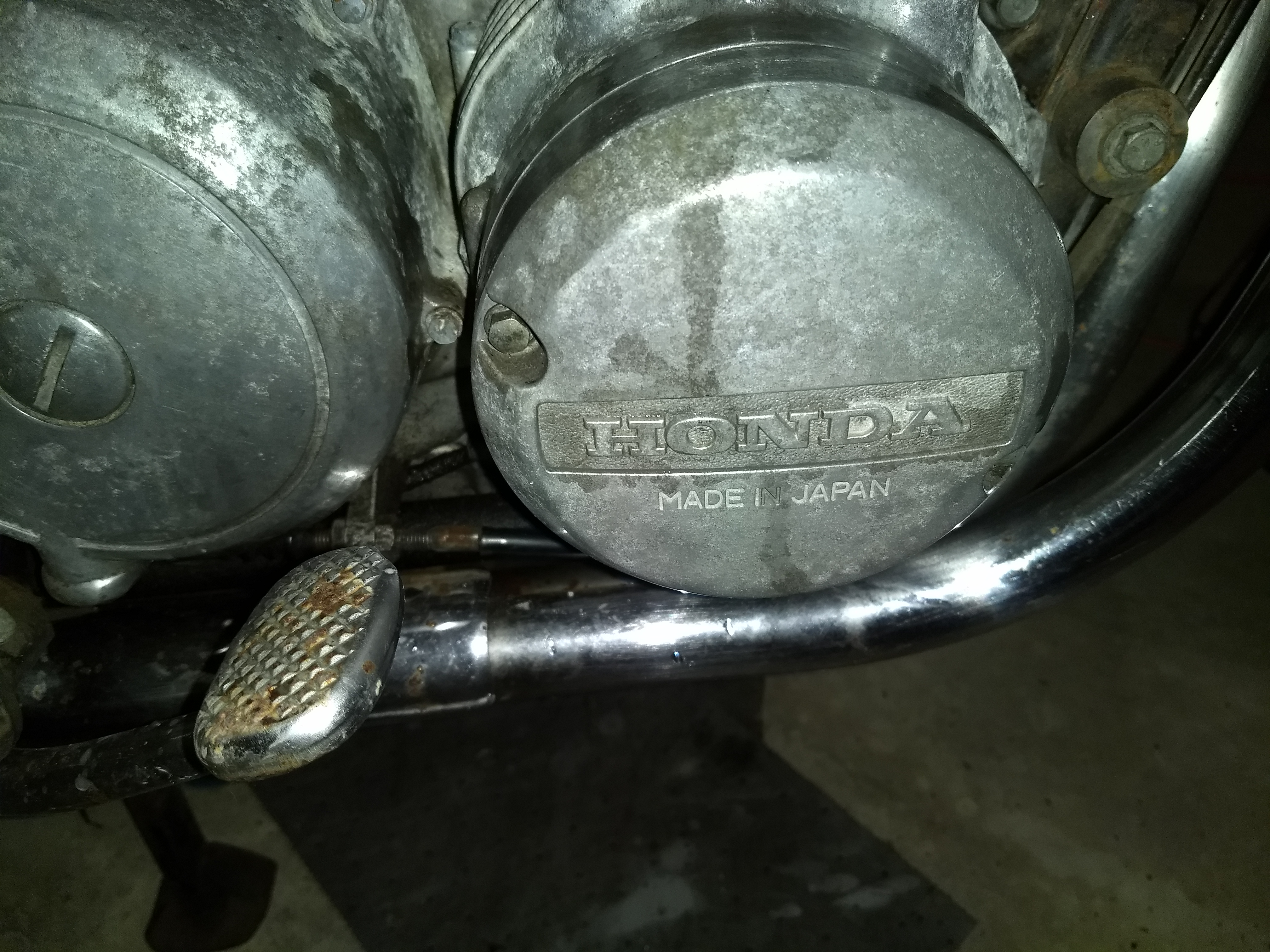

Awesome thanks, you're putting me on the right path! I did a little more research and it seems that if I want to practice first I can use 2K clear over pretty much any urethane primer and base paint - Laquer and enamel causes problems I guess. It will save me 50 bucks and I can still have fun with it all.
It might be after Christmas now before I get ta paintin' - GF and I are going to FL. Will probably get the tank cleaned off though. I'm going to have the battery, airboxes and carbs back on tomorrow or next day - The "first start with a temp tank" needs to happen!
I did get better at polishing aluminum - Three different grits of sandpaper and two types of buffing rouge to get a "not quite mirror finish" . The last panel holds oil so I'll probably take off and redo one on the other side and might actually get it right this time. The representative flagship cover before and after:

That's a nice polish!
