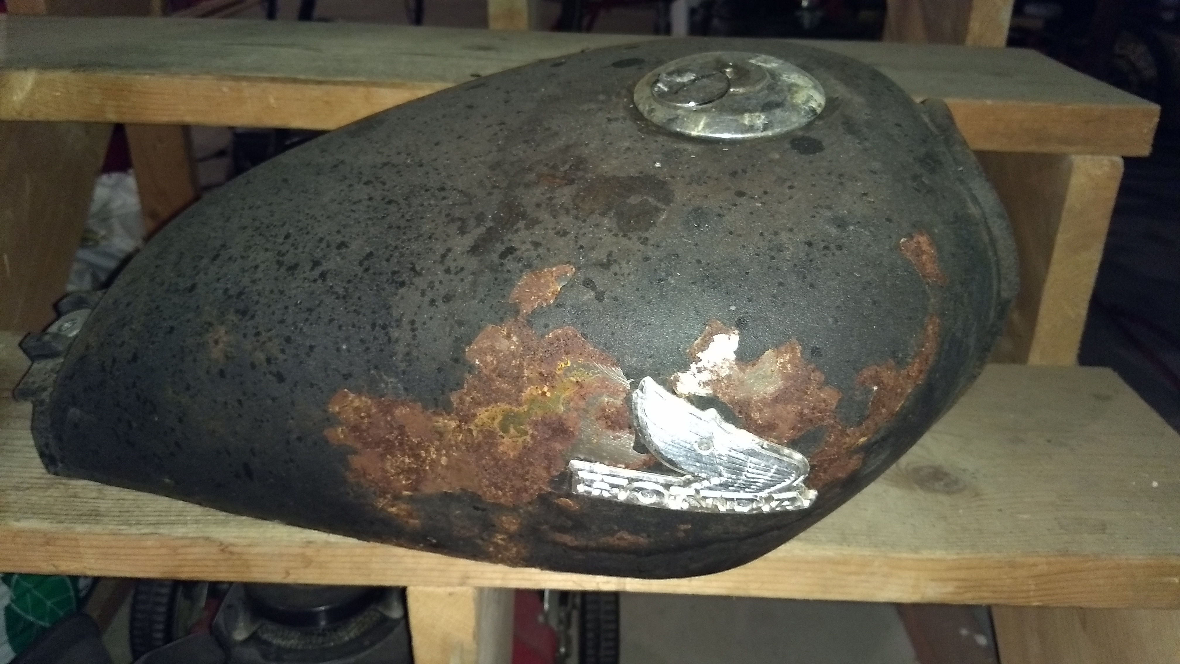

Ok, my float bowl gaskets are in so I can stop messing around and get it fired up. Last thing other than change the oil is dealing with the tank. It is clean inside, or clean enough I think. The beige color is some kind of rubber coating. The outside is dent free, but has paint that is peeling off in thick flakes. Should I spray paint stripper and scrape, or is there a better way - I'm not going to bolt that natty 'ol thing back on without doing something! And what would be recommended to just keep the rust off it - Maybe a primer paint?
Pretty cool, other than buying a brand new sealed battery all I have in this thing is a couple hundred bucks and time. Hope it starts lol!

Old Dec 4, 2017 | 09:08 PM
Posts: 7,177
I've used aircraft paint remover in the past. It works very well
The only thing is you need to wear thick rubber gloves and you can't let it touch your skin as it burns.
