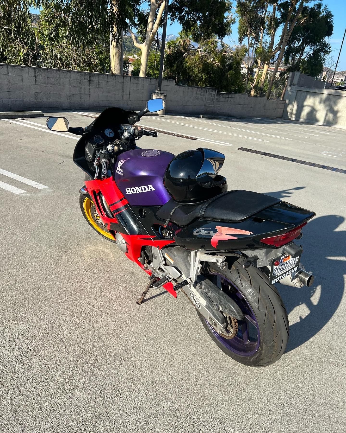

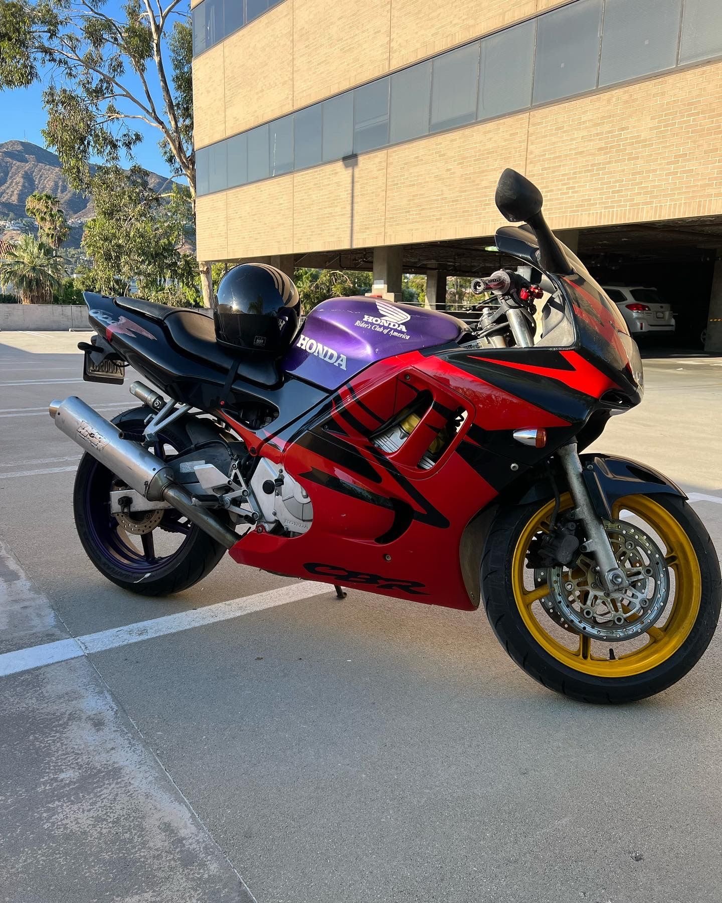

New to the forum. Great stuff here. I was able to ****** a Honda CBR 600 F3 SE (Smokin' Joe edition). Pretty much a bike that's just been sitting and collecting leaves and dust. Didn't run for a few years. Cleaned the carburetor, replaced the oil/filter, air filter, spark plugs/coil, fuel pump/filter, clutch cable, adjusted the rear master cyclinder/brake and pfoof, she's brought back to life. Problem is the fuel pump only runs with a paper clip jump. Bought a relay from dealership just to be sure, but still a no go. Only kicks in with the clip/jumper. Other than that, she's a beast.

Hey there and welcome. I always like the Smoking Joe edition bikes. Post up some pics sometime.
