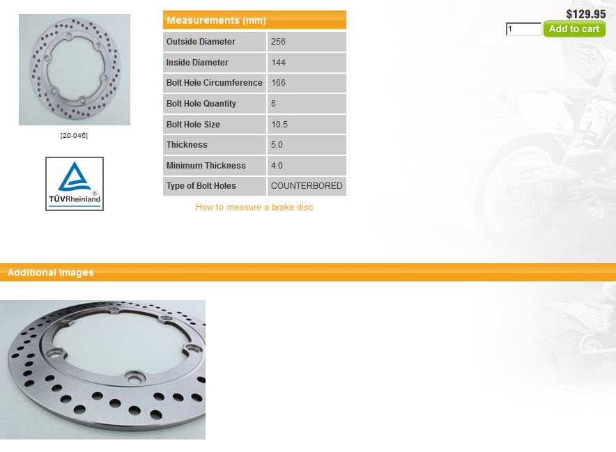

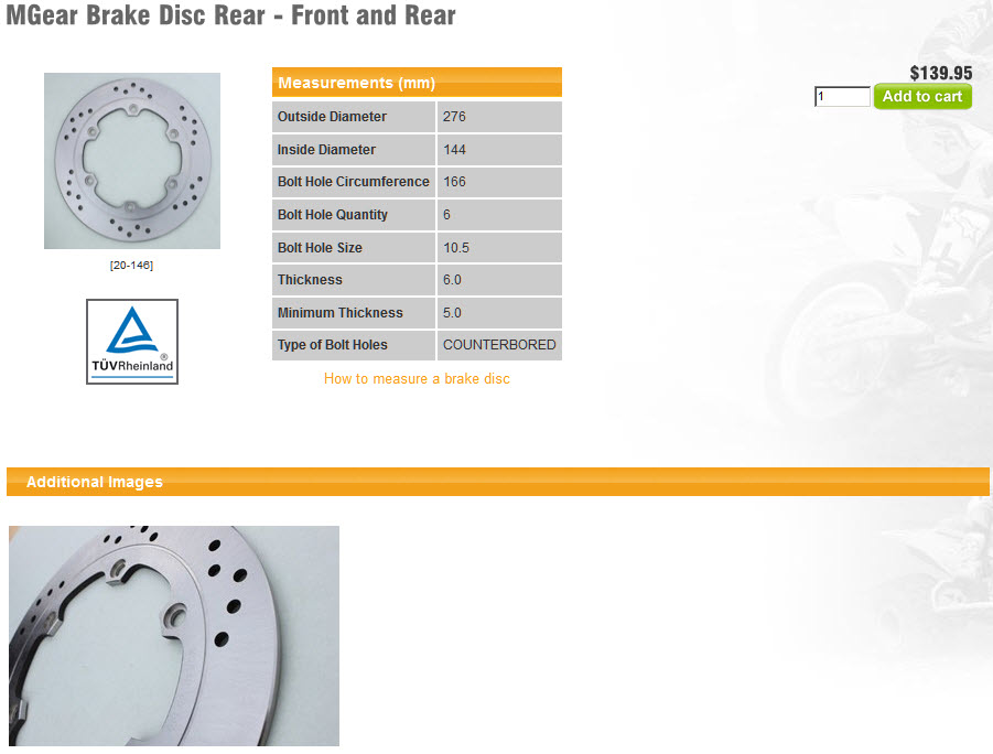

Hi Mike - nice looking bike you got there!
Good to know! Interesting to see how the 89-92 is much larger (than the 93-99) in Outside Diameter and Thickness.
Attached Thumbnails Rear brake mod for an 89 CBR 1000 F-rear-disc-cbr1000f-89-92.jpg   Rear brake mod for an 89 CBR 1000 F-rear-disc-cbr1000f-93-99.jpg
