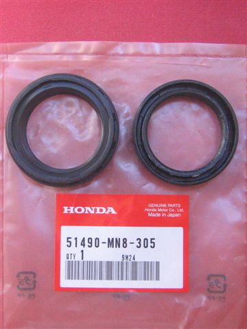

2 x Honda Fork Seal Kits as below in Australia = $76.50
Oil = $29.00
Attached Thumbnails Fork Seal - Replacement-img_3517.jpg   Fork Seal - Replacement-img_3524.jpg   Fork Seal - Replacement-fork-seal-set-one-oil-seal-one-dust-seal.jpg   Fork Seal - Replacement-img_3526.jpg   Fork Seal - Replacement-top.bmp.jpg

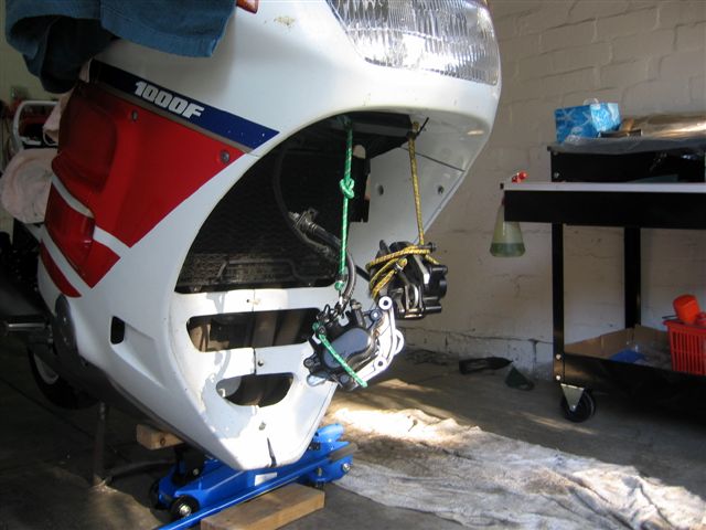

1 Bike on centre stand and jack or block under sump for support. Support brakes with ties.
