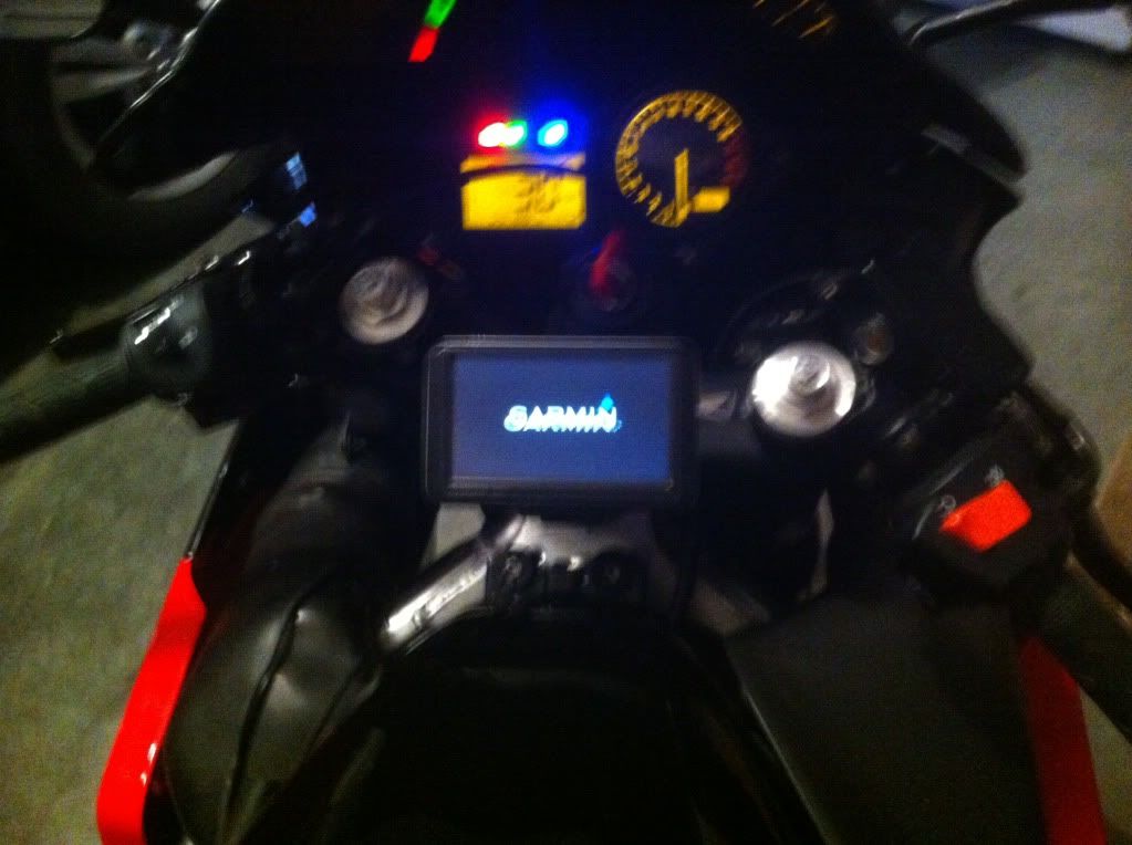

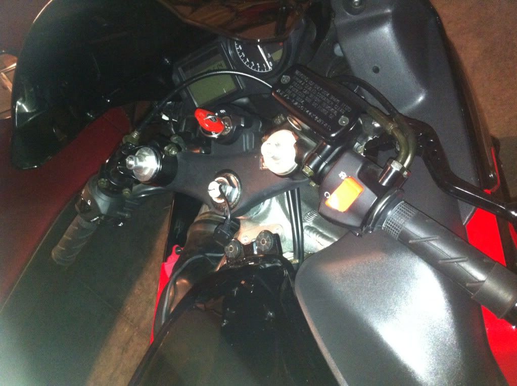

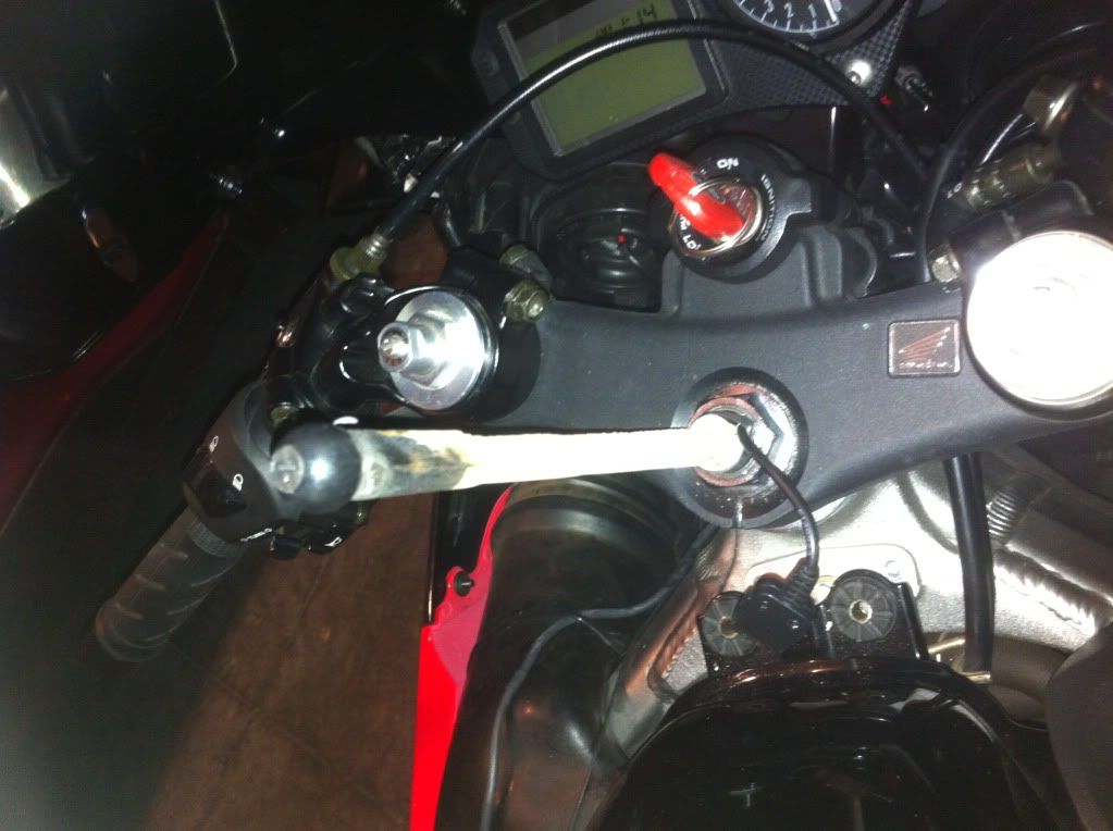

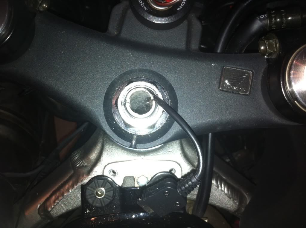

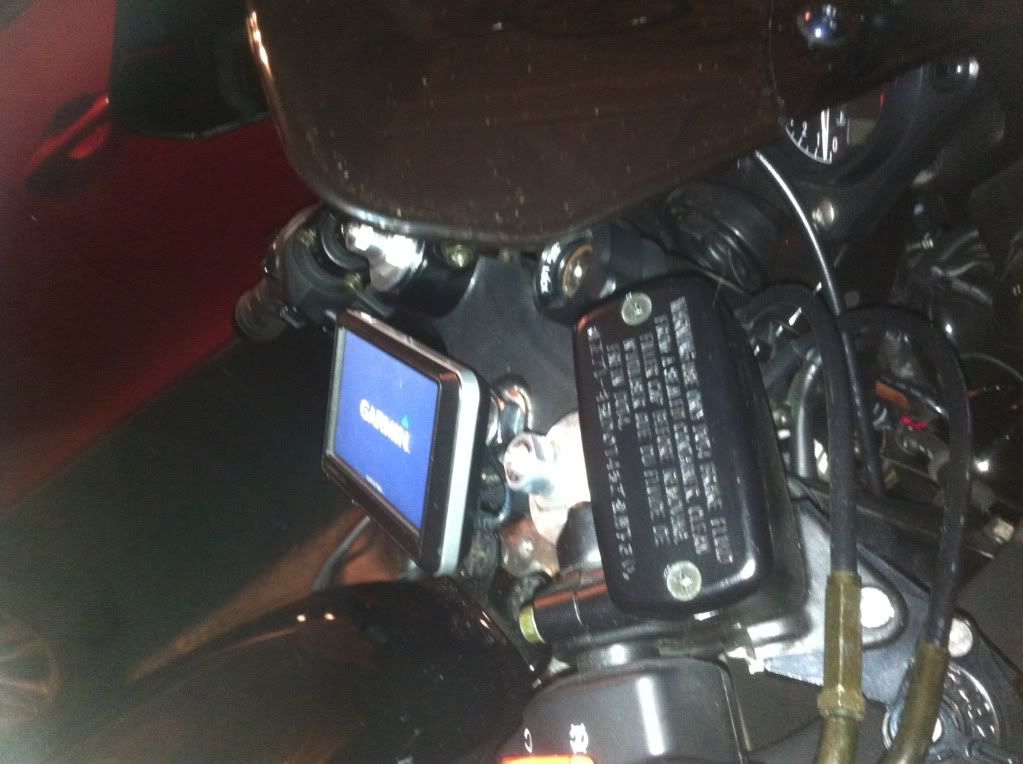

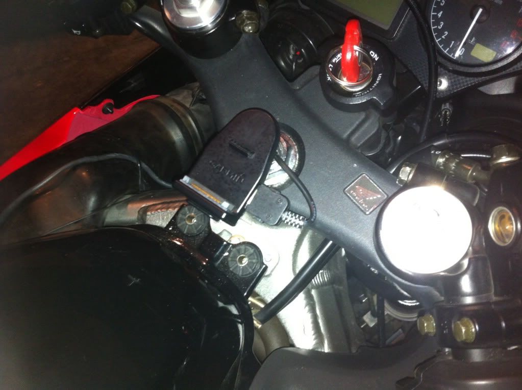

i think its a pretty good idea. i did mine little different tho..I made mine so the power wire went through the triple tree hole. only thing id suggest doing different on yours is cut the ball off and counter sink the bolt through it so it doesnt sit up so high. here a few pics of my set upName:  IPHONEPICS131.jpg
How did you attach the gps bracket? I was thinking about skipping the gps suction cup mount and just putting the bolt through the gps bracket but my stock nuvi 1690 bracket won't allow a bolt through it, the bolt would impede the gps from sitting flush on the bracket.
