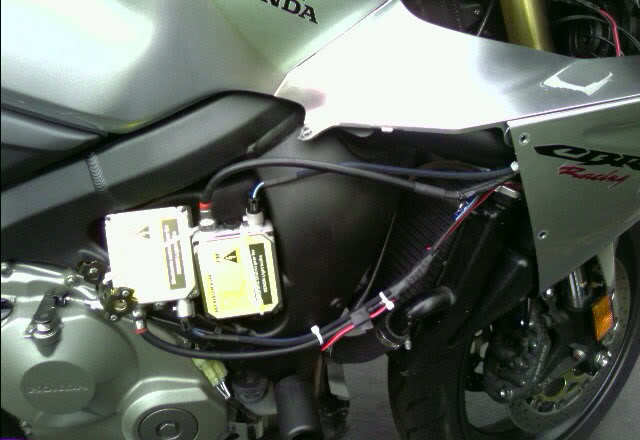

Thanks a million for your instructions Fox. I choose to try try two different kits (the 6500k motorcycle version of the unit you recommended [built in ignitor]) and an automotive kit (3000k built in ignitor). The ballasts were much bigger than I anticipated and the silicon wires from the ballast to bulb we very short. I ended up having to piggy back them on top of each other where my tool box was. For now, the quick set screw that holds my right faring on is helping to keep it snug in there. Here is a (not so good) pic of the end results. If I had to do it again, I would get a kit with the ignitor separate so that I could extend the wires.
Thanks again!
