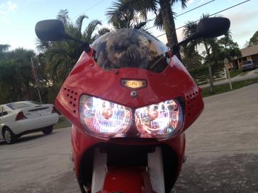

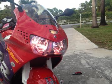

so here's the one's i did on my 98 cbr900rr in red what you all think
Attached Thumbnails  Angel Eyes/Demon Eyes- how to (1000RR) -lots of pics-angleeyes2.jpg    Angel Eyes/Demon Eyes- how to (1000RR) -lots of pics-angeyes3.jpg    Angel Eyes/Demon Eyes- how to (1000RR) -lots of pics-angleeyes4.jpg

Great write up, looks bad***!
