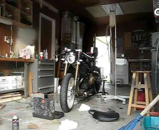

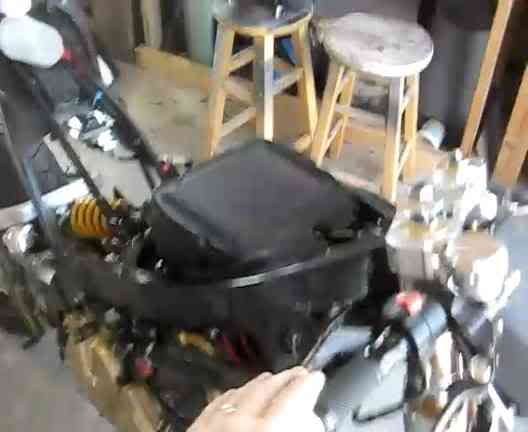

here is a video of it "running" for the first time on saturday.
So i put some gas in the bike and fired the bike up. well.. it turns out the left two cylinders are not firing... at all. the header pipes dont even get warm.
