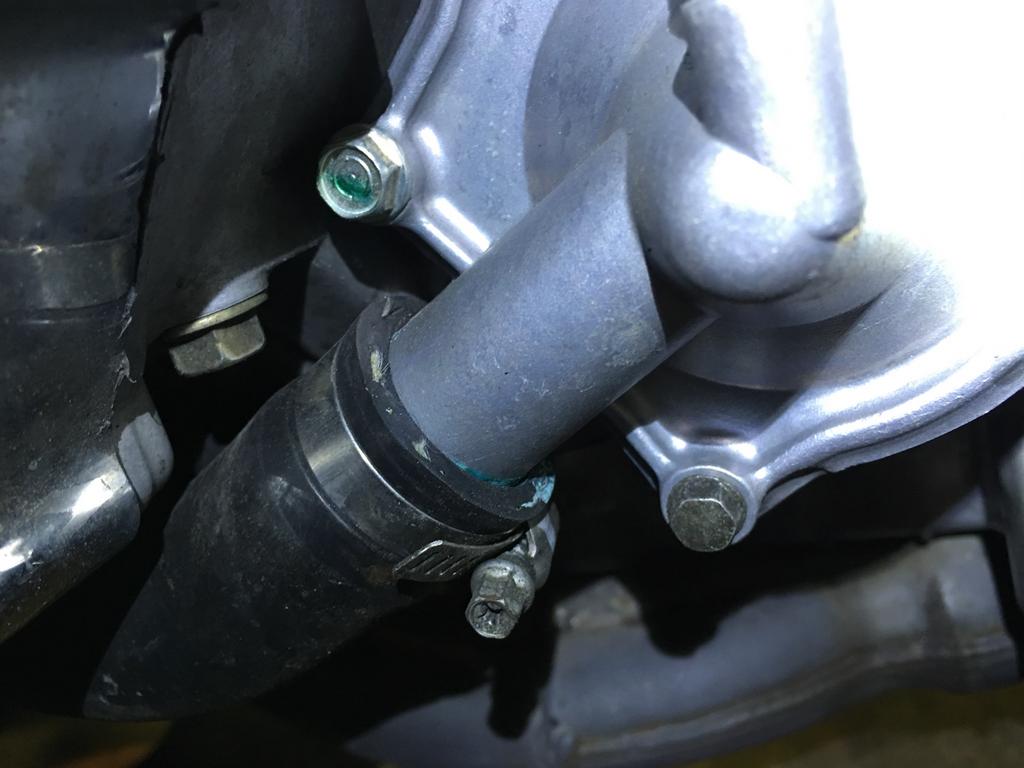

My bike (01 F4i) has always run hot but recently since last month or so had a problem where it was leaking coolant out of hose ends, reservoir cap and overflow hose. Enough to leave some pale green streaks on the sides and, when I parked bike hot, it would drip couple drops until cool.
I thought the coolant hoses are probably old (as it was leaking out the fiber holes as well) and maybe these leaks causing the coolant to boil over too soon. Even if I was wrong, the hoses definitely needed replacing anyway. What do you guys think caused the leaks btw??

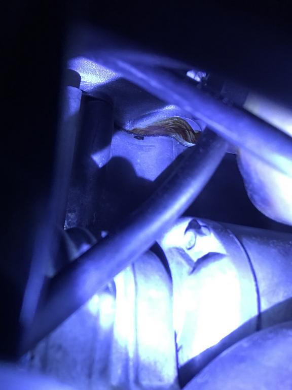

BUT while looking for leaks I found THIS:
Can you see it? That was the best picture I could get, it was hard to take. But basically that is right under the headgasket area, seen from the left side of the bike next to the stator. Dark golden caramel brown and pretty flat, it looks like it came seeping from that seam right there... doesnt look like coolant at all though.
Whatever it is, seems to have been there for awhile as it's pretty dry/baked on (does not wipe off)

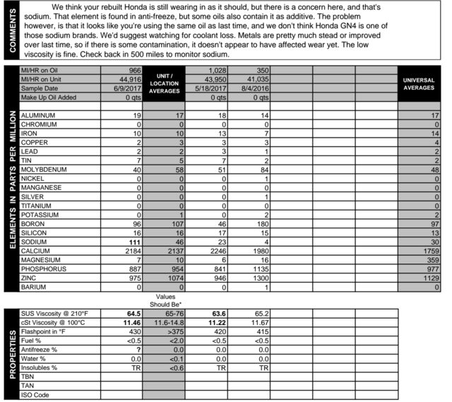

This, combined with my last oil analysis report from Blackstone Labs, got me worrying. Says they found sodium in the oil, possible sign of coolant. (Previous analysis reported normal wear) It seems very possible to me that IF high pressures caused coolant to leak out the outside, it could have done the same on the inside...

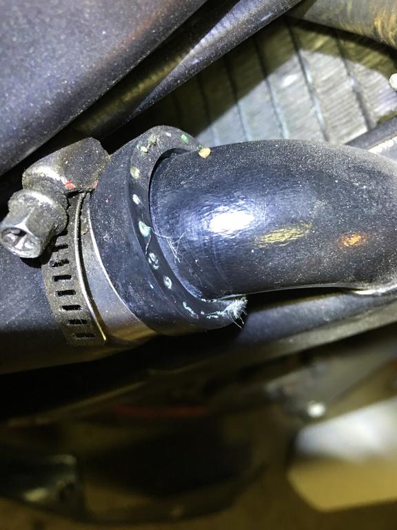

Some pics of the old coolant leak (you can see some coolant seeping out of fiber as well as the gap... there was a bit more but I wiped it off before remembering to take pic, oops):

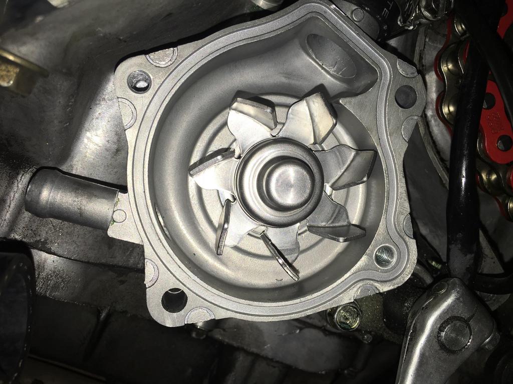

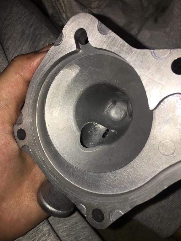

Also, noticed some wear on the waterpump when I took it off to install the new hoses. Is this normal wear for a water pump with only 2k mi on it?

Hmmm, that's a tough one. Since you're saying the engine was rebuilt, that brown stuff could be engine shellac from when they put it all back together.
I've had hoses leak before from the ends. I actually put a second hose clamp on one and it stopped leaking.
