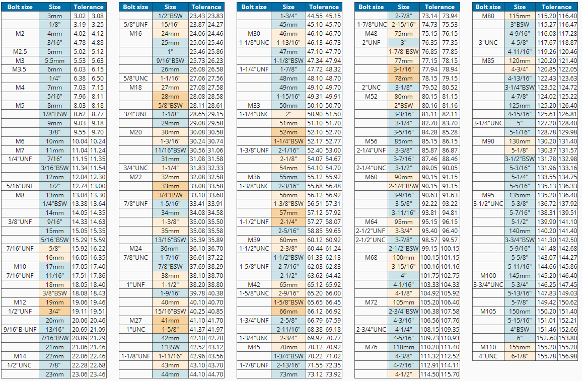

Hi generally the thread size comes automatically with the socket/spanner size, although that's not always the case with Honda, but if you get one of these your always right
Sealey 20pc Metric Screw Pitch Thread Gauge 0.4 - 6mm Folding Leaves | eBay
Also take a look at this
