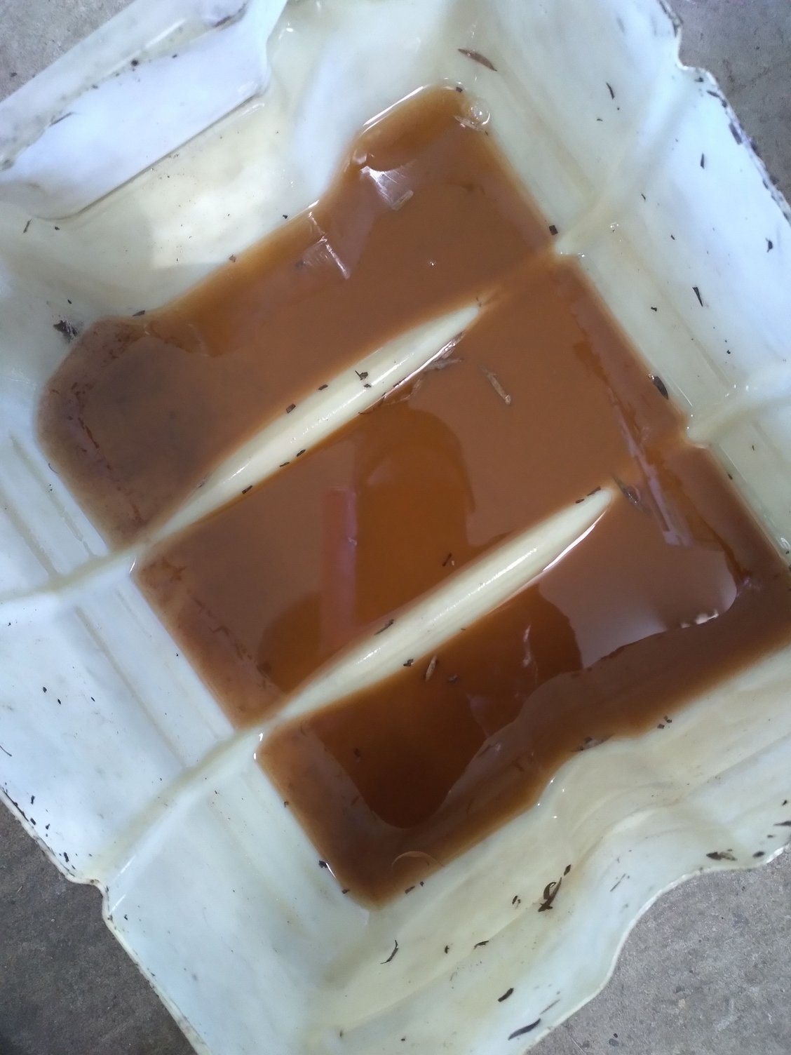

Top pic is the fuel I drained out of the tank............
I cleaned out the carbs with carb cleaner and lots of air, massaged some grease into the diaphrams and put it all back together ( with all hoses in place !) and all is well, goes as it should. Happy Chappy .

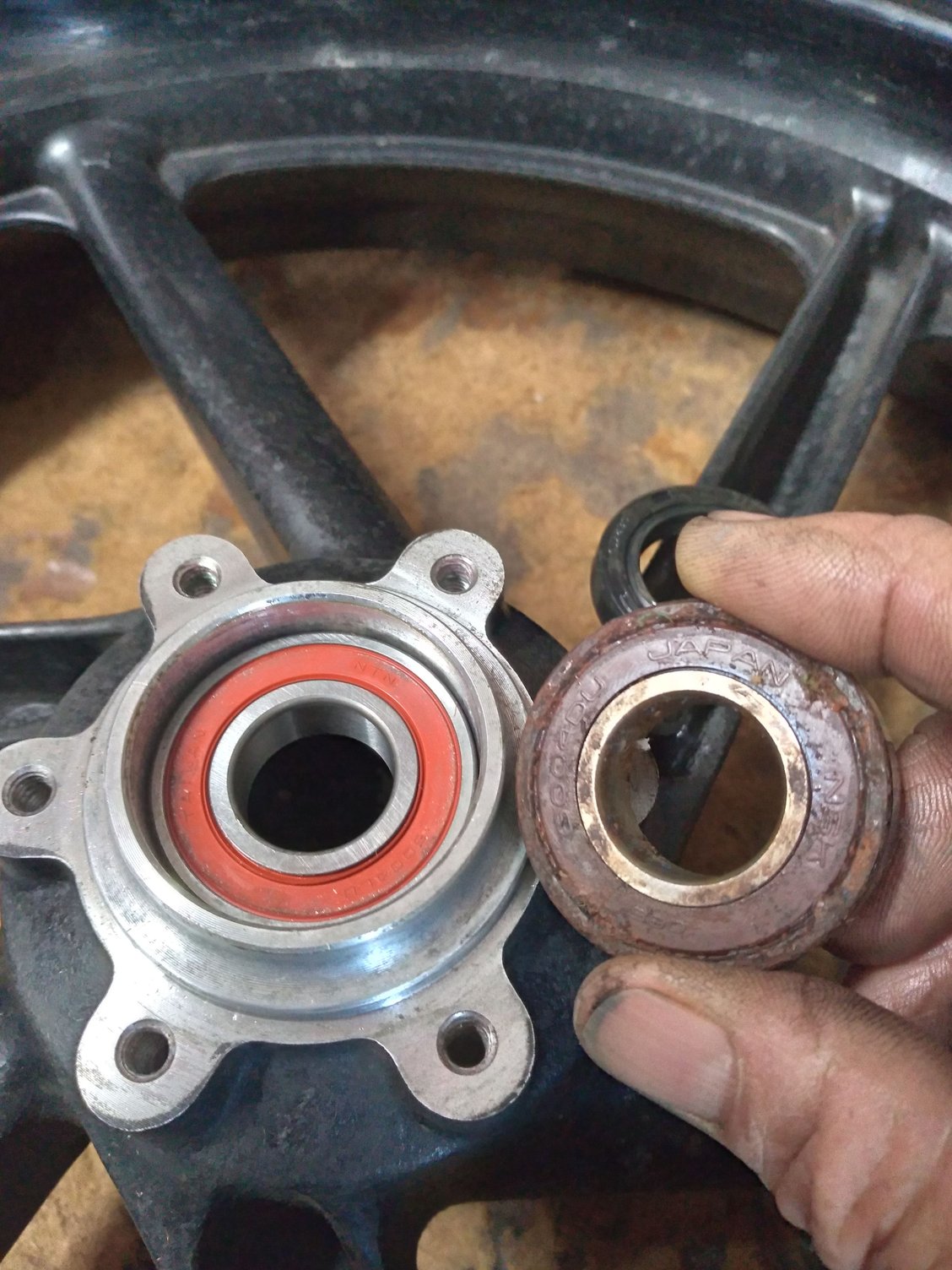

The front wheel bearings were shot, this I think was due to someone using a pressure cleaner which blasted water past the seals and the result is as shown..

Holy smokes, that fuel was bad, not surprised then that the carbs needed a jolly good clean.
Fantastic that it is now running properly

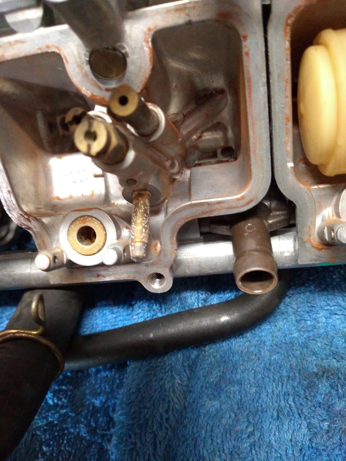

Curious, did you replace the O rings on the brown T connector in the above image? They're prone to leaking. Especially after sitting for a while.
