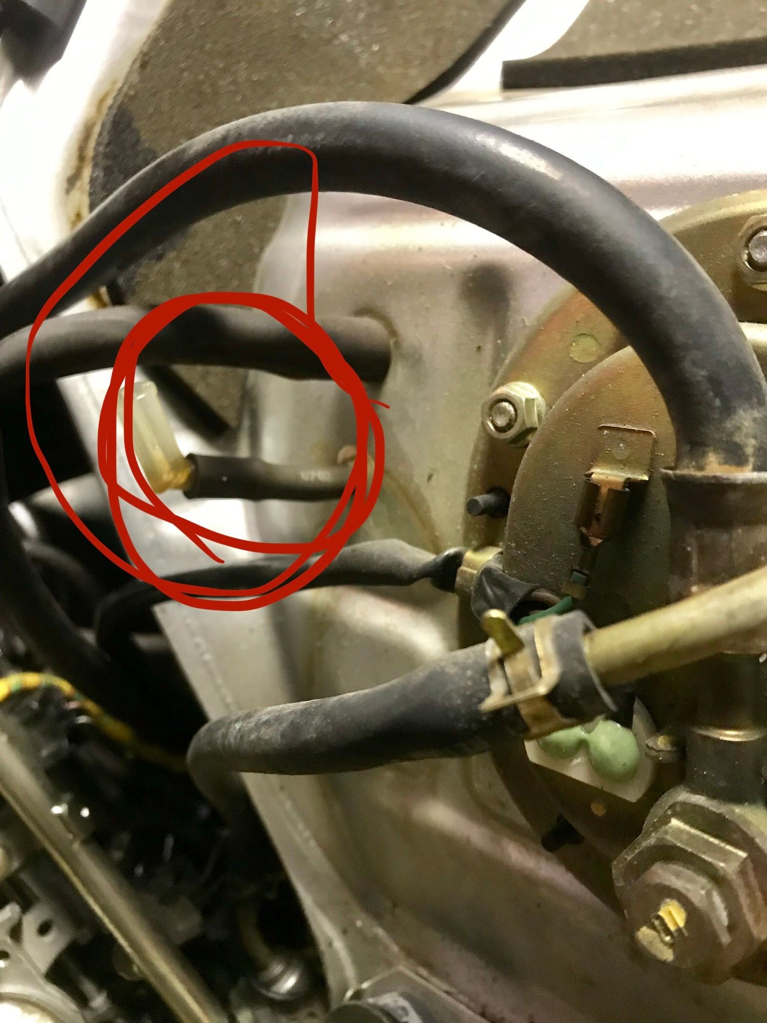

Default Need help Identifying this part of the fuel tank and what it attaches to

Are we talking about a Honda cbr600f4i?

Posts: 40
yes, sorry

Yes matey overflow and breather pipes

Big one is the drain from the cap area. The little is the vent that goes to the evap canister if equipped or nothing.

So as i was moving the tank around during and engine swap, some gas leaked out. need I worry?

Might be a bit of residual, as long as it's not from the pump

When you tip the tank around, some fuel can get into the vent space and will leak.
