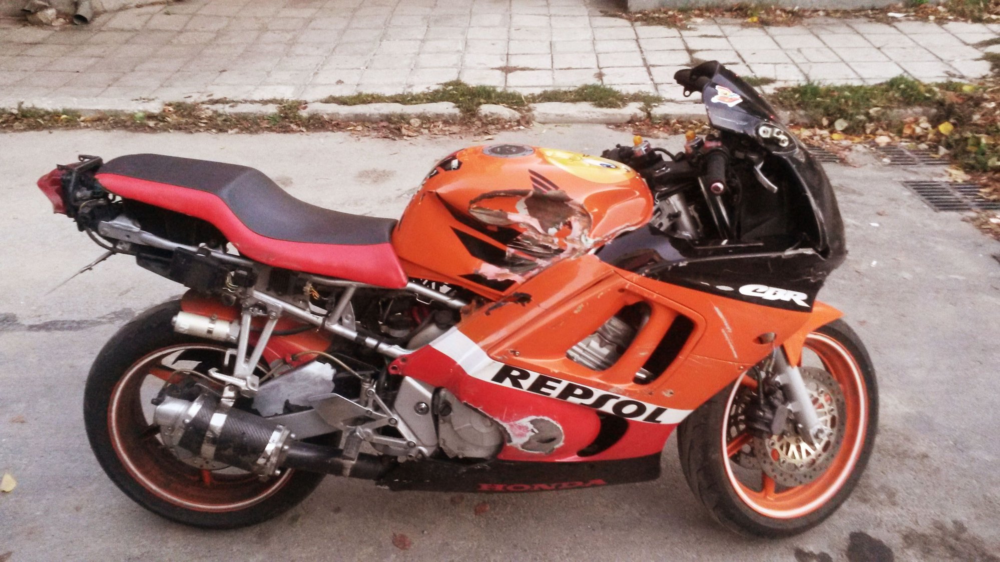

And some pictures of my previous CBR F3
It looked like that when i bought it xD

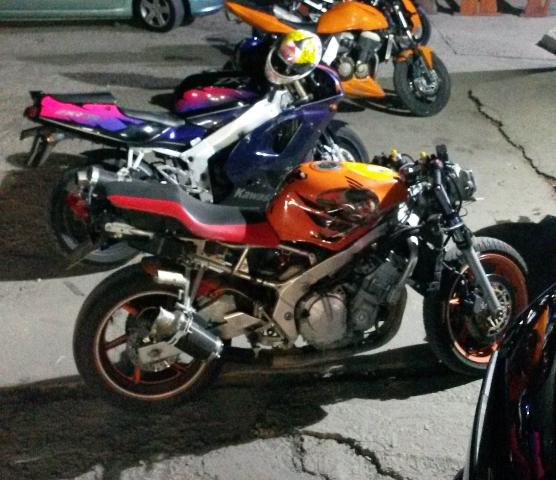

Then for a few months i rode it like that: (people called it "The Terminator" hahah, you see why)

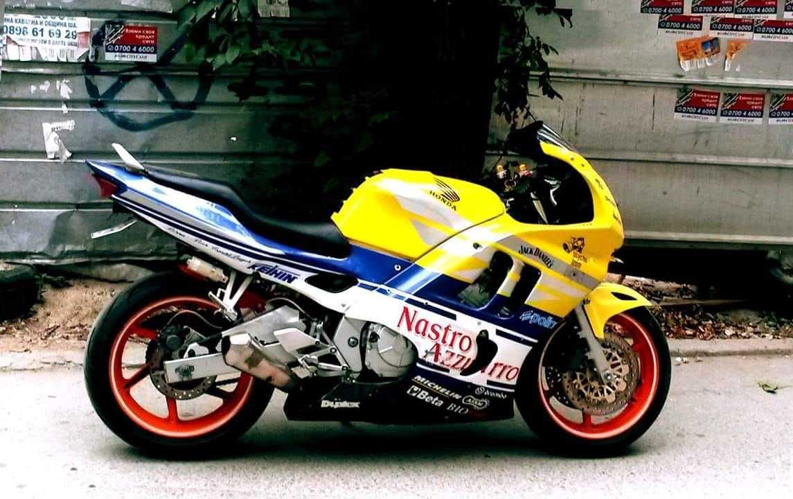

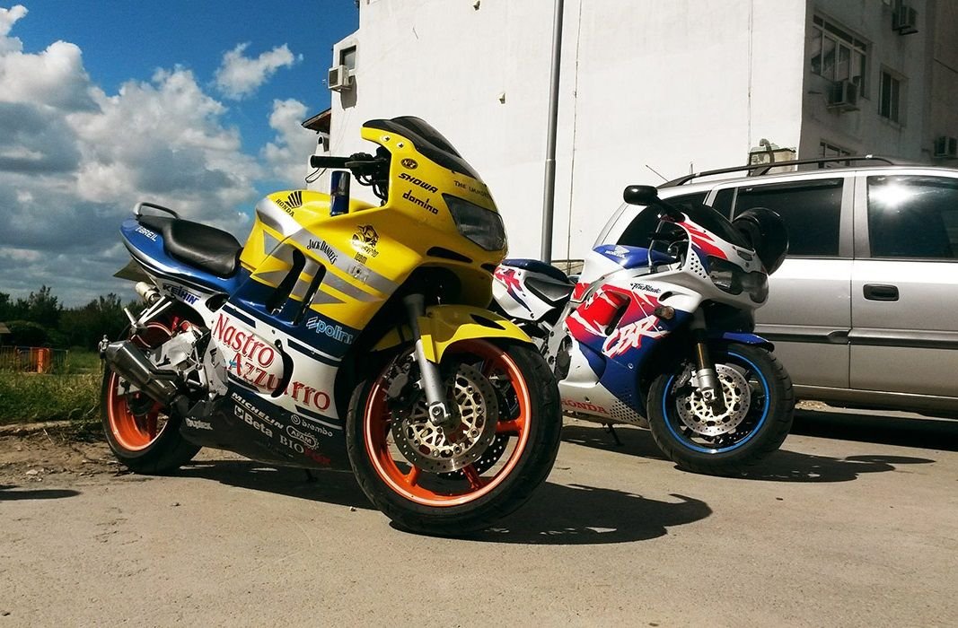

and then finally it became something beautiful
Until I ... well I had to sell it this winter ... because moneyS
