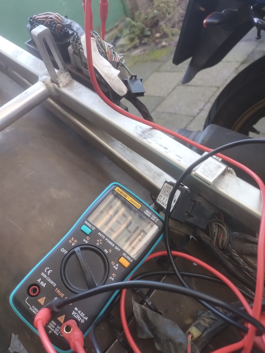

Btw, thank you so much for the TPS tip. Finally got some time during daylight, and would you have it, TPS at wide open isn't fully "open".
Sensor reading at WOT: only 4.34V
Sensor reference voltage: very close to 5v.
