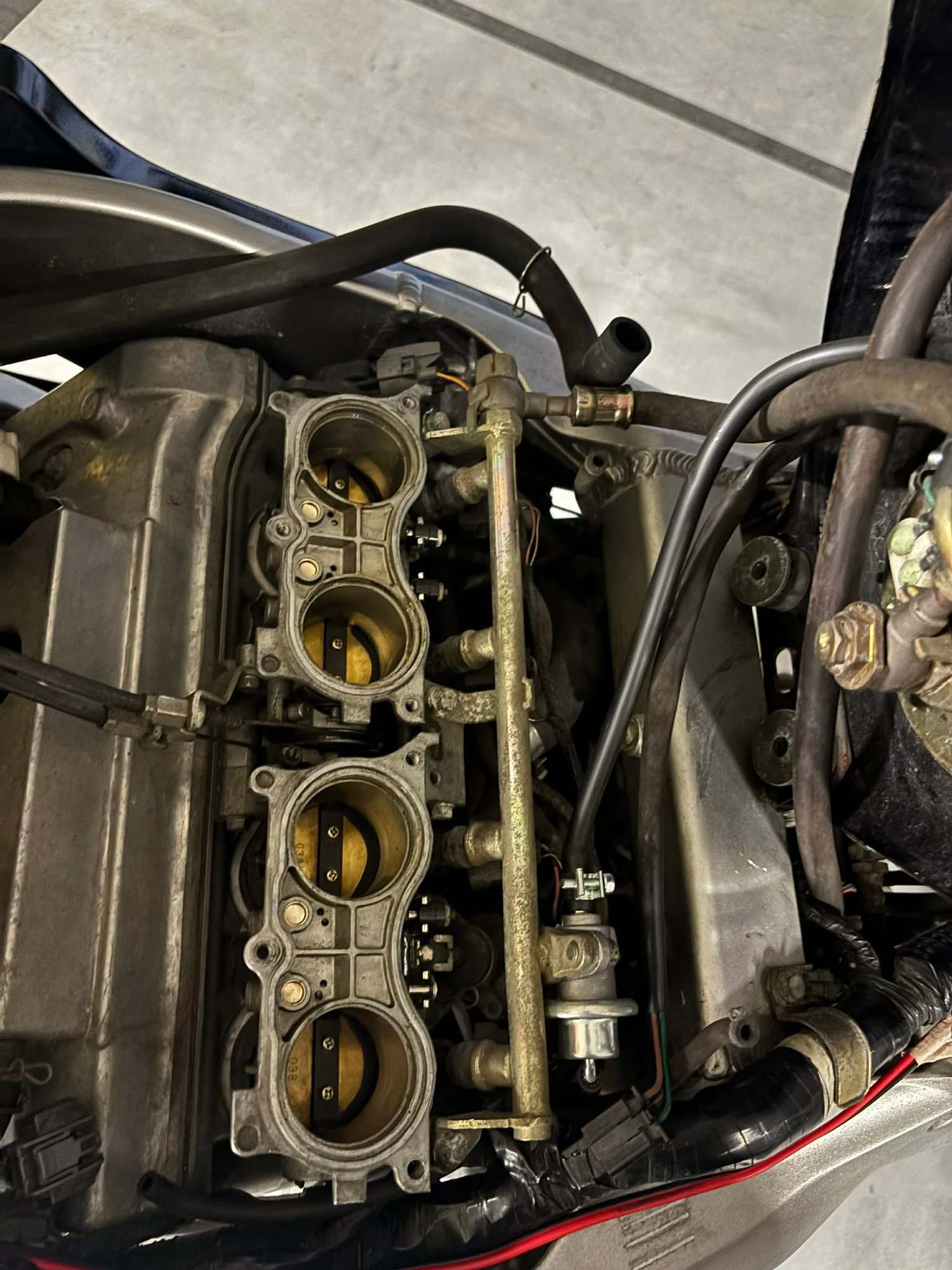

update: I took a proper look at my vacuum lines and they are pretty cracked / stiff and old. Ordered some replacement (3.5mm ID 7.5mm OD fuel lines apparently), and will replace and probably re-sync my throttle bodies once everything is in.

How thoroughly did you check the vacuum on yours? About half my vacuum lines looked fine but were cracked on the inside, and I think all it takes is one of 5 hoses between manifold and MAP to throw it off.
