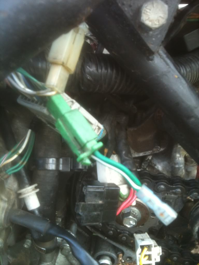

There are jumper wires on the harness also, I'm guessing to bypass the has sensor and kick stand sensor.
Green/white & green/red

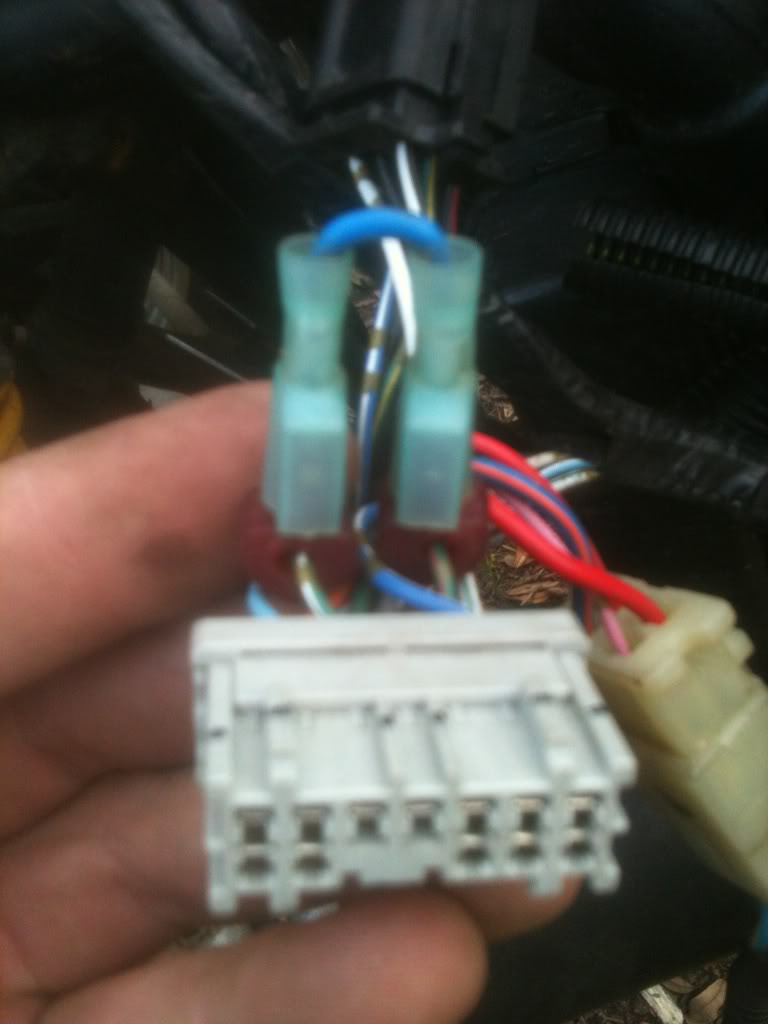

Red/white & green
I think this is kick stand safety bypassed..
