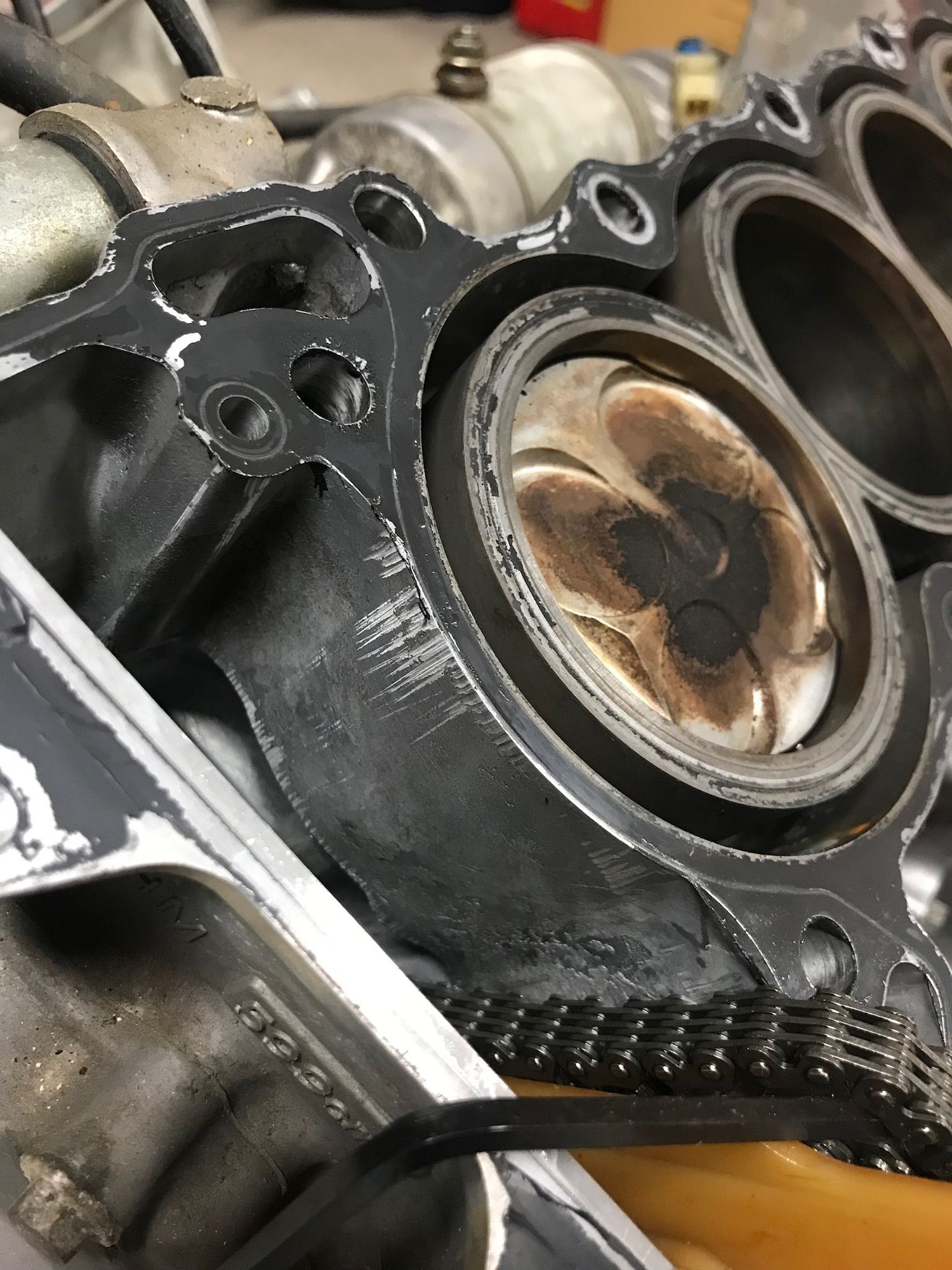

I ran out of time when I pulled the head so I didn't have a chance to thoroughly check them out, but a couple quick checks with the straight edge looked good. I plan to check them out more thoroughly when I have time. Anybody know a good way to clean the excessive carbon off the pistons without removing them?

WD-40 and a Scotchbrite pad.

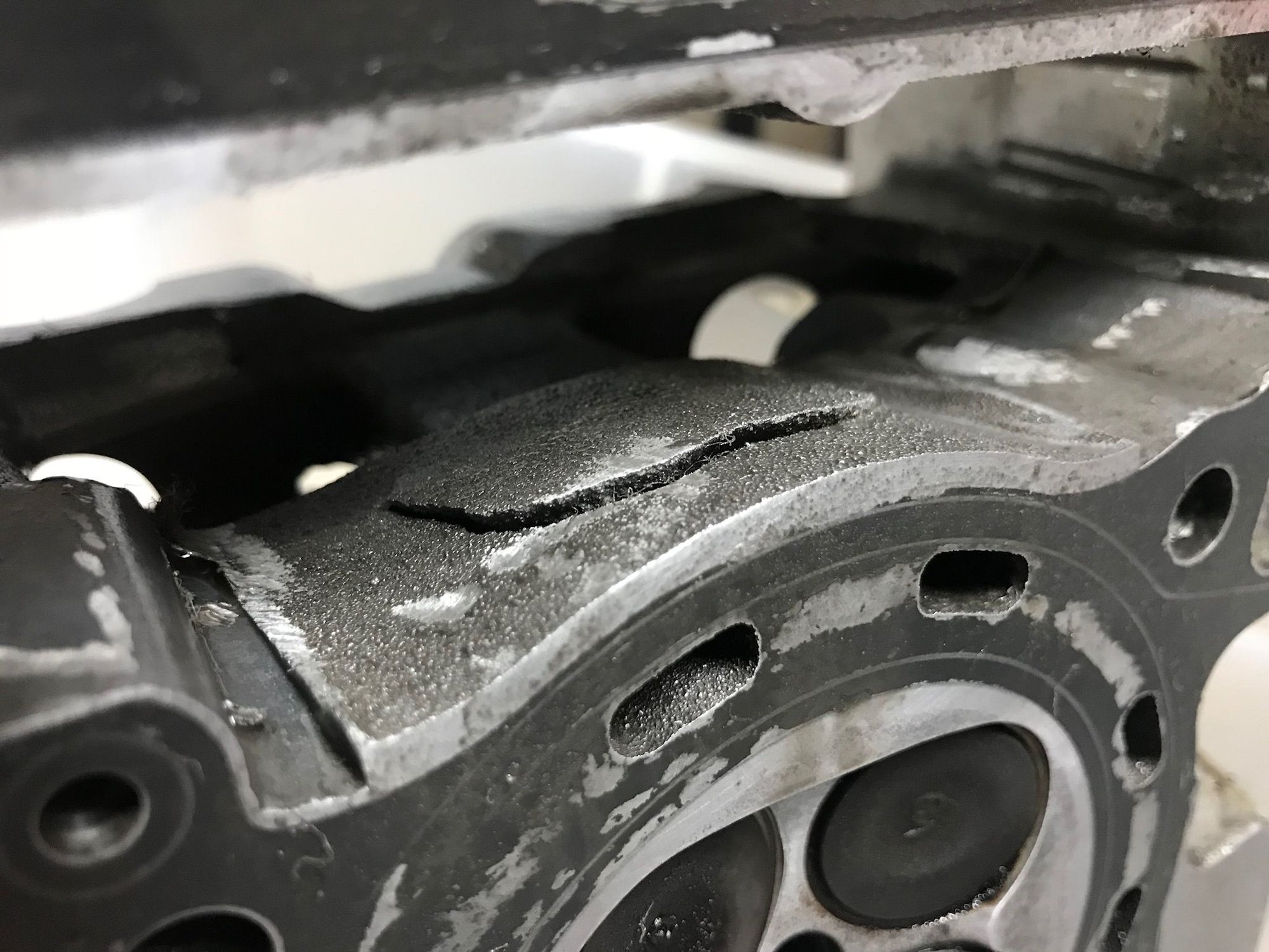

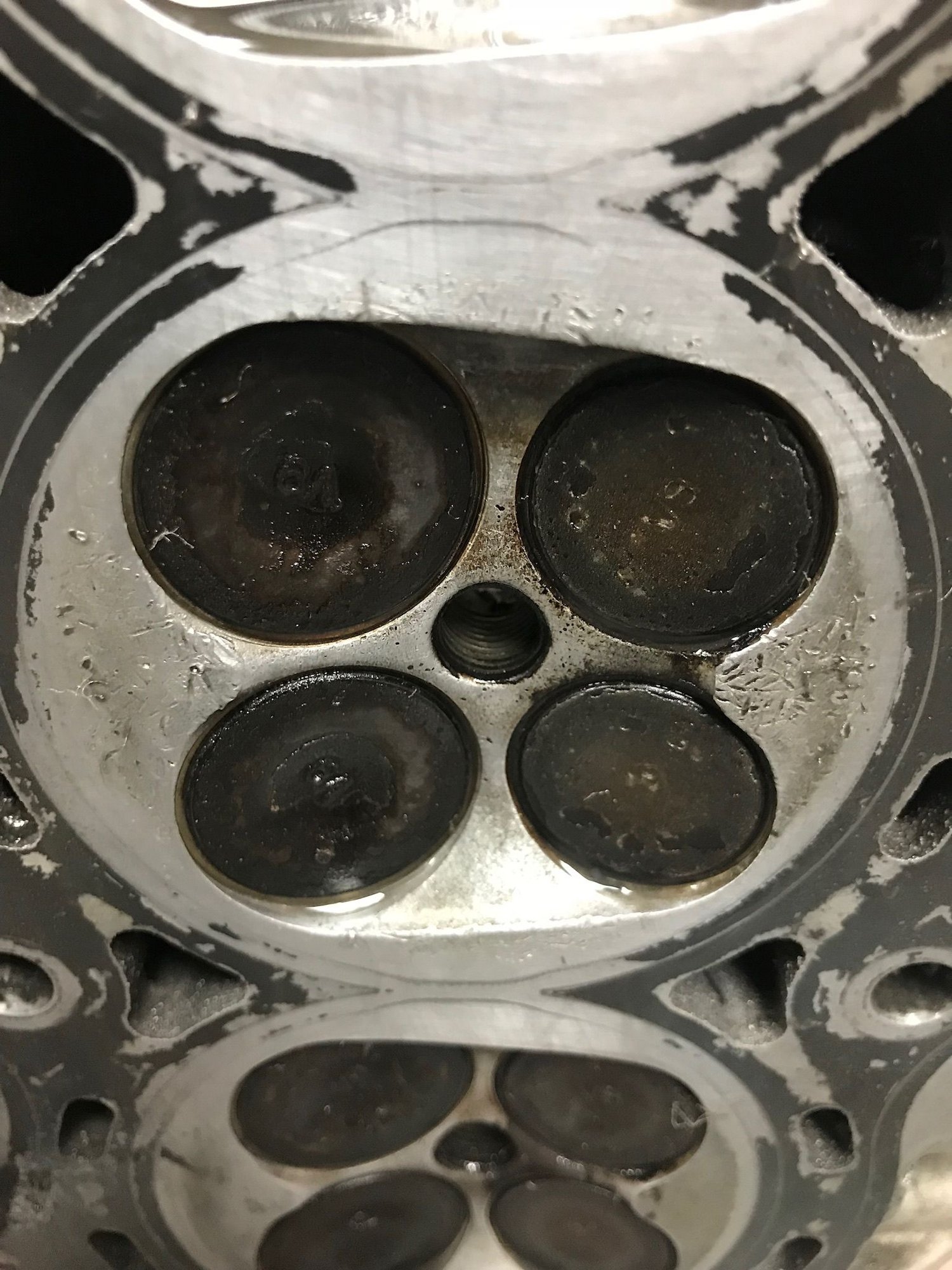

Had some time to clean up the head and take a closer look today, removed some carbon build up and noticed some marring around the #2 cylinder.
Then noticed this guy in the cam chain recess on the side of cylinder #4. I'm no expert, but that doesn't look normal to me...
Also noticed a lot of marks that appear to have come from the cam chain, is that typical?

Is that a crack in the head that goes right into the cooling jacket?

Wow. That motor is fu%@ed. Bummer. So sorry man.
Yes, I believe it is. I need to try pouring some water into the cooling jacket to see if it comes out there. What would cause that???
Can I throw on a replacement head or am looking at a wasted engine?

Chances are any head you buy will be attached to a motor already. And as long as you buy from a trustworthy source, that's a good thing. Considering what I see there, I'd have a rough time trusting anything on that bottom end. One good solid chunk of crud making its way to a rod or crank bearing and you'll be doing this all over again.
