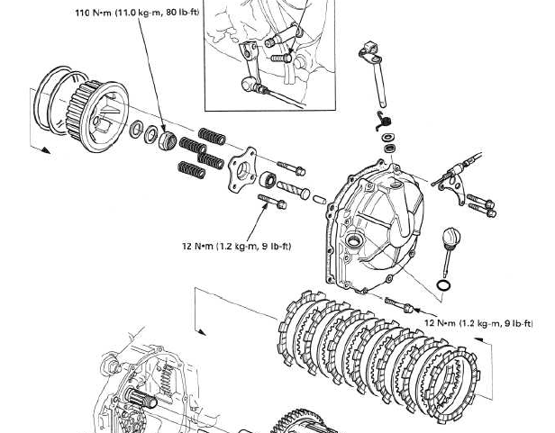

How tight should I have the clutch spring bolts? They are the 10 mm ones that hold the clutch springs in?

Here ya go.
