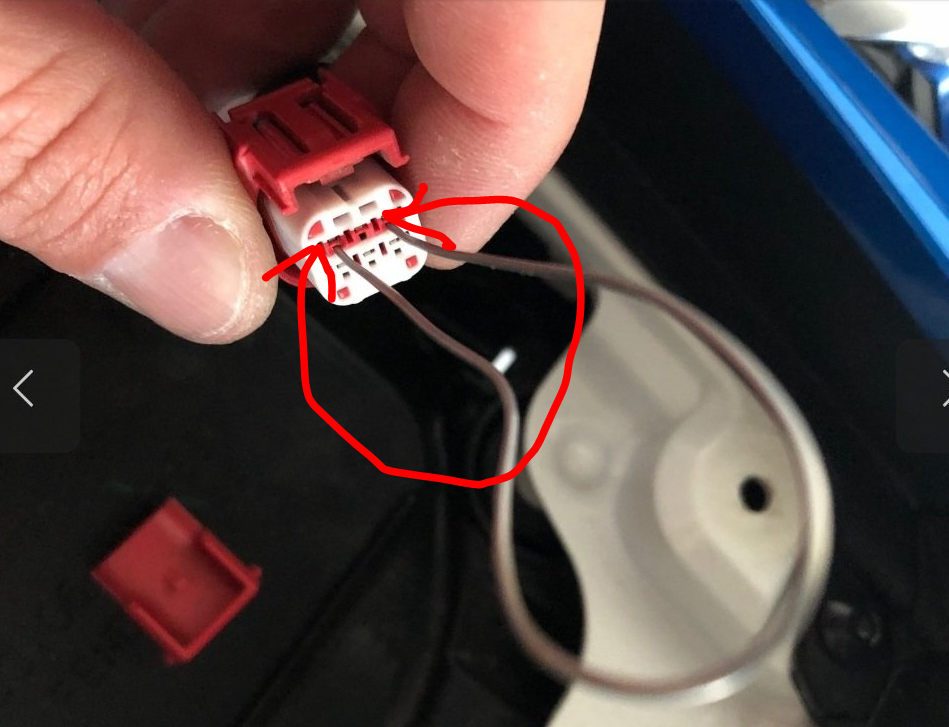

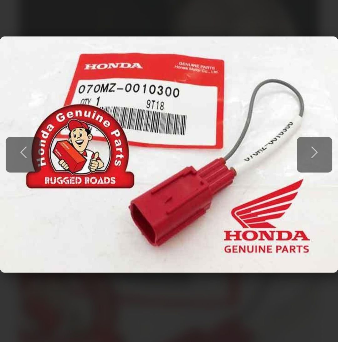

Think this is what I need
Old Jun 10, 2022 | 05:09 PM
No you don't unless this is not an actual picture of the one that fits your model. What does the inside of your connector look like ? You just need to jump those same pins. A paperclip from pin 1 to 3 or pin 4 to 6 or however it's numbered.
Old Jun 10, 2022 | 05:12 PM
There is usually a specific procedure, like it has to be in Neutral and the Kickstand in the down position before it will display the codes.
