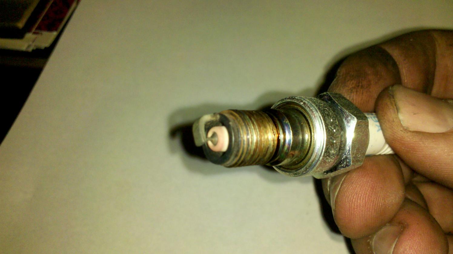

pics of plug...
took off exhaust nothing to report there....

Originally Posted by e3gordon
pics of plug...
one looks alright, second one makes me think bad rings. Seems to be it is covered in oil... And definitely rich. Though probably because the oil is preventing spark which could do the off sound and issues with electrical if it fires but takes more power... But... That is only from that plug and the glancing I got from this thread.
