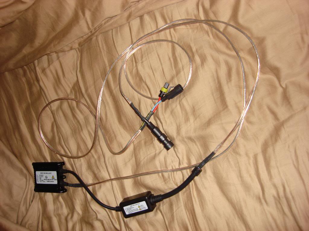

- Speaker wire (or some type of wire, I used some 16ga I got at work)
- Access to solder
I can't take credit for all the work, as my roomie helped, but regardless, it was very easy to do.

Plugged everything in as usual.

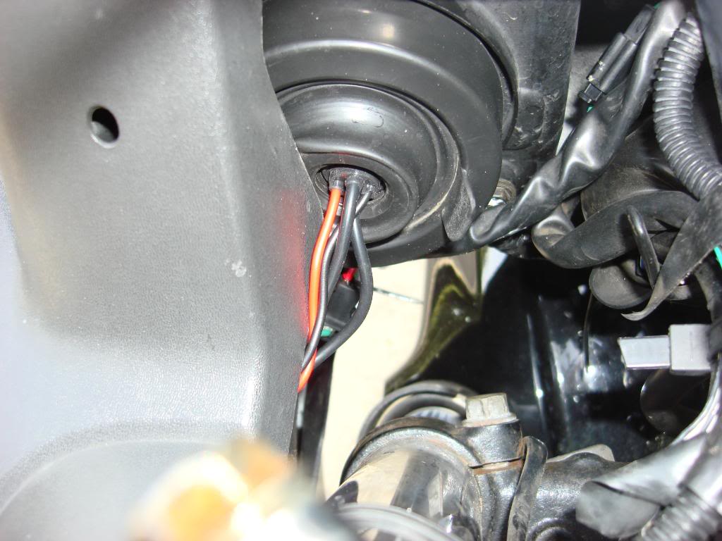

Ran the wires underneath the gas tank, and left some slack just in case.
Temporary mounting points, until I get the high-beam in. Also, I ran the wires underneath the main seat, and again, left some slack.

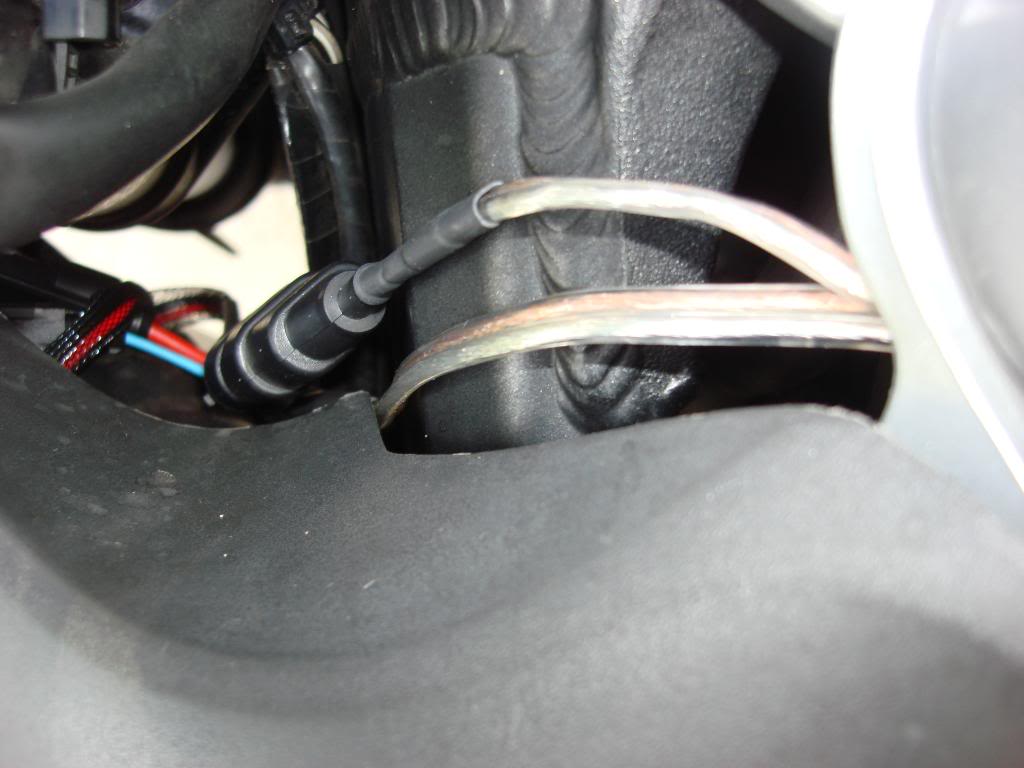

High beam, pre-installation. Didn't have the chance to put it in because the weather turned sour, but if anything, it gives a good idea of how we did it.

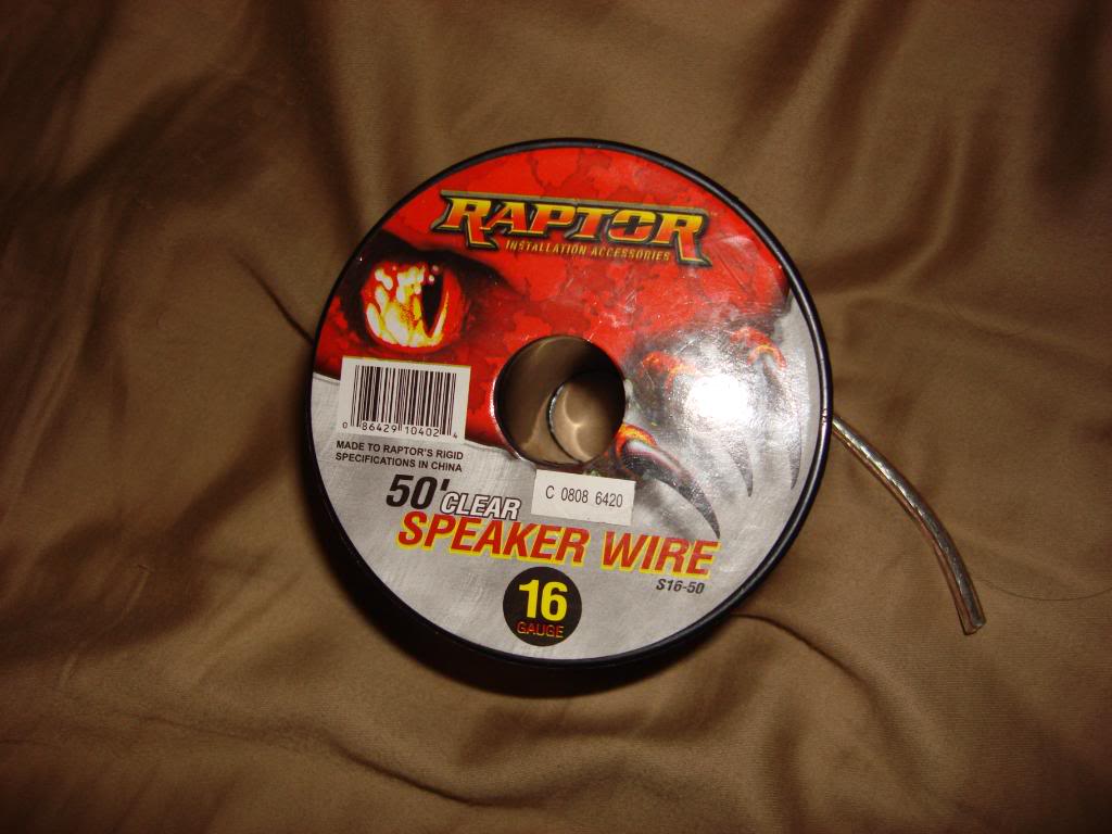

The wire used.
The wire used.
