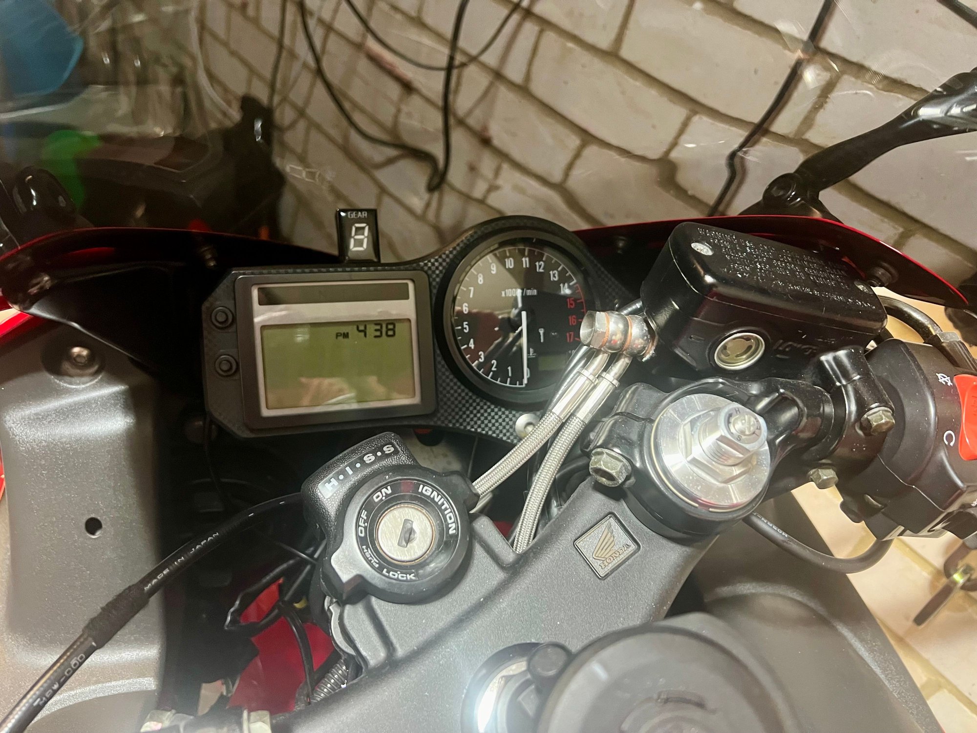

I mounted the indicator just above the clocks - see pic (which I took before putting the screen back in place).

1) The readout is too bright for night time use - this was always my biggest fear. However, I had a sample of 'limo grade' window tinting film and I've mounted that on top of the unit and that has really helped. The only problem is that it is a very glossy finish and can reflect. If I can find a matt finished piece then that would be better. I may even try sanding it slightly to take the gloss off it with a fine piece of wet & dry.

Quick update - the glossy finish was annoying me so I took another piece of window tinting film and made it matt using 2000 grit wet & dry.
I'm happier with it now.

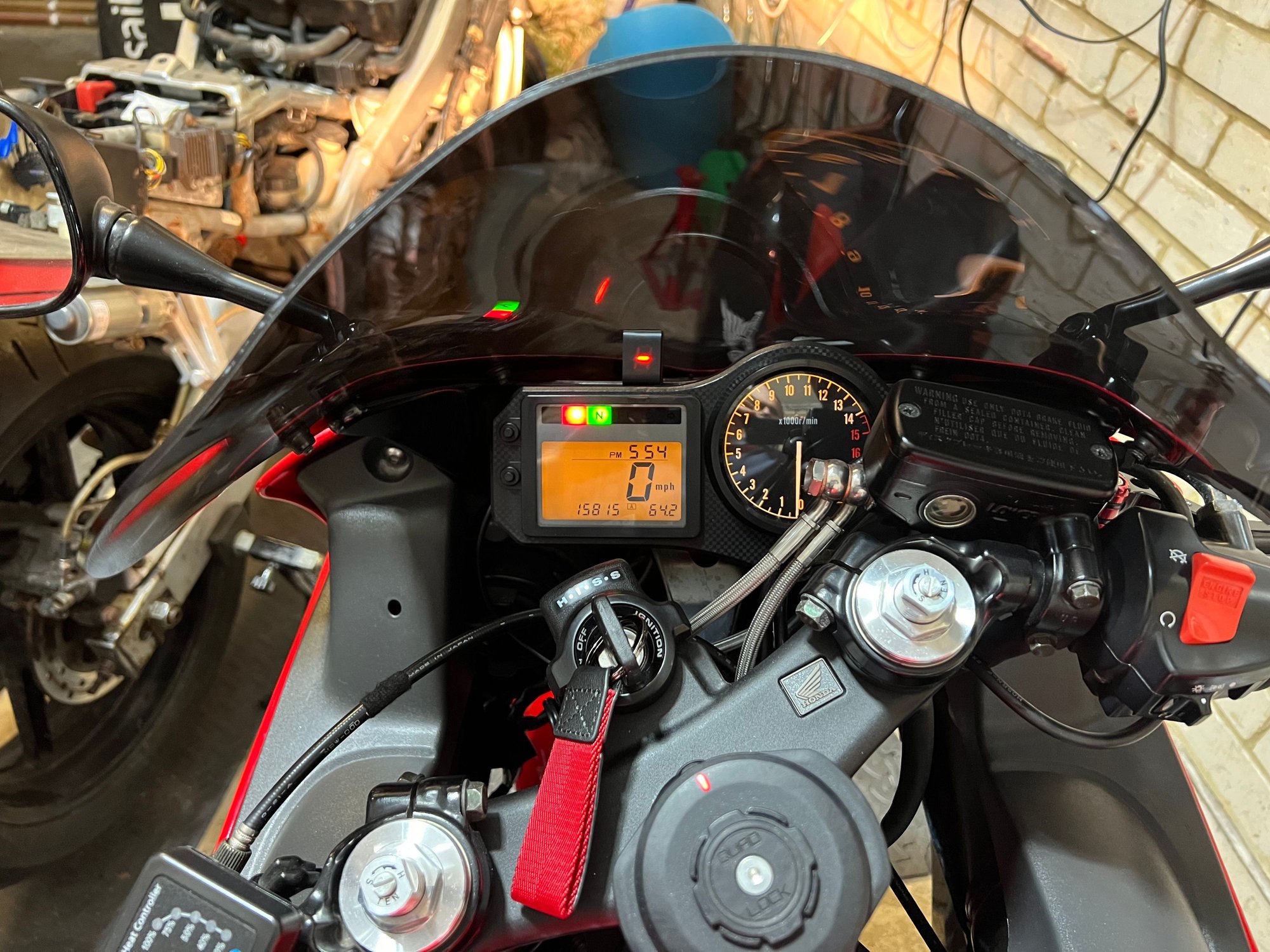

Just one more thing. I mounted it on a small piece of thin stiff plastic that’s approximately 60mm x 20mm.
The first 40mm is attached with double sided 3M tape to the bracket that sits under the gauges (it’s obvious once you have the screen off).
The remaining 20mm sticks up above the gauges. The gear indicator is then stuck on top of that - again using the 3M double sided tape.
