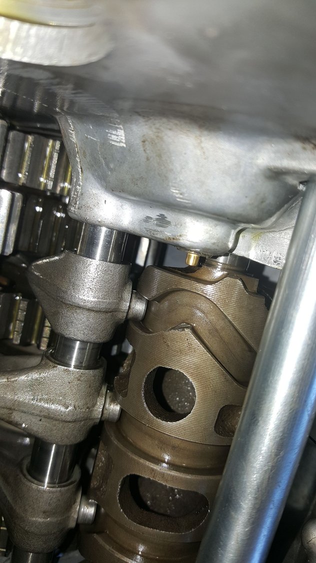

Default Its been a while since last post but would this be the cause of 2nd gear kicking
Gouge on shift drum

Old Feb 27, 2019 | 01:10 AM
CaBaRet's Avatar
Joined: Oct 2016
Posts: 2,519
Likes: 8
From: Lancs ,UK
Probably so, looks like Fork has cut across that corner , best to take it out and check forks too
