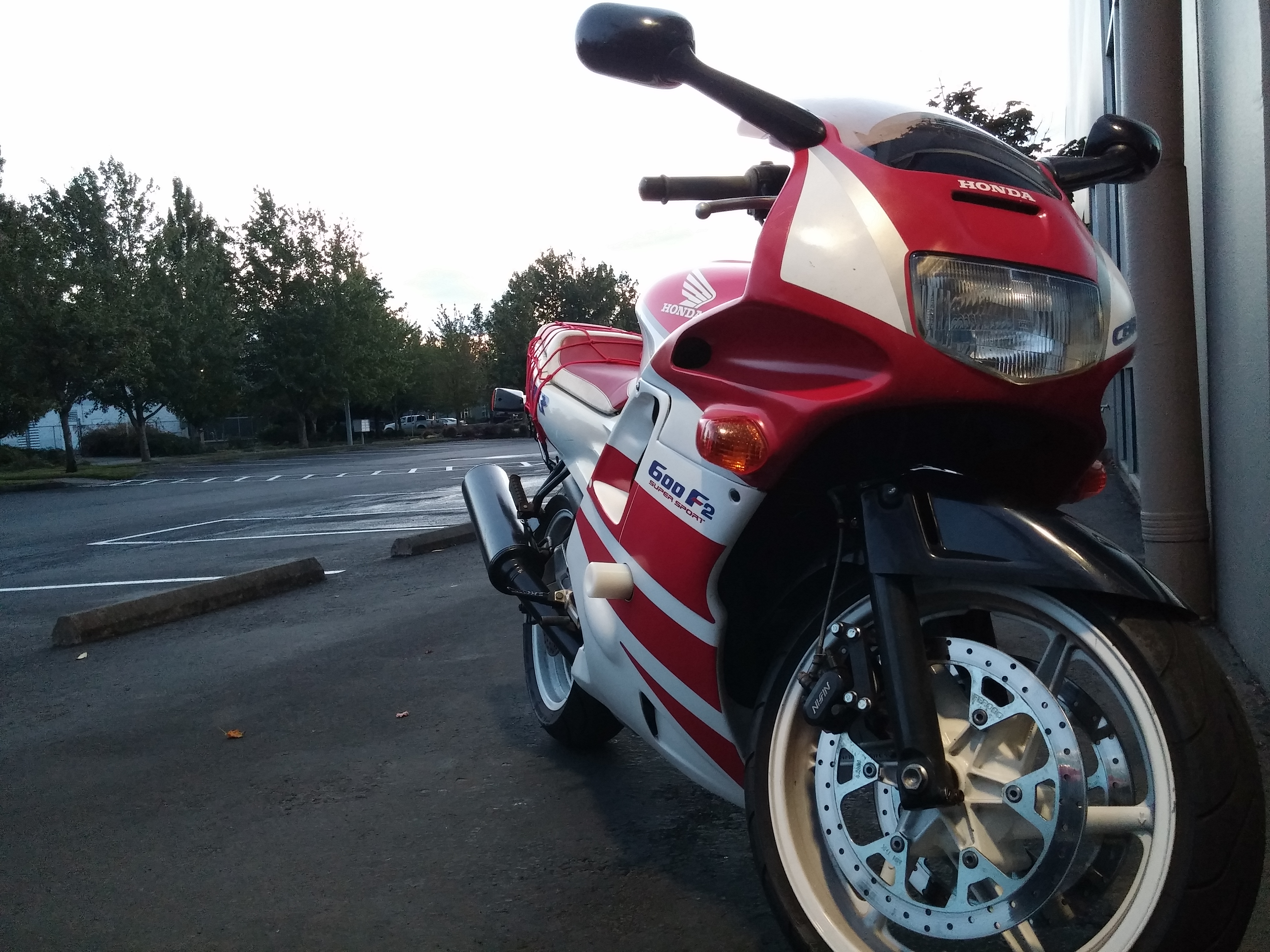

I have the Ferodo brackets on my 91 f2 and I'm going to see if one of the CNC programmers where I work can translate them into a usable file.
I'll keep all y'all updated with the progress.

Indeed, thank you!
Lovely F2, looks just like mine ('cept the black front fender). Seems Honda didn't think the Ross White F2 would sell that well in the US, and didn't import that many of them. I lived in Boise at the time, and had to go to Salt Lake City to grab my white F2.
