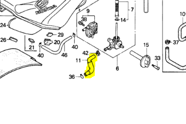

Hey all,
I just bought a 1993 CBR 600F2 and I am giving it the once over. The hose that connects the tank to the carbs is bad and the part has been discontinued. Part#16955-MV9-000. Can anyone tell me what you are using to replace this hose?
Thanks

Take the old hose to an auto parts store. They will match up the inside and outside diameters and cut you a length. The factory pre-formed, cut to length hose is nice but not required. You should get out of there very inexpensively.

Thanks for that. I will if I have to, but was hoping that there was a cross reference to something else. Want to keep everything original. Its a 1993 with 1300 KMS on it.

I get that. Ebay or some other place may be your friend. It did make me think, "I wonder how they bend the OEM hose?"
I found this. It might be helpful. It won't be OEM, but it will give you the look of OEM, with a hose made in 2024.
Link

That is Awesome. I never thought about that. Thanks, I think I will give that a try.
