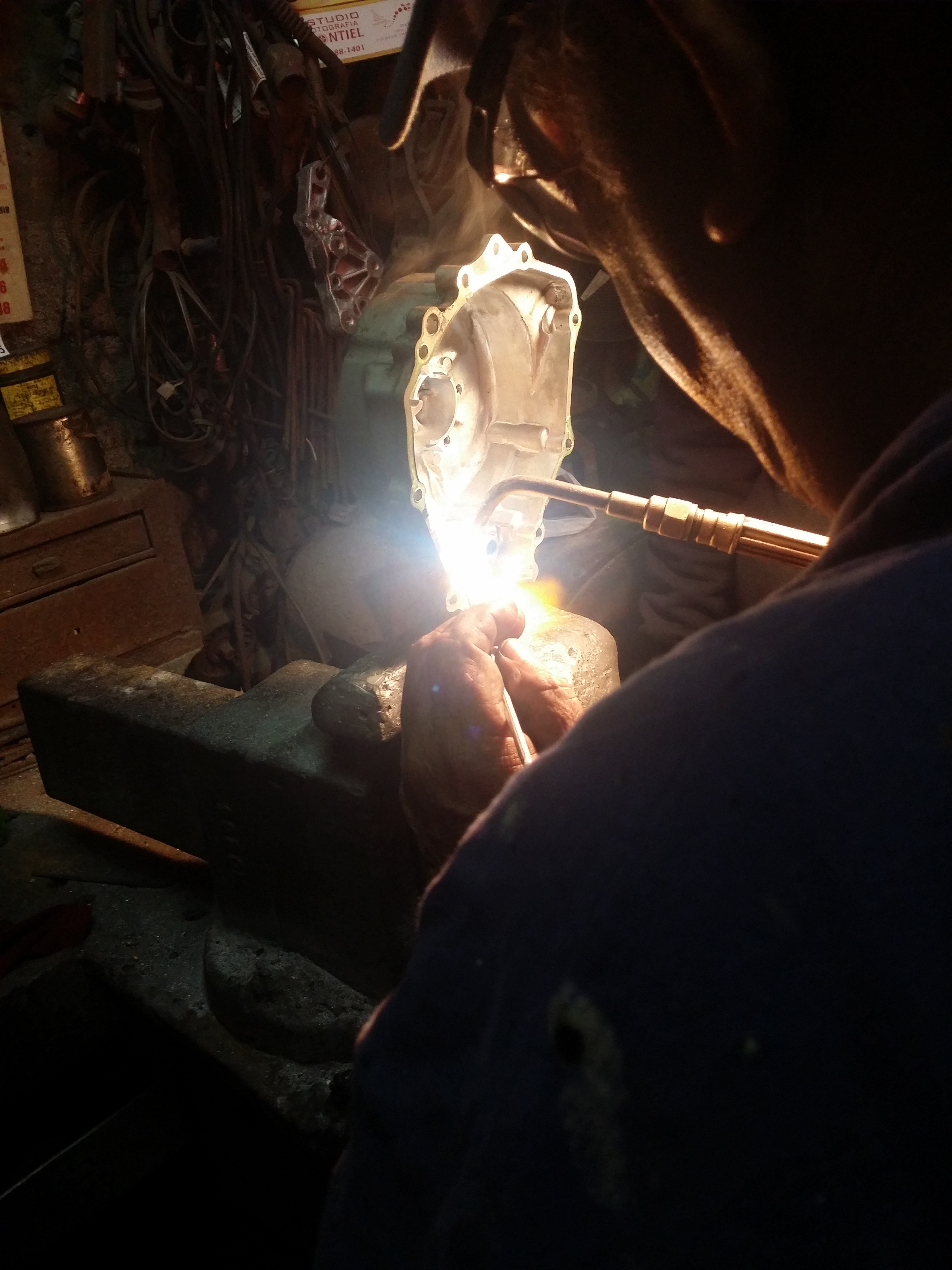

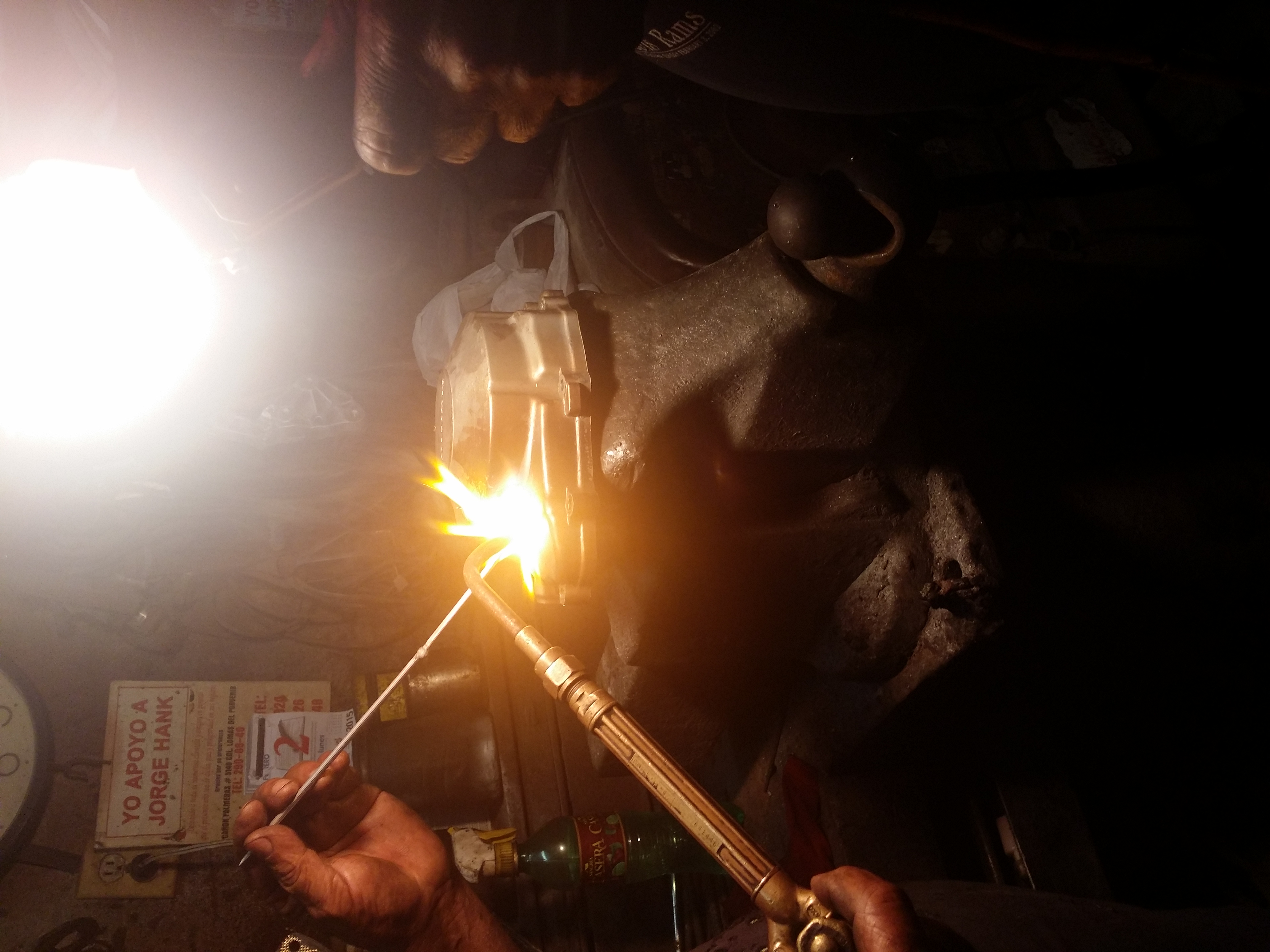

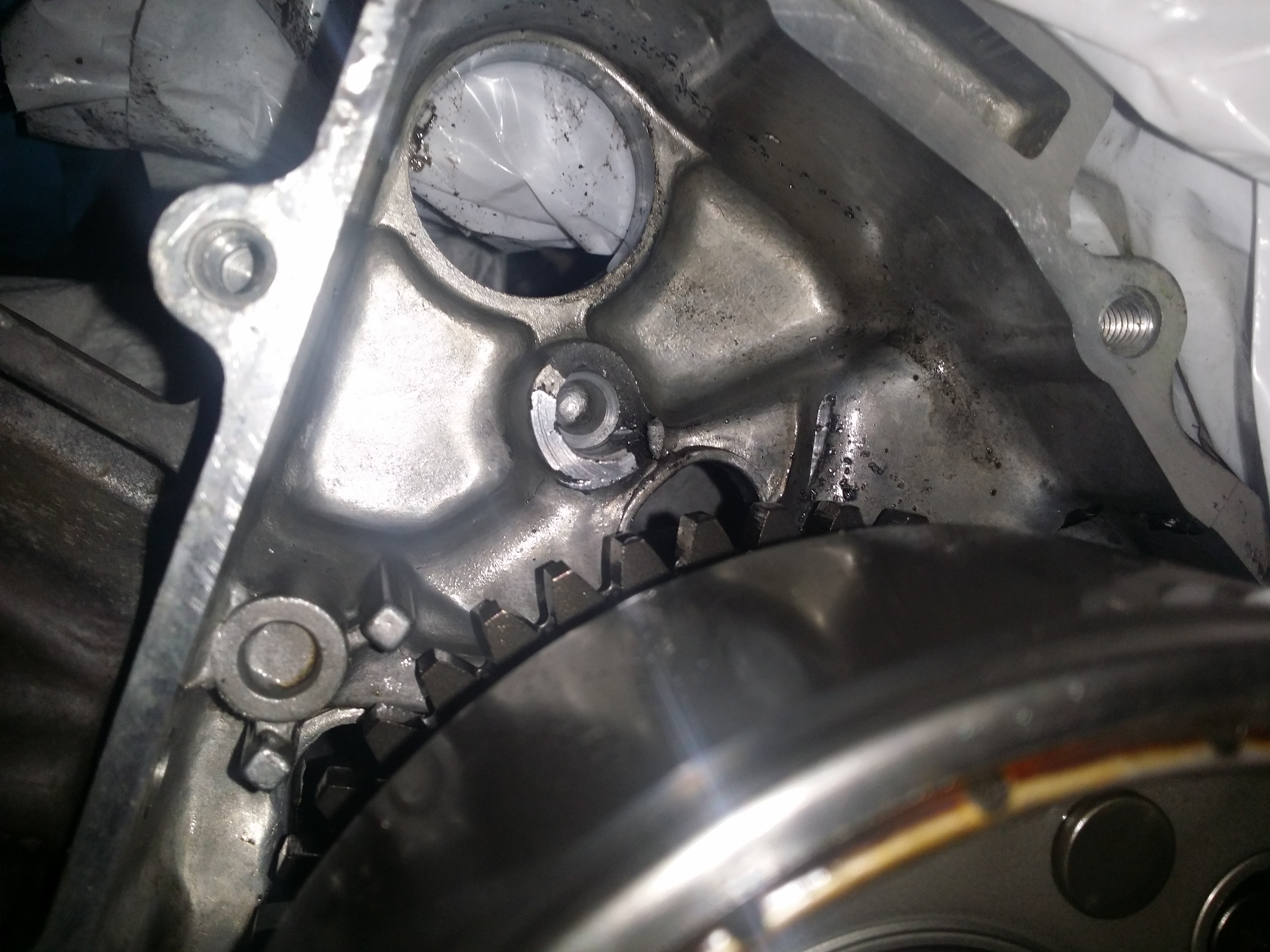

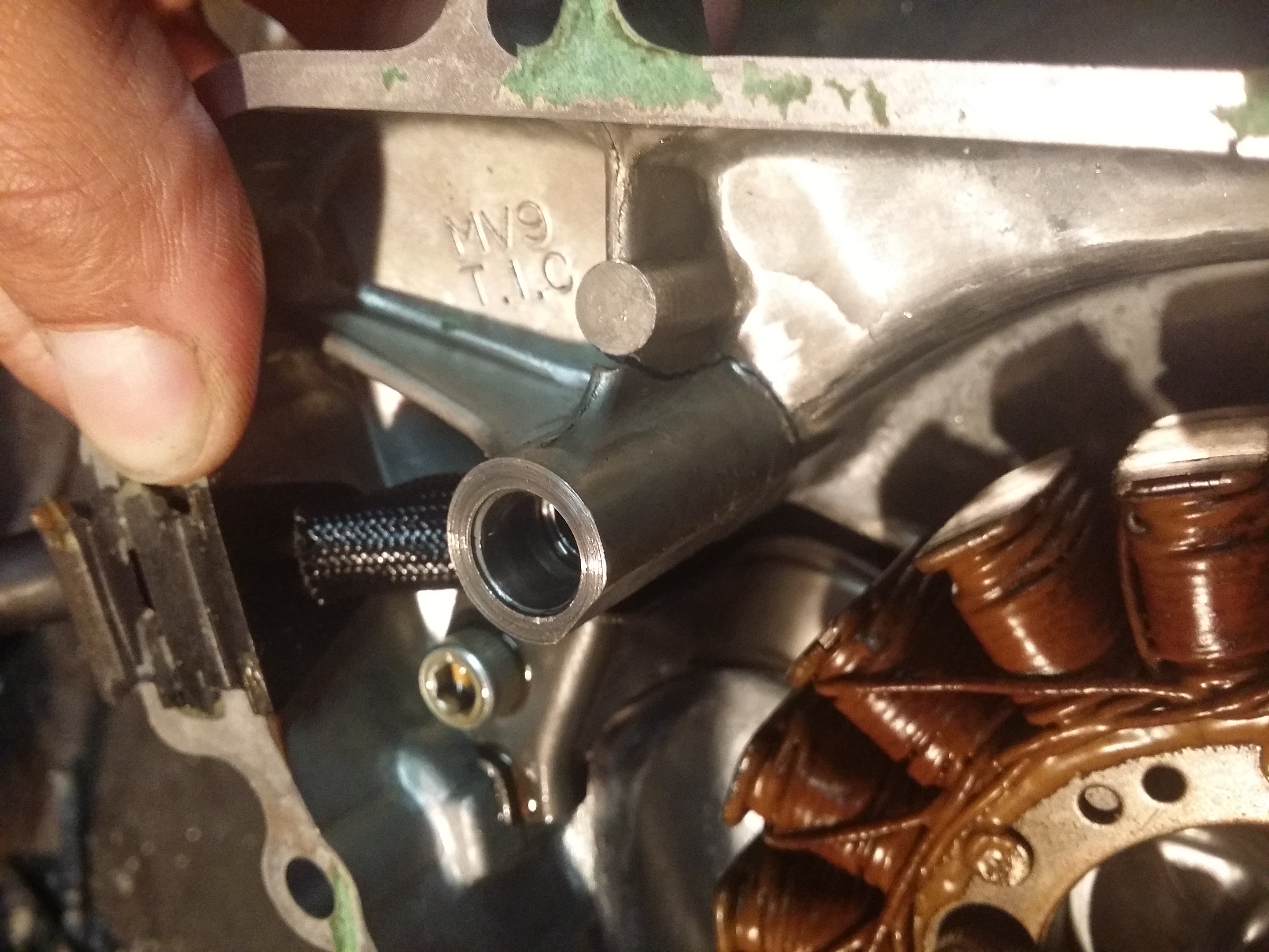

I had this issue once, but I don't exactly know what went wrong with yours compared to mine so I don't know if my suggestion will work. I f'ed mine up by forcing the starter back into it's place resulting in that inner dowel braking the left side crank case cover (pic 1, 2 & 4 of damaged areas). If it's similar then you can do this. if not then show some pictures of your problem, maybe there's another way around it we can figure out.
At the time, I lived in mexico so YMMV in regards to prices:

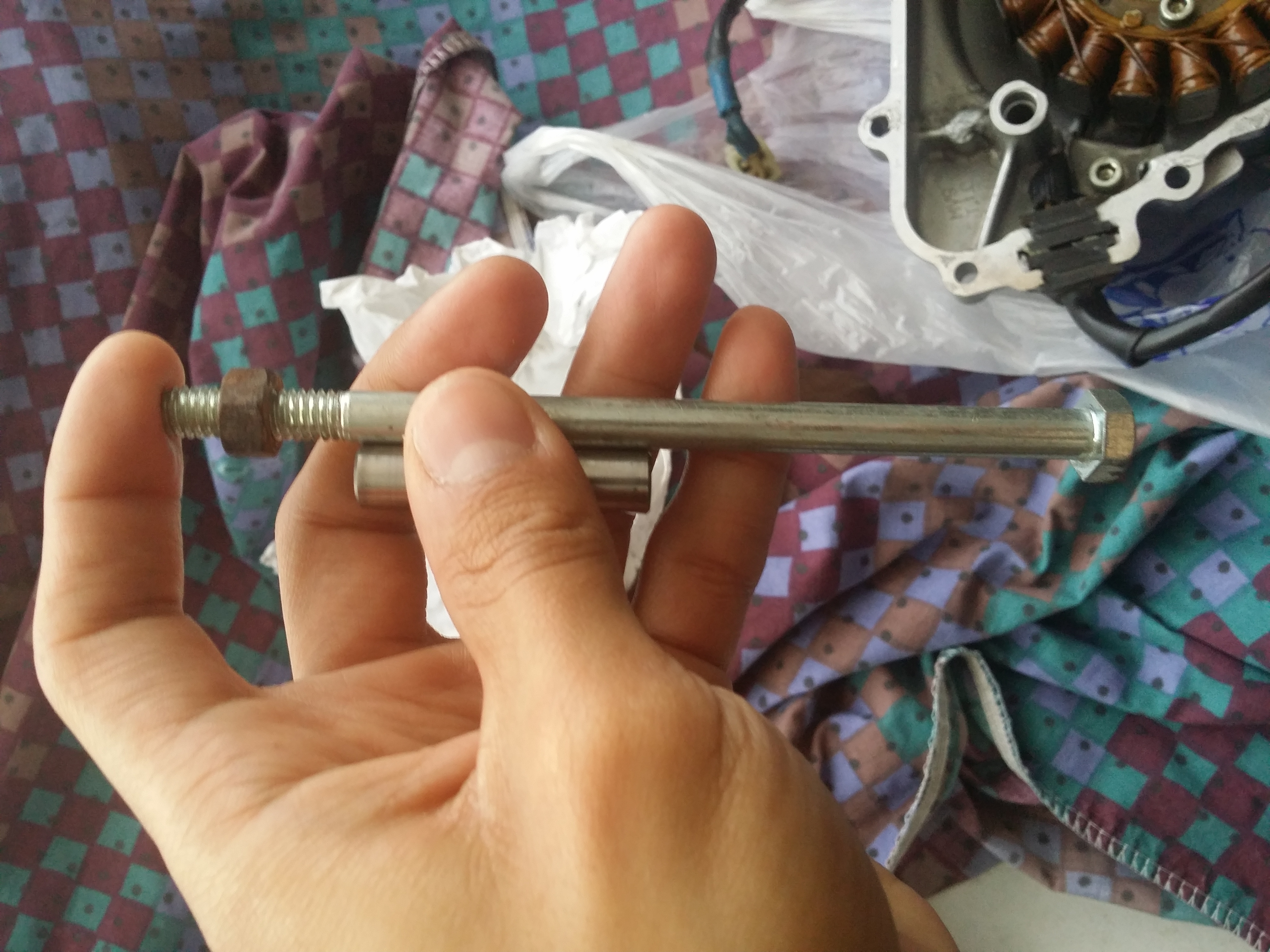

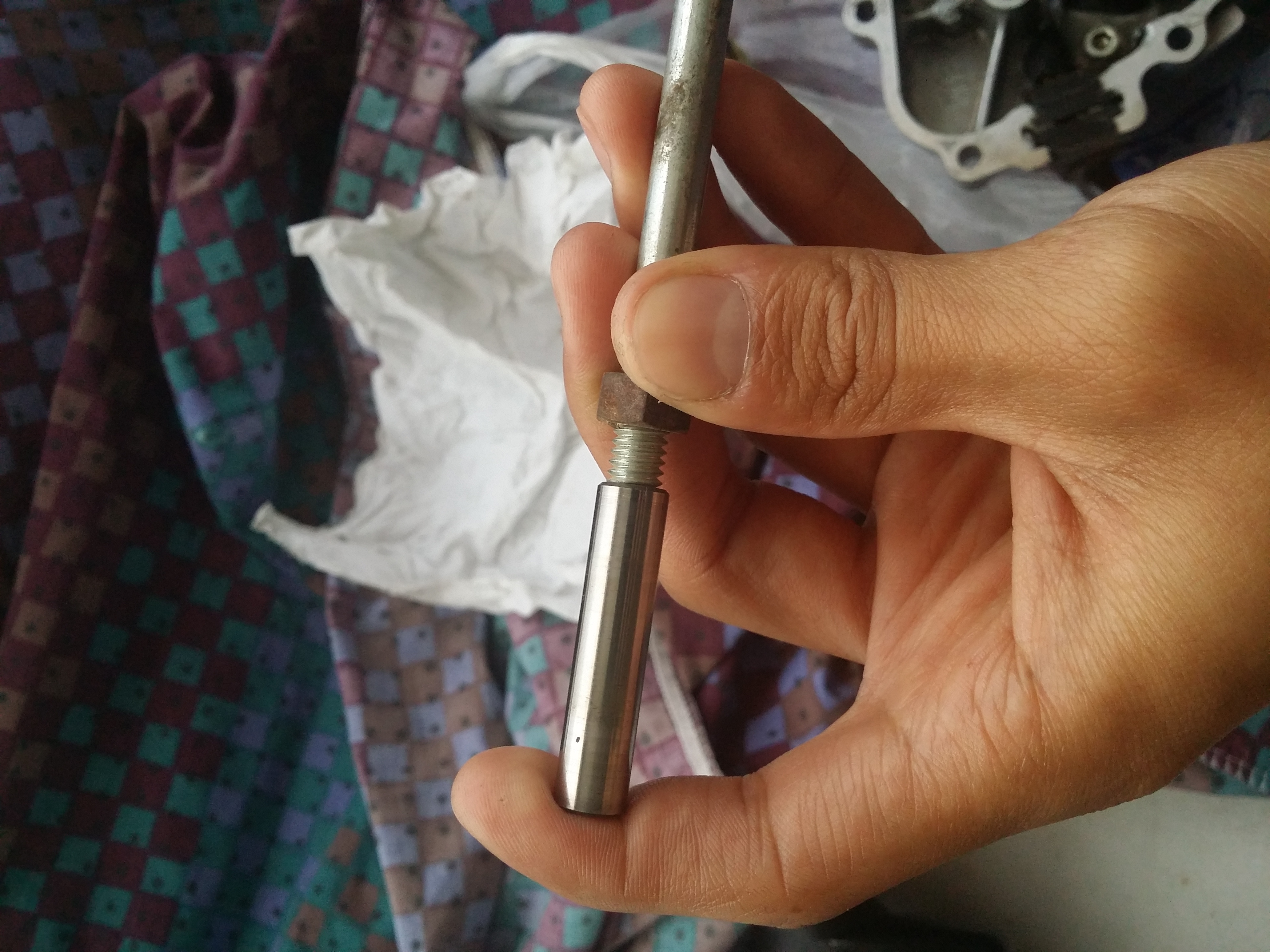

I had the guy aluminum weld it inside and out without obstructing that inner pin/dowel that holds one of the gears linking the starter to the alternator's starting clutch. The pin goes into picture 4 and it's not obstructing the pin in picture 3.1. The pin I'm talking about is part number 28102-ME9-000.
The guy was no pro and did a half decent job at welding it back together, so if I had to do it again I'd just do it myself.

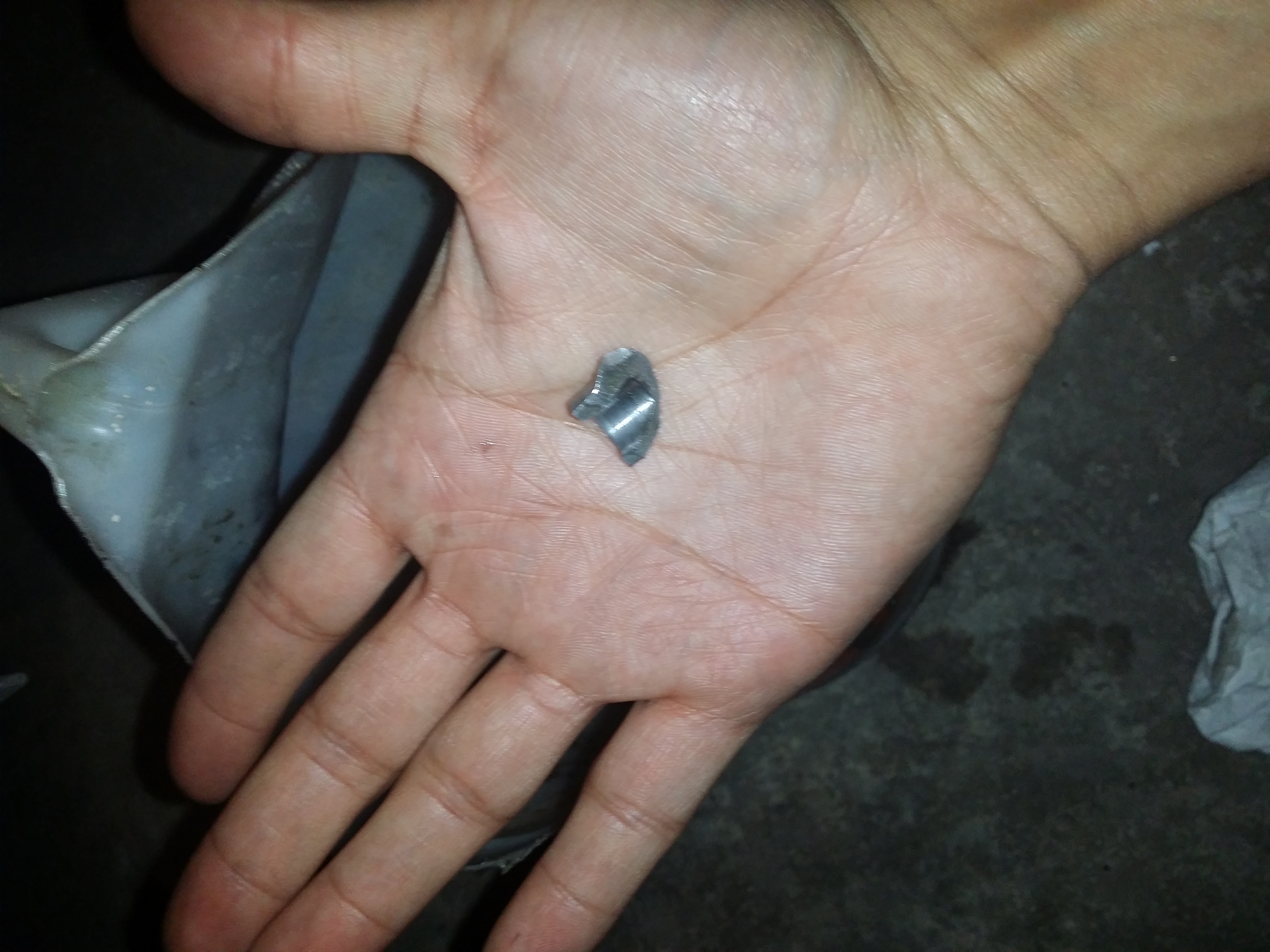

Afterwards I took a bolt just a tad too big to fit the inner diameter of the pin, filed it down to the right size, tapped the engine and threaded it in (since there's really nothing on the other side just an empty space beneath the carbs) and 'lock tight'-ed it in place with the red stuff. Picture 5.0, 5.1 & 5.2 show what I'm talking about. It's not a tapping guide and I don't have pictures of that but if there's anything you need to remember it's "go straight", "go slow", "turn & return" aaaaand "lubricate" & you'll be fine.
Guy charged me aprox. 20 USD and I had the bolt, tap and file in my tools so it really only cost a little bit.
