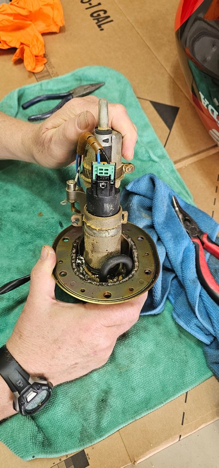

ignition is solid. Tested and 12v were ita supposed to be and 9.1 out of pink wire side of diode.
took tank and removed the pump and assembly.
What a damn mess.
BUT. Now have fuel prime and pressure.
Still no spark.

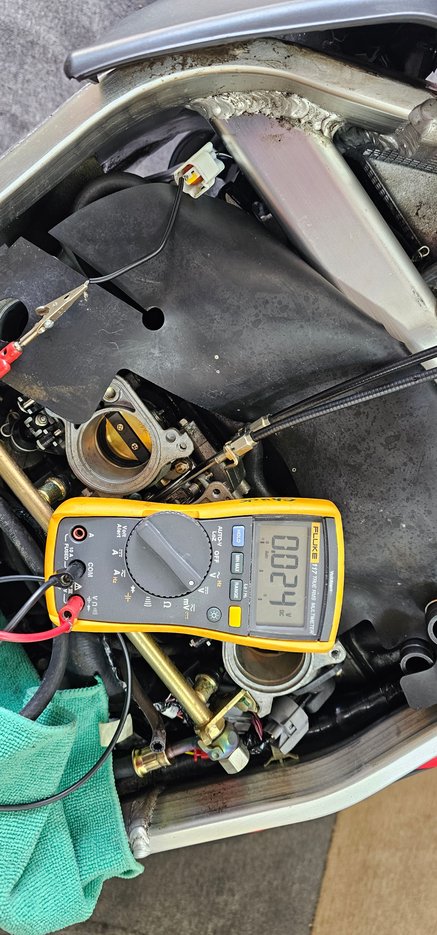

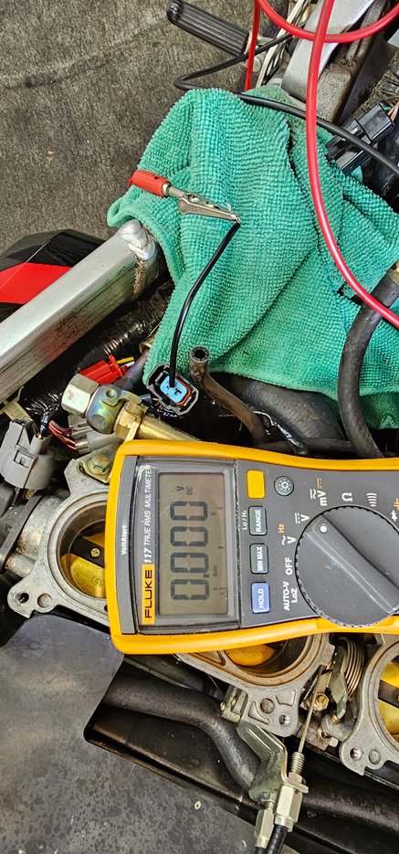

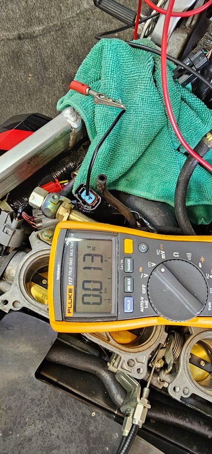

Default Coil Connectors voltage
Originally Posted by dannoxyz
Awesome!!! Fuel-pump prime means both engine-stop & fuel-pump relays are working. So's ECU since it activated pump.
No spark is further downstream. Key ON:
1. disconnect all coil connectors
2. measure voltage at each coil connector, 8 total, volts = ???
the voltage is 0.012 and 0.024 volts. Almost nothing. Key ON. I must have forgot to post those pictures.

Sorry, meant to add start/stop=RUN as well.
Or did you make those measure with switch set to RUN?
