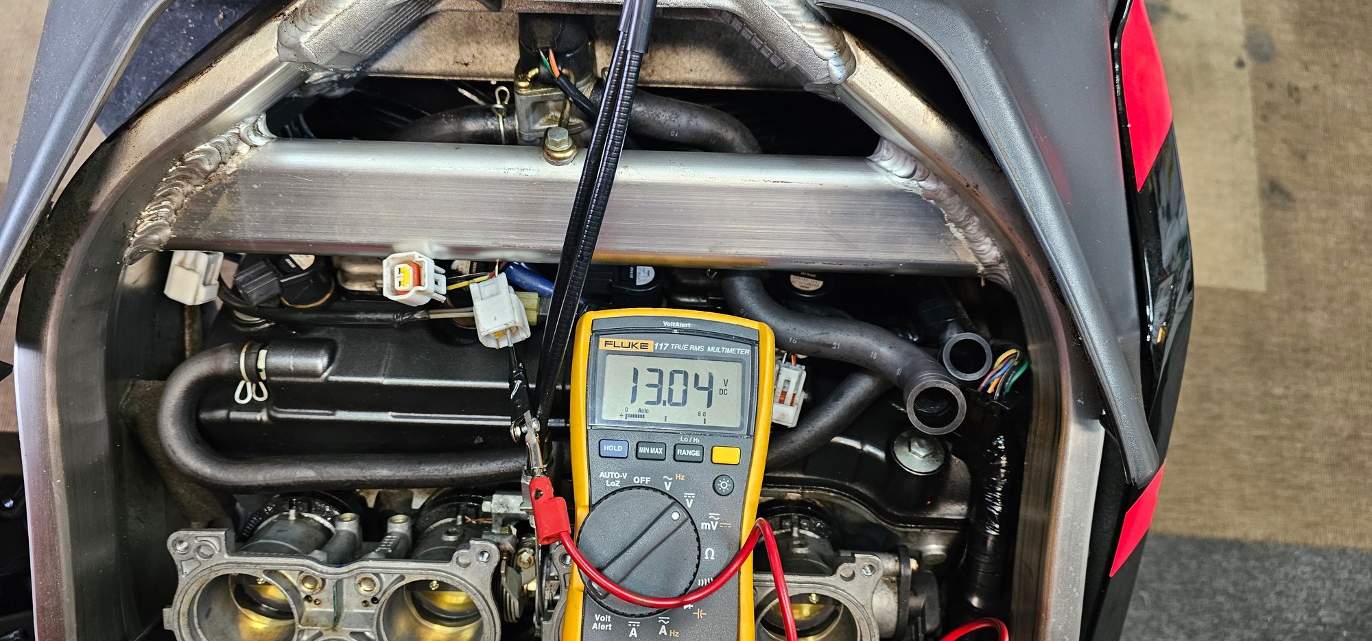

Originally Posted by TLEBEAU75
great question. I don't think I used the switch only the key.

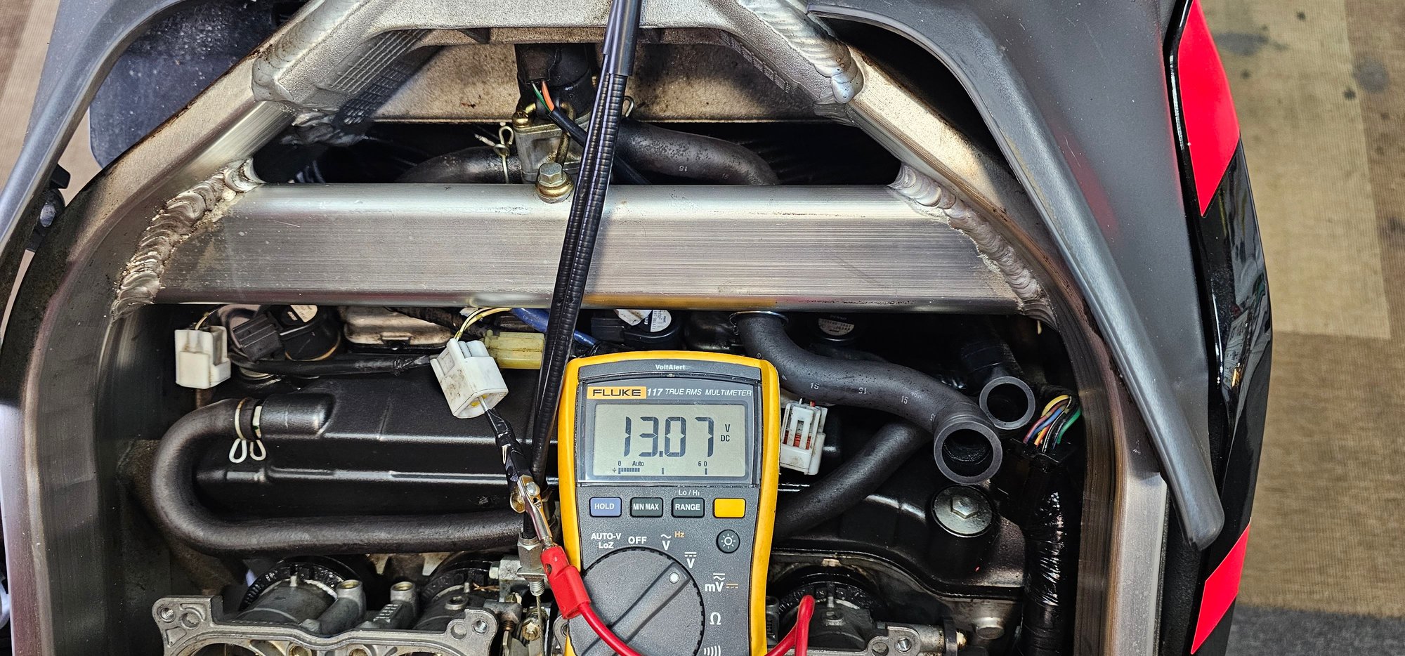

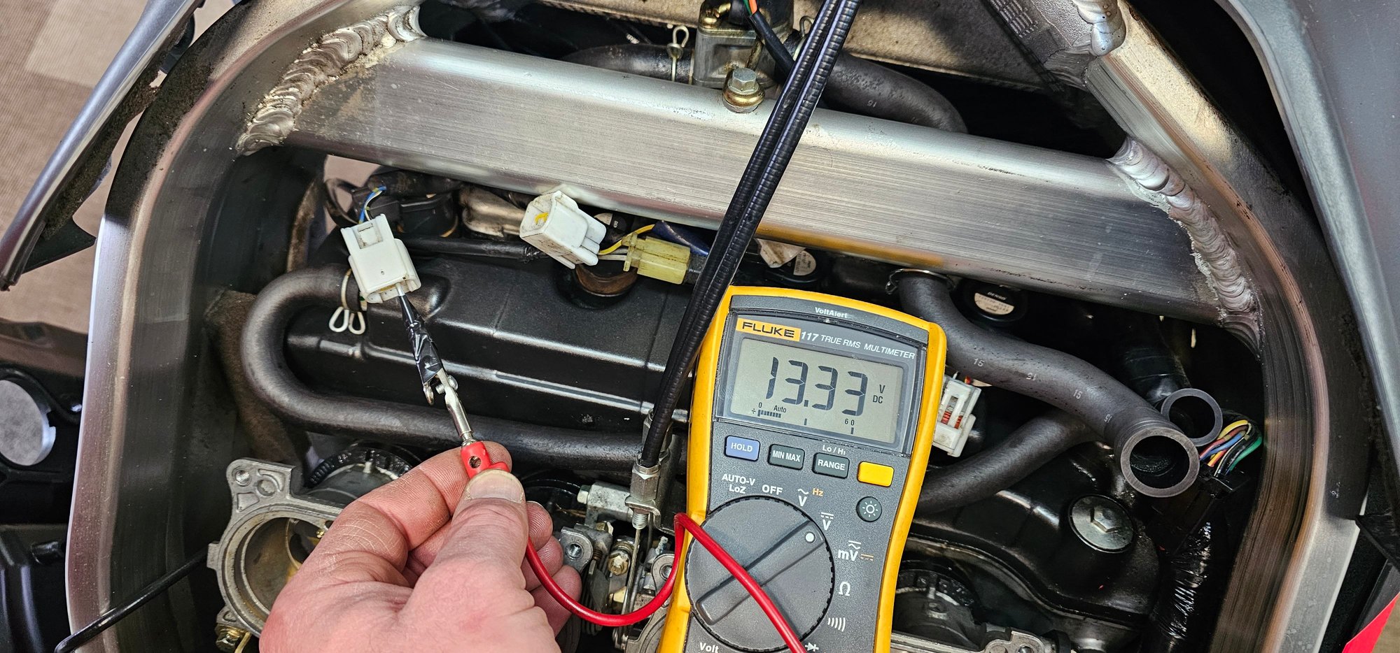

coils getting 13.4 on charger. On and drops to zero when switch is off
Old Apr 29, 2023 | 05:29 PM
  #33
dannoxyz's Avatar
Posts: 1,988
Likes: 439
From: Mesa, AZ

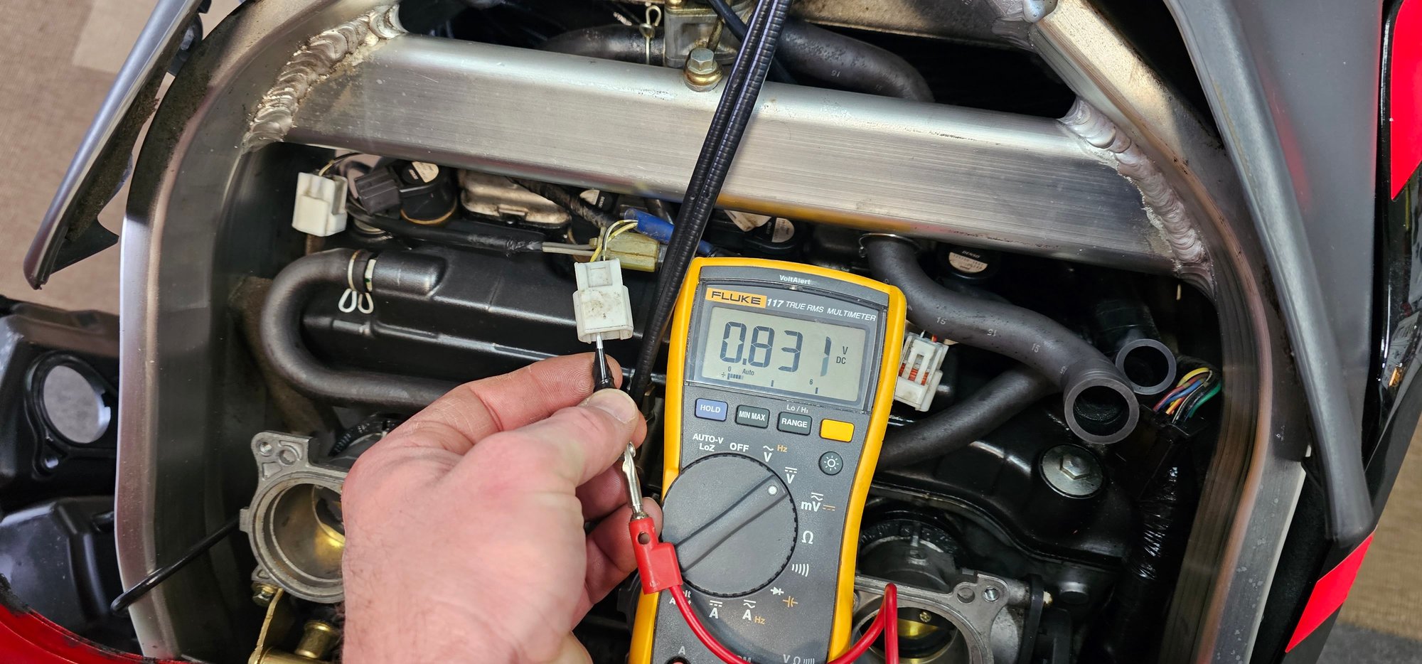

OK, great! So coils are getting proper power. This is shared power line with ECU as well. Might be slight short on one with 0.831v on trigger line

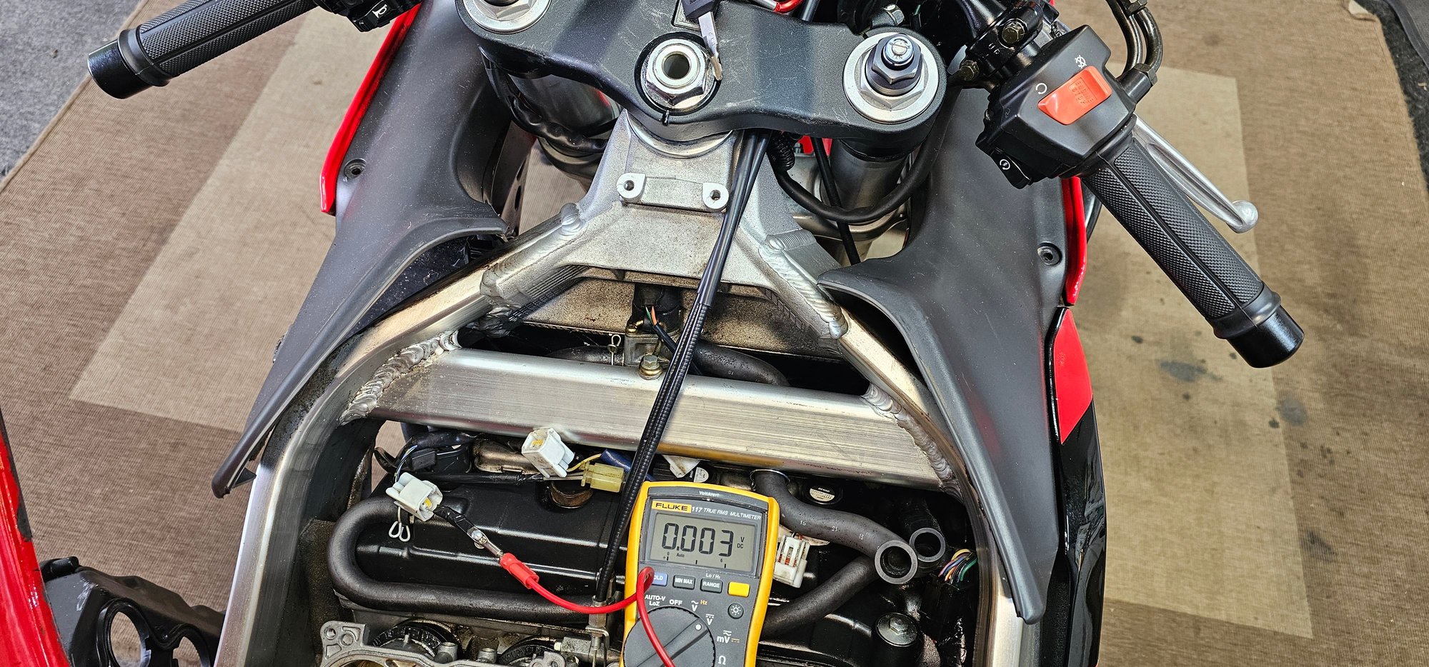

Alright let's see what's next...
that one came down to 0 volts. It was slowly coning down.
Old Apr 30, 2023 | 12:38 AM
  #35
dannoxyz's Avatar
Posts: 1,988
Likes: 439
From: Mesa, AZ
