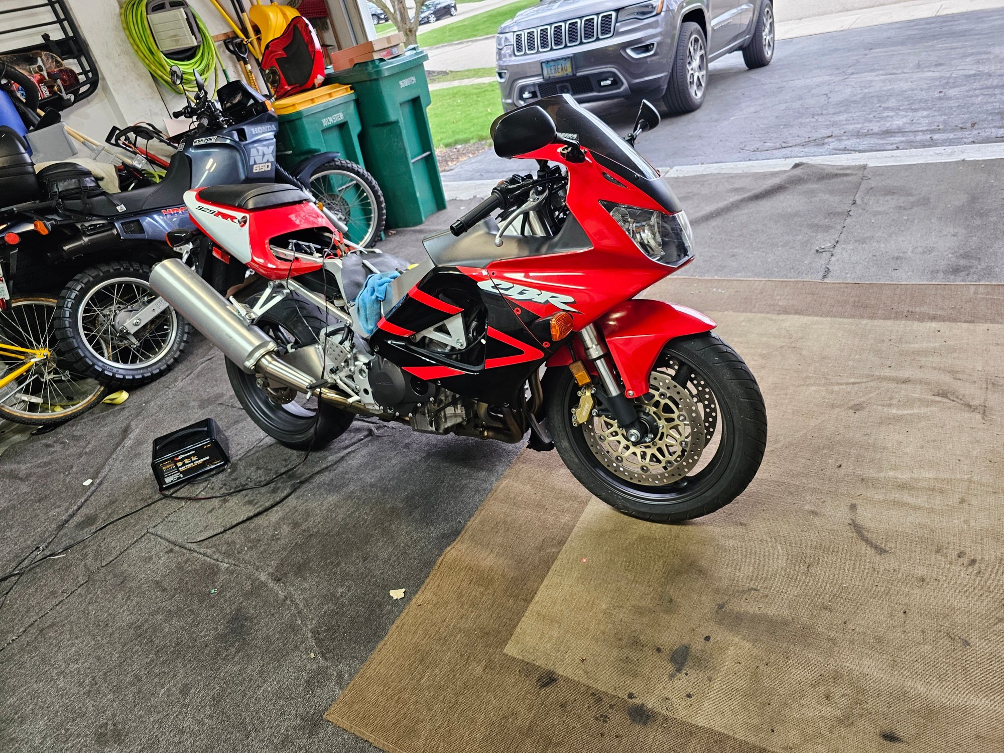

Hey guys, need help. So I picked up a bike from a buddy. 1 owner. 929rr 3600miles. Bike doesn't even have a mark, bug guts, rock chip, road grime anywhere. Its trully a mint condition museum piece. But... it wont run.
Short story. My buddy bought the bike from a dealer. Rode it once a year just outside town on old country road. Came home put it away. 8 yrs ago knee surgery gained weight, bike sat. Fuel tank full. Cover on it. In a "well built shed" attached to the back of his garage. Leaning against wall when he pulled it out.
I took my 6X12 utl trailer over. Loaded the bike up and brought it home.

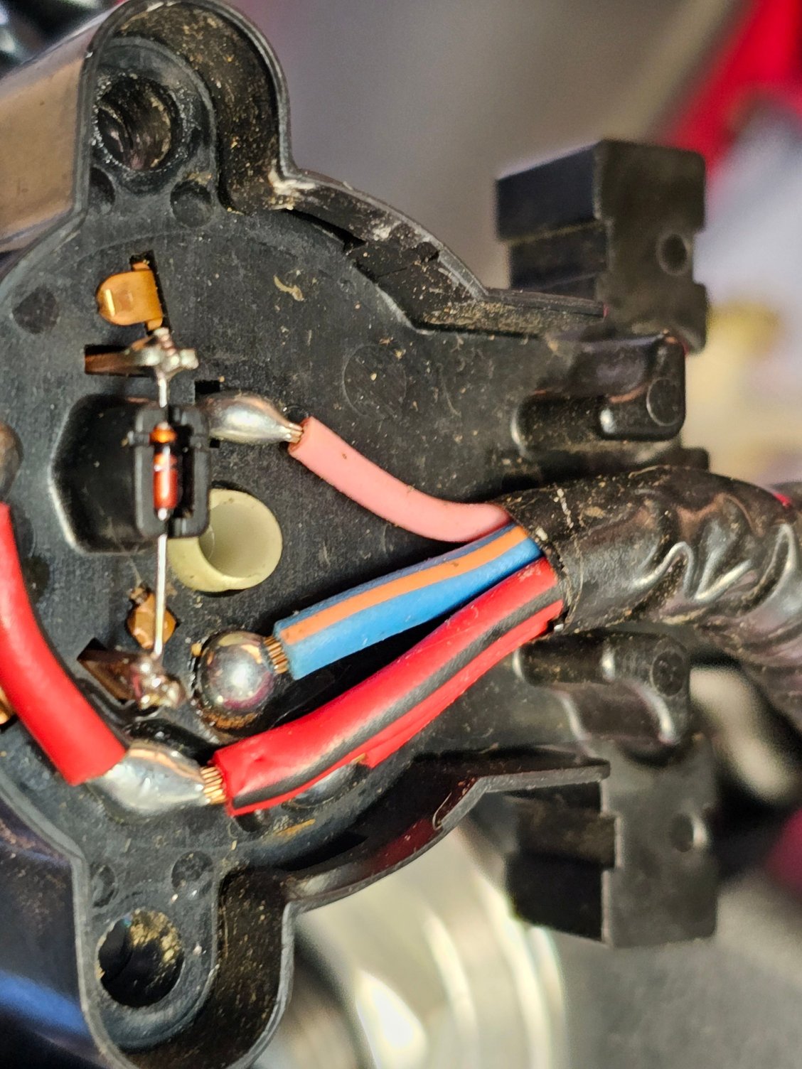

Took apart key switch to check ignition, pink wire resistor. Its good and dropping volts to 9.4 sending to ecm.

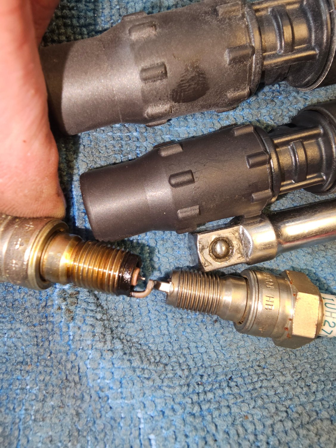

Checked coil connections,and then, Took out plugs, got new ones. It appeared to have burned old gas at some point. Very black,lots of soot and build up.definitely fowled.

So it's 9v now instead of 9.4v? What's pink-wire voltage at ECU connector itself?
I'm asking because picture obviously shows diode installed backwards and there's absolutely zero way it could be dropping any voltage at all. Unless laws of physics and electronics have changed just for this one bike.
Make those actual measurements #1-4 and we'll go from there based upon what real numbers are... This is 5-minute fix with multimeter, or less...
