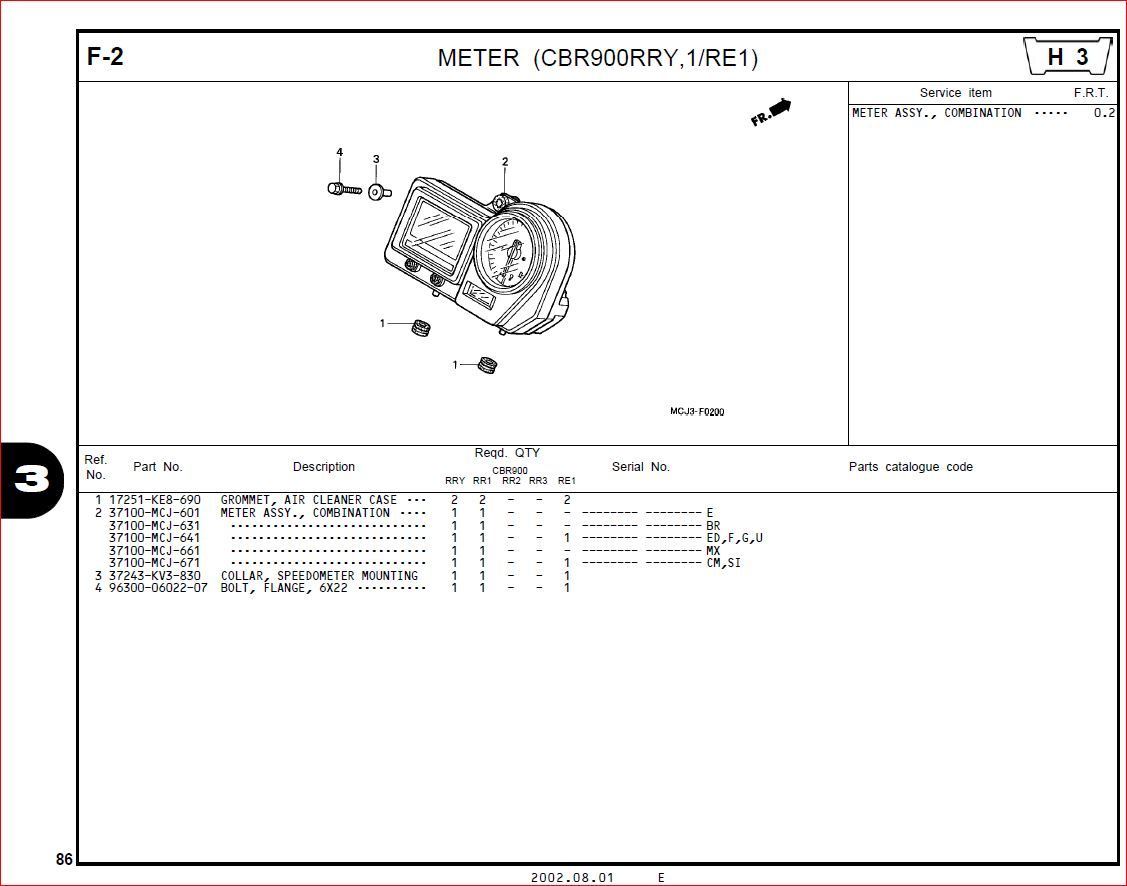

I'm not sure you can switch your meter from km/h to mph
According the parts list below, for England (E), it's a specific code, different for France, Germany...
For England, it's 37100MCJ601, you can check behind your meter what model you have
My bike is french, and I cannot switch different unit
