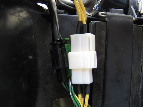

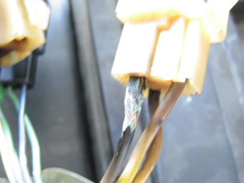

Hey Ghusar this is what my 3 yellow stator / reg wires looked like. They looked about the same on the reg/rec too. Didn't look bad at all going to the stator though.
This is after I did my thing on them with a new connector, heavier wire, heat shrink tubing and dielectric grease.

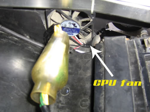

and I did this just because
