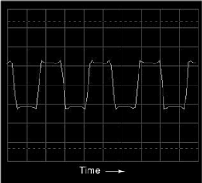

This is not some 1950's jalopy! Modern vehicles uses digital electronics, not old analogue stuff. Sensor probably works fine. You have to spin wheel so trigger-teeth moves past sensor. Then analyse output signal with oscilloscope. Looks something like this. More pulses per second = higher speeds displayed. Zero pulses from stationary wheel = 0 mph:
Most likely broken wire between sensor and dash. Measure resistance of each wire end-to-end to verify it's not broken.

So far I've only tested the 3 wires from the entry to the main loom under the tank through to the body of the sensor. Tiny amount of resistance as you'd expect over a few feet of wiring with a plug in there. Test light shows no drop or breakage. No pulse from signal coming from the sensor.
Oddly there's no resistance between the live and the signal wire, when stationary or on rotation. I always thought that Hall sensors have resistance across the live in and pulse out. Maybe I have a bad sensor as suspected, and the donor is a crapper too. I'm gonna rig it up on the oscillascope after work one day to see what's going on.
